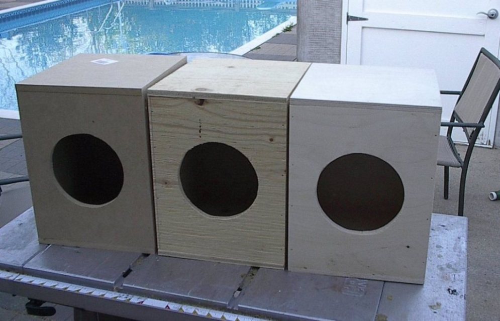

OK, since everyone says there is such a hugh difference in materials, here's what I will do:
I will build three boxes, of three different materials - one of MDF, one from baltic birch plywood, and the third from cheap spruce sheathing. I will construct each box from the same thickness material (1/2"). I will build each the same way - with glue and 1.5" airgun nails. They will be identical in every way. I will make one hole for a midbass driver that has a normal Xmas~5mm.
I will then test each box for panel resonance, using nearfield frequency response with the mic 1/2" from the largest panel.
There will be no damping material, the boxes will be empty sealed boxes.
Will assemble the MDF box and spruce sheating box tomorrow. Ready to test by next weekend.

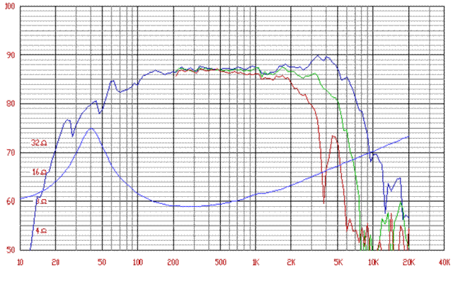

More on my materials test:
Finished the spruce box and MDF box on Thursday. Ran some preliminary test today with suprising results...
Will do the full scientific test procedure tomorrow and start posting the results.
One problem - I can't figure out how to copy the charts from Speaker Workshop to post as images. If anyone has any ideas, let me know.

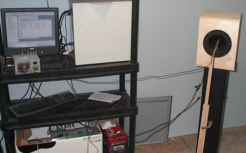

The test equipment: Speaker Workshop, Wallin jig with built in mic pre-amp (Eric Wallin design) plus LM3886 based power amp. Homemade mic (Panasonic capsule), homemade mic stand.
Running on a Celeron 1GHz with a SoundBlaster sound card. Only use for this computer is this purpose.

Claudio: spruce plywood for house construction - 4 plys, cheap and rough. Not particle board or chip board.
The box in the middle on the photo above.

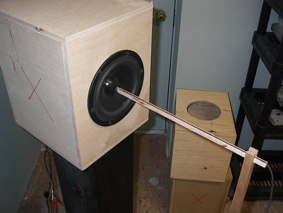

After much experimentation with different power levels, I settled on ~1 volt for these nearfield tests, which is quite loud in a small room BTW. Placing the test box on an old speaker cabinet, with a piece of carpet between the two. Position the mic ~ 1/2" from the cones dustcap, to get the drivers freq. response in each box.
The objective is to determine if the box material has an effect on the sound from the driver itself.

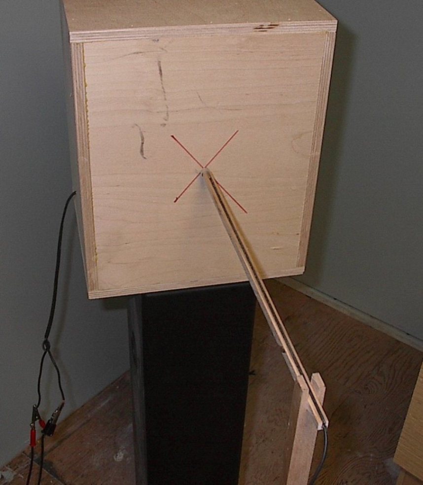

Next is the nearfield frequency response of the side panel. As shown in the pic, an "x" marks the exact centre. With the same settings on the amp and Speaker Workshop, I run the test.
I tried several different things during this test, such as putting a plywood shield to block some of the sound from the cone, but nothing had much of an effect. I even used a thick towel draped over the box, covering the driver. This made very little difference.
In the end, I just left the box as pictured, running the test 3 to 4 times to verify consistancy.
After all, it's the audible qualities of the box material in question. If the side panel test has some influence from the driver, that's not unlike the real world situation, where the listener will experience both combined.
