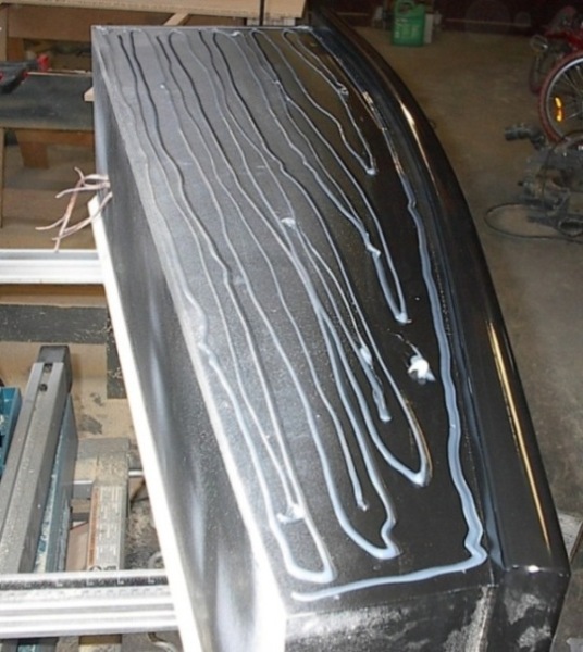

peufeu said:
I got this one through searching on "viscoelastic" in wikipedia :
http://quietsolution.com/html/quietglue.html
I have used GE clear silicone caulking for the glue in my CLD. It's a strong adhesive and it's resilient, providing a lossy layer between sheets.
Worked very well.

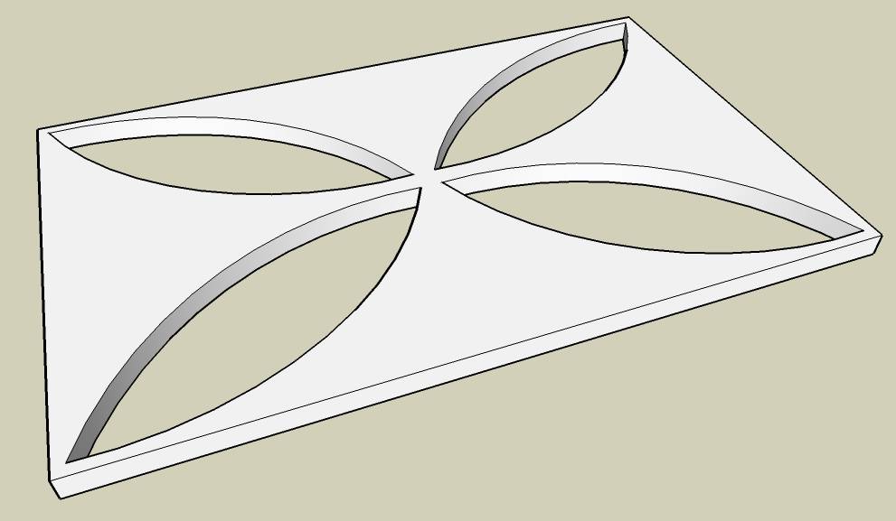

OK, first let me thank you for rephrasing your position. I think I have a better understanding now of what your concept. Your constuction anaology of a single post versus a bearing wall was, er, well, constructive! I now see that the "arches vs. triangles vs. rods" hasn't really been the real root of the discussion.
I think everyone can agree that more bracing is better, up to a practical point where acoustics are impinged upon. I believe that gedlee and I were trying to argue bang for the buck while you were arguing more is better, which was confusing things.
Drawing inspiration from your sketchup drawings, I would ask your comments on this bracing concept. It follows your "supporting wall" concept, but in my opinion will provide more effective panel restraint than concentrating the braing inthe corners. I will comment that I sketched this quickly, and have by no means "optimized" it. Just a concept for discusion purposes.

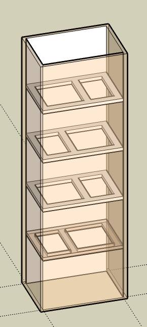

Also for discussion, I created an approximate sketch of how I braced a speaker cabinet I recently constructed.
One concept we haven't touched on yet is where does the point of diminished returns start to come into play. I think that is another one where gedlee and I weren't expressing ourselves wery well.
So the question I am asking is:
At what point does a further increase in cabinet bracing yield a negligible decrease in panel vibration?
Terry

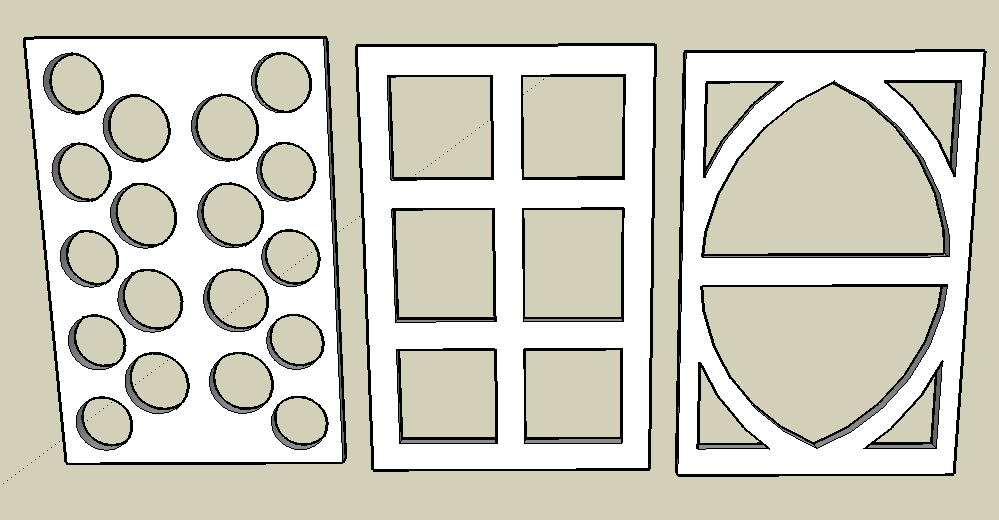

I like this one very much! It has the Gothic Maltese cross thing happening, so it get extra points for looking cool. :)
I whipped up a few quickly also, just for illustration. The one on the far right is my favourite.
