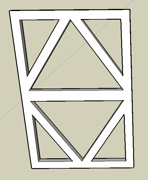

MJL21193 said:Thank you, although something is still not clear. I'm not saying there should be more bracing , I'm saying the bracing can be more effective. That's the real difference between the full panel and the pole - effectiveness.

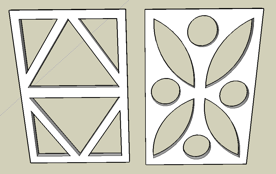

I like this one very much! It has the Gothic Maltese cross thing happening, so it get extra points for looking cool. 🙂
I whipped up a few quickly also, just for illustration. The one on the far right is my favourite.
Thanks for the "cool factor" vote. I hadn't intentionally done that, but sometimes form follows function nicely.
Also, I don't think we are as far apart as you might think, as I would agree that your "far right" drawing would indeed be a very effective brace, and illustrates the points I was not so clearly making.
In my drawing of the bracing for the speaker cabinet I recently built, if I hadn't used 1" baltic birch plywood for the 7" wide front and rear panels, I would have used a brace more like the one you have drawn. An interesting note about the bracing scheme I did use, is that the cross panel posts are not centered but are positioned at 0.618x cabinet depth, and are alternating in orientation with vertical position. This creates a very minor but measureable difference in the resonance spectrum of the cabinet: the number of resonant frequencies is increased, but the instensity of each spectrum peak is reduced, and each peak is broadened across a larger frequency range. I know, this is "Golden Ratio" hocus pocus, but it did create a beneficial effect without increasing the effort or materials required to produce it.

Hi Terry,
I took liberties with your brace and hacked a few holes to make it more "airy" and "transparent". Hope you don't mind.
The first one is redone on Sheldon's very "sound" advise: to straighten the curved pieces. This would be a great brace for a mid-sized box, where the other would provide brute strength for a sub enclosure - a man of a brace. 🙂

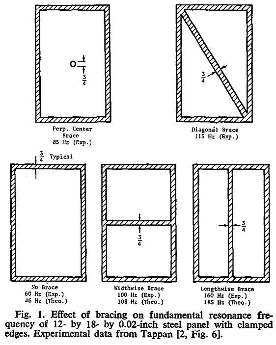

I found the original article* that informed my choice of brace orientation... Terry has already validated that the sides are inherently well braced.
1st lets look at what makes one brace better than another brace -- it need not be the same kind of goals that will keep a bridge or building from collapsing.
This is my reasoning:
0/ there is no such thing as a panel that doesn't resonate (and when a panel resonates it becomes largely transparent)
1/ if we place the resonances such that they are unlikely to be excited then it is almost as if they are not there.
2/ the energy available to excite a resonance is inversely proportional to the square of the frequency
so, a brace is better if it pushes the panel resonant frequency up higher
The picture now becomes pretty much self-explanatory. The diagonal is most effective, but in the case of the example i posted this would not allow the use of a single brace to deal with 4 panels (and a perpendicular brace is easier to build). Based on this data Earl's point braces are the least effective.
To get a very rough metric that shows the effect of frequency, if we take the experimental numbers (actual panel resonances will differ based on initial panel shape/proportions, and material) and calculate energy available to excite the resonance (freq(unbraced)/freq(braced))^2, set unbraced to 100%, the single centrally placed point brace would be 50%, a horizontal brace 36% and the vertical brace 14%.
*(JAES April 1973, V21#3, The Theory of Loudspeaker Cabinet Resonance, James K Iverson)
dave
gedlee said:The outside ribs won't do much since they are along the walls and as Terry (and I) both point out stiffing the walls with ribs doesn't do a lot
The ribs will increase the stiffness of the panel, which pushes its resonance up ... if that didn't happen the T-brace (as we see in a roof, a wall or a floor) wouldn't be very effective.
