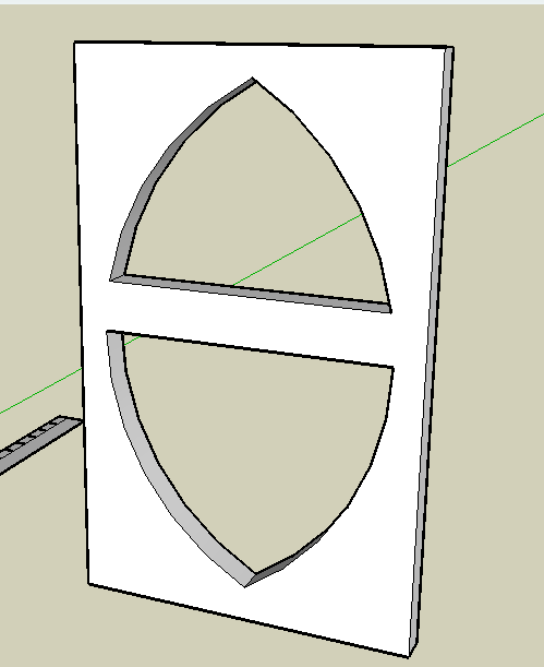

gedlee said:In other words you have braced the wrong dimension and left the critical one fairly unsupported.
I would have to disagree with you. A brace works best if it divides a panel into sub-panels that have a higher aspect ratio than the panel it is bracing. As configured it does just that, and braces the 4 panels that do not have bracing. The side panels are inherently self-braced. This is structurally a multiple H beam kinda structure.In practise the sides do not move.
dave
dave
Have you tested this, or is it just hypothesis? That structure has good strength from front to back owing to the sandwich, but from top to bottom. it will flex readily (think corrugated cardboard)
Another brace, horizontal across the middle would help this.
dave
Structural engineering is somewhat of a specialty of mine, but if your convinced of your position there is no more to be said.

MJL21193 said:Another brace, horizontal across the middle would help this.
Horizontal across the middle wouldn't much help the mode you are suggesting might be there, it would need to be vertical, and that would create an early surface for things to reflect off back thru the cone.
dave
dave
The vertical bisecting the side panels would provide the most strength, but you mention reflection and that's what I thought of also. The horizontal will be nearly as effective, as it will also bisect the side panel.
Another possibility would be a "strongback"(construction term), a solid hardwood cleat or rib that runs from top to bottom, middle of the panel. Not as good as the full brace, but better than leaving it alone.
So, when should I start building?
dave
The brace can be made to be effectively insignificant in that regard. If a designer uses a brace that does have an impact, it's a faulty design.
Dave

gedlee said:
Putting a fairly rigid bar between two panels - through the middle - will be extremely effective
I have to respectfully disagree. The rod approach just joins the two surfaces together so they resonate together. It does nothing to minimize the resonance. To do this you need to triangle brace with a rod from the cetre of one panel to the centre of the adjacent.
Easier way is to us a full panel bisecting the space down the middle, from side to side which will brace all sides.
A brace like this would go a long way:
You've overlooked one important aspect. Opposing panels are in generally vibrating such that the panels are moving in the opposite direction at any given point in time when unbraced. It's like a balloon that is expanding and contracting with the driver supplying the air pressure variations. Tie the centers of the opposing panels together with a stiff rod and they will no longer move due to a driver signal at what was the peak movement point, the center.
There's not going to be much in the way of random or uncorrelated vibrations of opposing panels. Even those would be reduced because any one panel that would move has to move both simultaneously since they are coupled with the rod.
Dave
Dave
You are only looking at the sound pressure, not the mechanical from the driver itself.
The full panel brace will outperform the rod. No question.
