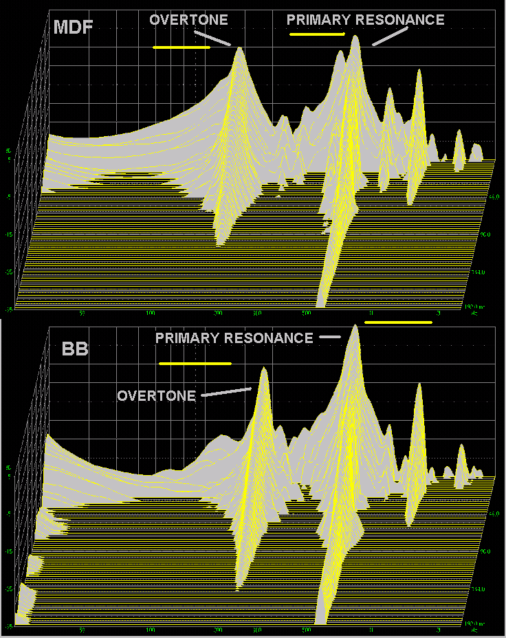

Art Ludwig's experiments.........
I didn't see his work posted, so........
http://www.silcom.com/~aludwig/Loudspeaker_construction.html#Creating_a_sound_sponge

Re: Art Ludwig's experiments.........
Interesting page, I've never been through his entire site, thanks for the link.
One aspect of his testing that is lacking is that there will be two different vibrational mechanisms. One is covered in his test, the other is not. The one covered is the impact of air volume energy that will be any energy imparted to the air from the driver's rear side. The one not covered is the energy imparted into the front baffle by the direct contact of the driver mounting. Since most systems will have at a minimum either damping placed on the walls (ported) or fully stuffed (closed box), the impact of the two different mechanisms is also different.
The airborne energy can be largely damped with the resonances whose fundamental is related to the box dimensions being the major concern. I suspect that part of the reason that Ludwig was surprised at the energy measured at the corners was due to undamped airborne energy largely passing through the panel. This is energy simply passing through. It's the type of path that is why low bass passes so easily through walls in the home whereas higher frequencies are damped more easily. It's mostly normal to the walls in both. Much if not most of it is not the walls vibrating, the walls (and baffles) are simply somewhat transparent to energy transfer this way.
Of course, if the internal fundamental resonances related to the dimensions of the box also coincide with the unbraced dimensions for the panels, those panels may exacerbate those frequencies by resonating as well.
The part 2 of this is the energy imparted to a baffle by an attached driver. The origin of this is not one of energy passing through (a very large surface area for that case), it is much like a driver diaphragm. It's initially a transverse wave that is damped as the wave travels from driver to edge. The internal damping properties are probably of much more importance here. However, since the panel is so much stiffer than a diaphragm, there won't be much movement, so the spectrum will be a lot different for this. It is very much a bending wave condition. The stiffer the material, the less movement. Energizing a flat, uncut baffle with a rod connected to the panel would probably be the best way to test this, that would be interesting to see.
A third consideration, one I consider significant at least, is that when I'm listening to my speakers, I have the front baffle facing me with a small toe-out, so I see the inside facing side baffle at a high angle. This, being somewhat typical, means that the only significant baffle affecting the first arrival is the front baffle. The bottom (facing the floor, lots of change there), the sides, the top and the rear are all not having any impact on the first arrival. The result is that almost all of the output of these enter into perception as only reverberant room energy. This, to me, is the reason why I see far less importance in the material and the box. The room environment is much more of an influence and in fact, given that it can be altered for reflection/absorption so much that both a dead box and a lively box could possibly be made to sound very close in character if the room acoustics are adjusted for each one as long as the front baffle is constructed well. But compare two different boxes in the same room with no room change and the character should be different, how much will depend on the room's influence to begin with.
The primary issue as I see it is a heavy and/or well-braced front baffle with solid driver mounting. Of course, many will disagree, this is my reasoning. I'm in gedlee's camp on this one, the enclosure is grossly overrated.

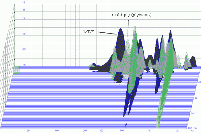

You can say that, yet with no data to support your position. You then go on to use data that contradicts your point to support it.
I have reposted that specific composite chart -- MDF vrs multi-ply from the Dutch site i linked above.
MDF has a large resonance @ ~250 Hz, ply a much lower & quicker decaying pair just either side. They both have a resonance at ~500 Hz with about the same initial magnitude, but the ply dissappears much quicker and with a quicker slope -- one will note that the MDF resonance pokes its head above the surface near the maximum time extent... it has a long shallow ridge of energy. Next 3, the magnitude of the ply is less and disappears quicker, then one unique to the MDF. Then another where they start about the same but the ply goes beneath the surface in about half the time. Then the one just above 1 k, ply starts lower but the MDF is quicker to below the surface, but the slopes are similar. This is where we have to note that the data Svante supplied indicates that the energy available to excite these resonances is inversly proportional to the frequency, so the most significant resonaces are the lower ones.
So not only does this say that ply is less resonant (and in particular when you factor in where it counts), but it is better damped,
It should be noted that both the Dutch site, & Ludwig's* work point to the best performance from more complex panels than just "naked" MDF or ply.
*(As dlr pointed out, Ludwig's work does not address the most significant source of energy available to excite resonances -- structure borne.)

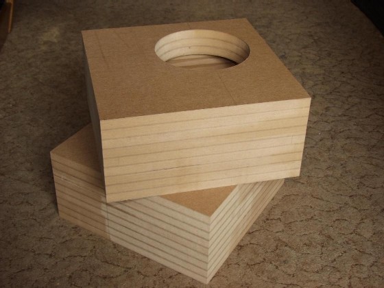

planet10 said:
As to the 3x18mm box, i'd be willing to tackle a better sounding box, but i'd need to know more about how you executed your build.
this is how I did it - the front and back is about 50 mm
the side walls are just 25 mm thick
I have reposted that specific composite chart -- MDF vrs multi-ply from the german site i linked above.
That composite chart you made is not correct. Either look at the ones on the actual site again, or take a look at the ones below, which I copied direct from there and present here unaltered (except for the labels I added).
It can be clearly seen that the materials are virtually identical, with nearly the same resonance and the same decay. Any difference that you can pick out from these charts is not audible. Not at all, by any human.
You say there is so much we can't measure. What we can't accurately measure is the brains ability to deceive, especially where hearing and strong convictions are involved.

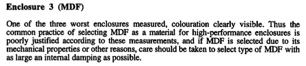

Not the paper i was looking for, but makes me smile (Note: he wasn't very complimentary of any materials used "naked" -- i can only console myself in that my use of plywood is part of a carefully conceived construction that makes its properties work to my advantage, ie a lot of care is taken in the execution)
101 AES Convention Juha Backman
dave

I was talking about the loudspeaker manufacturing industry. Just as been expressed in just the last few posts, they like it because it is cheap, & cheap to finish.
dave
I'm not going to get into the "informing rookies" thing. Browbeating is more like it.
This paper you found is conclusive evidence? The Dutch site you linked for the measurements was proof enough, no?

MJL21193 said:That composite chart you made is not correct. Either look at the ones on the actual site again
I went back & double checked... the composite chart is correct. I would never use any of these materials without bracing, the chart is image 9 & 10, modestly braced MDF vrs modestly braced birch ply (both 18mm). Execution is important.
As has been pointed out, you are going to have big "oil can" resonance issues with that baffle.
Much better to use a thin baffle (Al is good), and brace things up.
dave
dave
