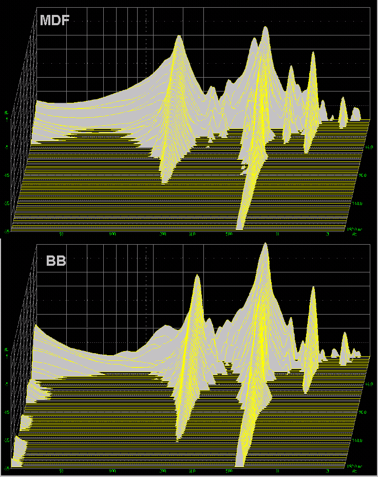

Do you have those figures - the resonant frequency of MDF and Baltic birch plywood? How far apart are they?
Yes i do.
Depends on the panel length/width.
Depends on T. and the energy involved
Its dependant on the above.

Equal size panels, equal conditions, test results! Figures? How much of a difference is there between MDF and BB?
planet10 said:
Both Dave. That link? What is it about? Too long for me to read.
MJL21193 said:Equal size panels, equal conditions, test results! Figures? How much of a difference is there between MDF and BB?
Pretty much the composite CSD i showed -- MDF ~ 1/2 the multiply.

I wonder whether differences in MDF differ significantly or not. MDF seem to range from densities of 500+through 700+ (can't remember whether the units were metric or what). Also we don't know how strictly the term MDF is used in different countries.MJL21193 said:
dave
Sorry, but I studied the CSD's from the site you linked, but I'm not seeing the "1/2" figure you've arrived at. I don't speak Dutch, and I'm having a problem pinning down which of the plots are for 18mm BB, but I think it's "berkenmultiplex"? (I found "spaanderplaat" - this is particleboard) If that's the case, this reinforces my test results showing the resonance is approximately equal (~500Hz), but the BB is more than 5db "louder" than the MDF.

MJL21193 said:Sorry, but I studied the CSD's from the site you linked, but I'm not seeing the "1/2" figure you've arrived at.
It is in the composite i posted (#228) ... the big blue/black peak is at about 1/2 the frequency of the big green/grey peak, but i guess you missed that.
dave
dave
You mean this?
MJL21193 said:The peak you call the R freq is an overtone. They have nearly the same resonant freq.
An overtone won't be bigger than the primamry resonance.
dave
So now I wonder on that site with the tests, what kind of MDF was used. I have seen some different densities, and the lower density ones seem to have much more damping.planet10 said:
