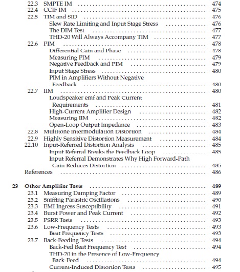

Ref. meaningful and implementable audio measurements, I humbly suggest chapters 22,23 from Bob Cordell book.
George
Once you stop the nose bleeding…😀
