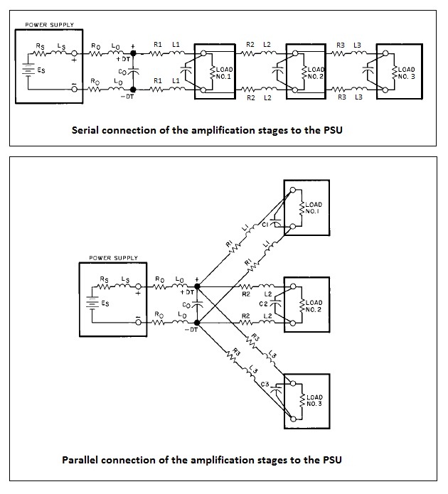

Some of us like to also confine currents to loops as local to a given circuit section as possible
This is very important Brad, thank you.
If all amplification stages are connected in series (think board level) to the PSU, local RC decoupling alone, does not.
Parallel connection to the PSU plus local decoupling does.
Ah, now I see bear. I overlooked your true nature
George
Since you cvan't have all your loads directly at the psu (unless you give each stage its own psu) a good way is to determine the stage with lowest PSRR and put the psu closest to that. And, if you're serious, use remote sensing for the regulator at that stage.

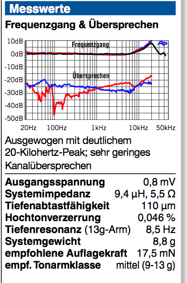

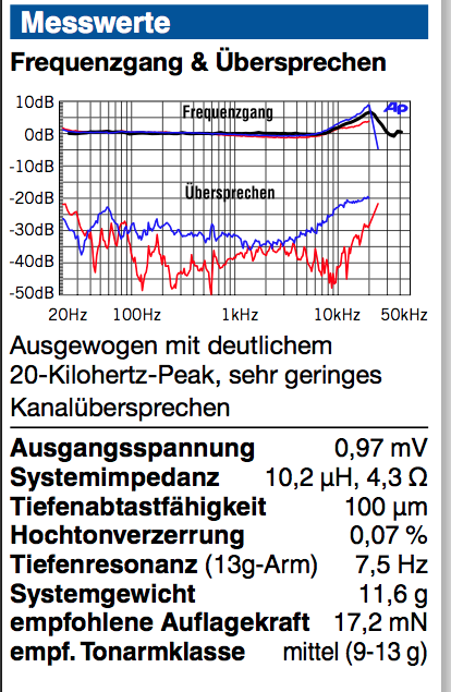

Here is a comparison of measurements. One is the Kleos that has both coils wound on the same square former in 90° and the Atlas that has a cross with 4 arms. 2 coils for each channel.
The improvement in crosstalk is obvious. Still this would be very poor for an amp. Yes, i know, Vinyl has no right to sound as good as it does.

This cartridges are voiced with a special STAX headphone with extremely low mass.
Mostly critical choir music. There is a cutting and plating loss in the treble and measured more towards the inner side of the grove there is around 3dB loss in the treble too.
I can only tell you that they do not sound spitty at all and yes, extended overtone spectrum differentiates vinyl from CD also i know that vinyl is not very accurate over 10kHz. It may be the simple PRESSENCE of overtones and not the EXACT amount.
