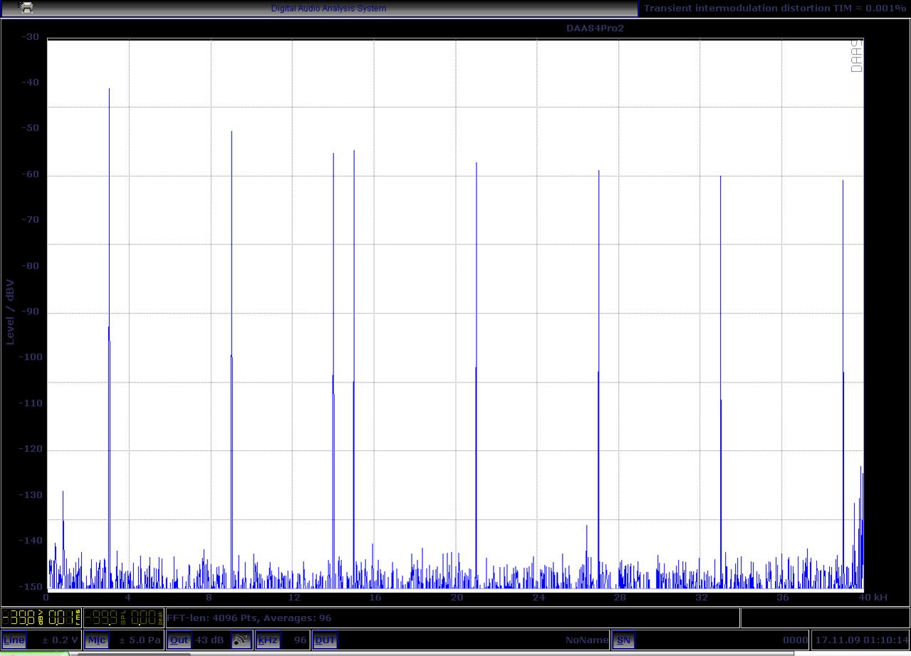

Here are the dynamic measurements i did on an INA i constructed with 2 AD797 and 1 LT1648 for MC cartridge head amp purpose.
Watch the scale, the resolution limit is at -150dB. This is done by gain ranging two 24Bit AD/DA converters. The measurement are pretty astounding and the sound i got was very good. I can do better though subjectively with designs that measure still very good but not as well.

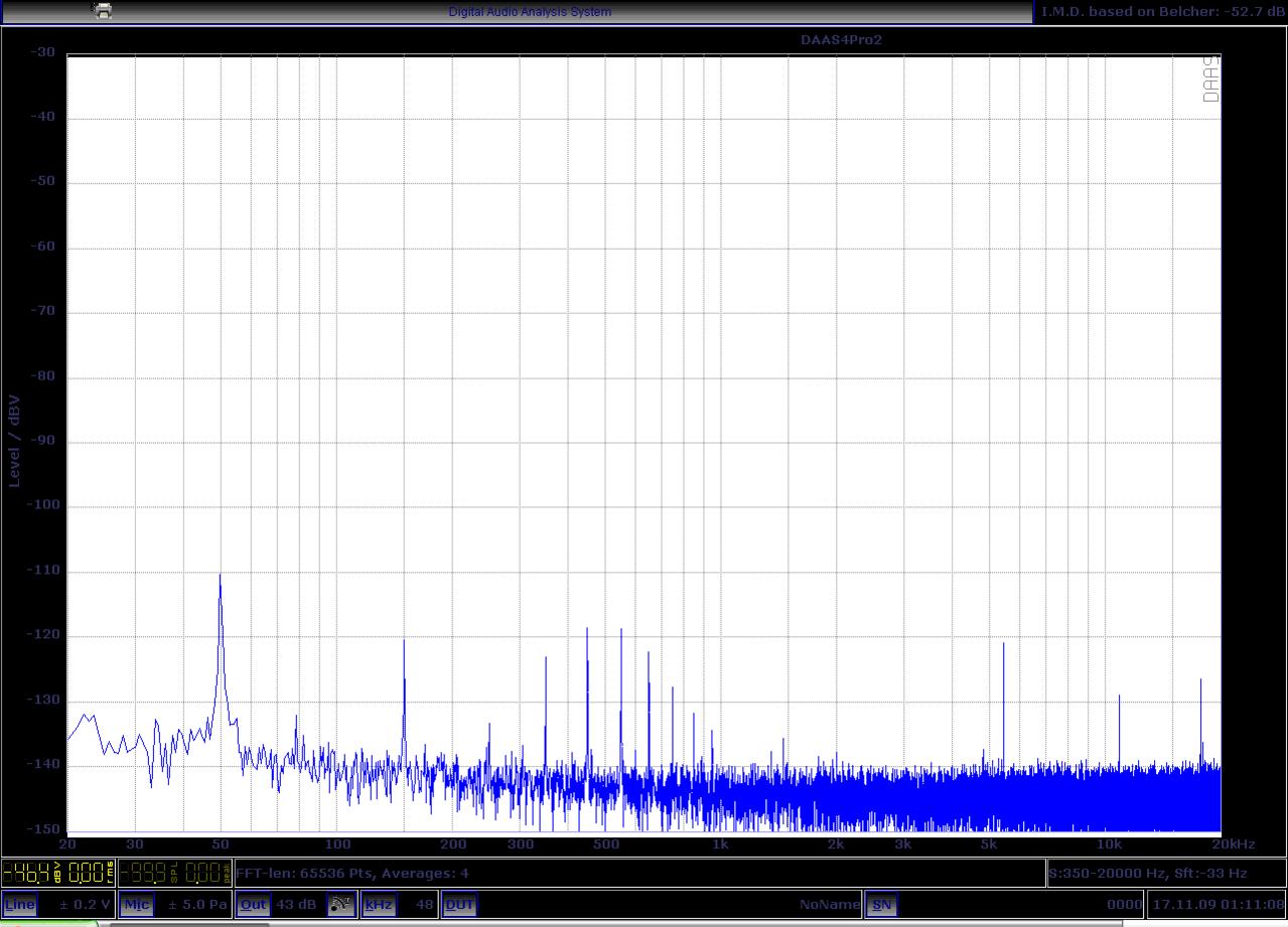

Here is one more. I even called it "Gold standard" because it measured so well.

What does this measurement show?

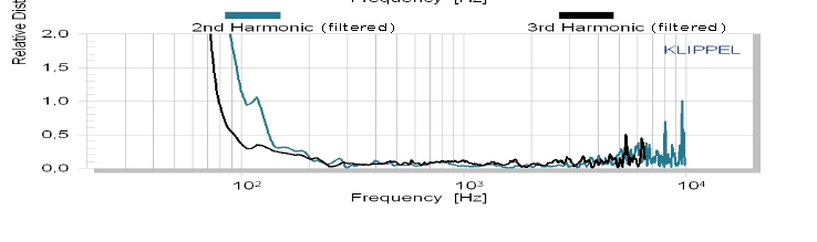

very nice results --- Do you have data on other speakers/drivers that are as good? Such as, one of my favorites I drag out every so often -- The New Quad electrostatic speakers? I understand they re very low distortion full range speakers. My reference speakers for very low distortion and very flat response.Here is the distortion measured at 1 Pascal on the midrange of my private speaker.
Between 200Hz and 5KHz it is under 0.1%, better then many tube amps.

George, the measurements are explained in post 1099. From left to right, top to bottom :
Noise test, Belcher Test, Sine-square superposition.
No, i do not know any dynamic speaker that has such low distortion at such high volume.
Yes, the Quads have very low distortion but mecahnics are a crook and they do not play much louder then 100dB. When you strip them and make a really rigid frame they are cool up to a certain volume. You will be also be surprised about the compromised parts they use. For example there is an input cap before the transformer that has to substituted, and then the terible clamp overload supression. Nevertheless a stroke of genius.
Horn speakers can have low third but they still have high second.

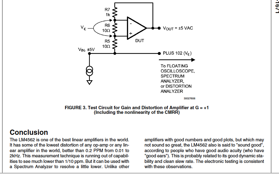

Here is an astounding claim from National Semi. I would call that settling time. What happens after an aprupt transient ? How long does the opamp need to pull the output to zero ?
And you thought that kind of advertizing was only done in high end audio 🙂
Sigh. It seems each generation must learn anew.
