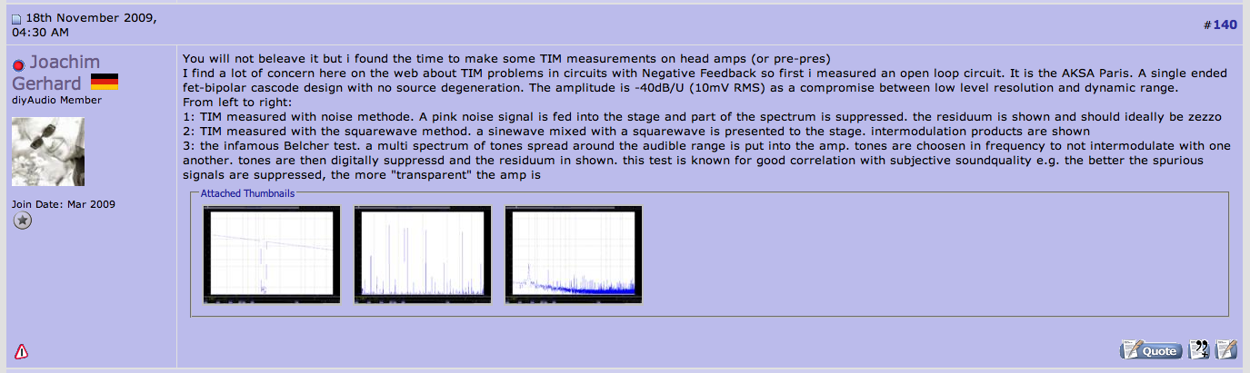

The fundamental problem to me is that no-one has agreed on an actual, specific design goal. Vague target means that the conversation wanders all over the place and nothing definitive will ever come out of it.
I use dynamic measurements with very high resolution all the time. I had a lot of hope to find a correlation to audible quality. Curious enough the designs that had very low harmonic distortion measured the conventional way with single tone up to 10kHz also scored best on the dynamic tests. For example an AD797 scores great with gain up to x10 challenging my equipment. Can i build a better sounding line stage with gain of x10 compared to an AD797 with the same gain ? You bet, but why ? Added distortion that makes the sound "fuller" or more "natural" ? I do not think so, i can not hear better then -60dB, low order, and my line stage is much better at around -100dB THD.
See an old post from 2009 on my MPP thread. That was the time i measured much but i have given up.
And how do you fit 20,000 different tones into the audible bandwidth and still be able to see any harmonics
Harmonics will not be seen. The idea is that noise will increase. But how this
noise will be measured in the presense of such a big population of main tones?
But new relevant methods are already proposed 😉 :
When the number of tones increases, the distortion
products gradually merge into a continuum and
approach the result obtained with noise. Beyond a
certain density of tones the distortion spectrum of
multitone and noise are almost identical
With this technique we can use any complex test
signal such as music or speech at realistic levels and
measure the non-coherent distortion. Ultimately, is
this not what everyone wants to do?!
http://www.listeninc.com/PDFs/paper_121AES_non_coherent_distortion_Listen_Inc.pdf
