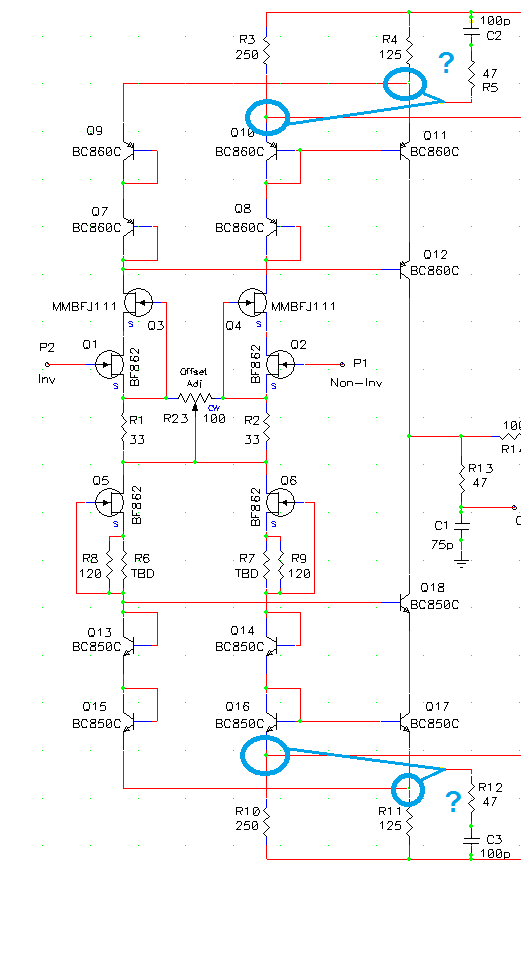

Is There An Error in Post 1568 Schematic?

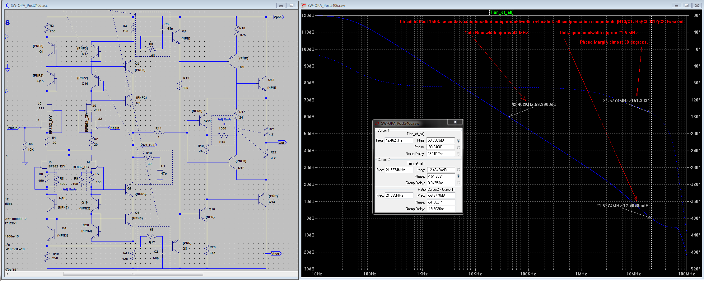

I have been running LTSpice on the the topology shown in Post 1568. (Which I believe is the latest version.)
From looking at the circuit's gain-phase plots I think there may be a drafting error in the diagram posted at #1568. The secondary compensation pole-zero networks may be connected to the wrong sides of the differential input stages. See atch image "Post1568_Possible_Error.png".
I have also attached simulation result screen shots (and the native LTSpice files that generated them) showing the behavior of the Post 1568 circuit as-drawn. In particular, look at the unstable phase margin (MINUS 12 degrees) at the unity gain frequency.
Following posts will show results for modified versions of Post 1568. If the Post 1568 circuit topology should be modified to improve performance, I'd like to know because I'm laying out a PWB and don't have enough acreage to allow for compensation networks in BOTH locations!
Dale

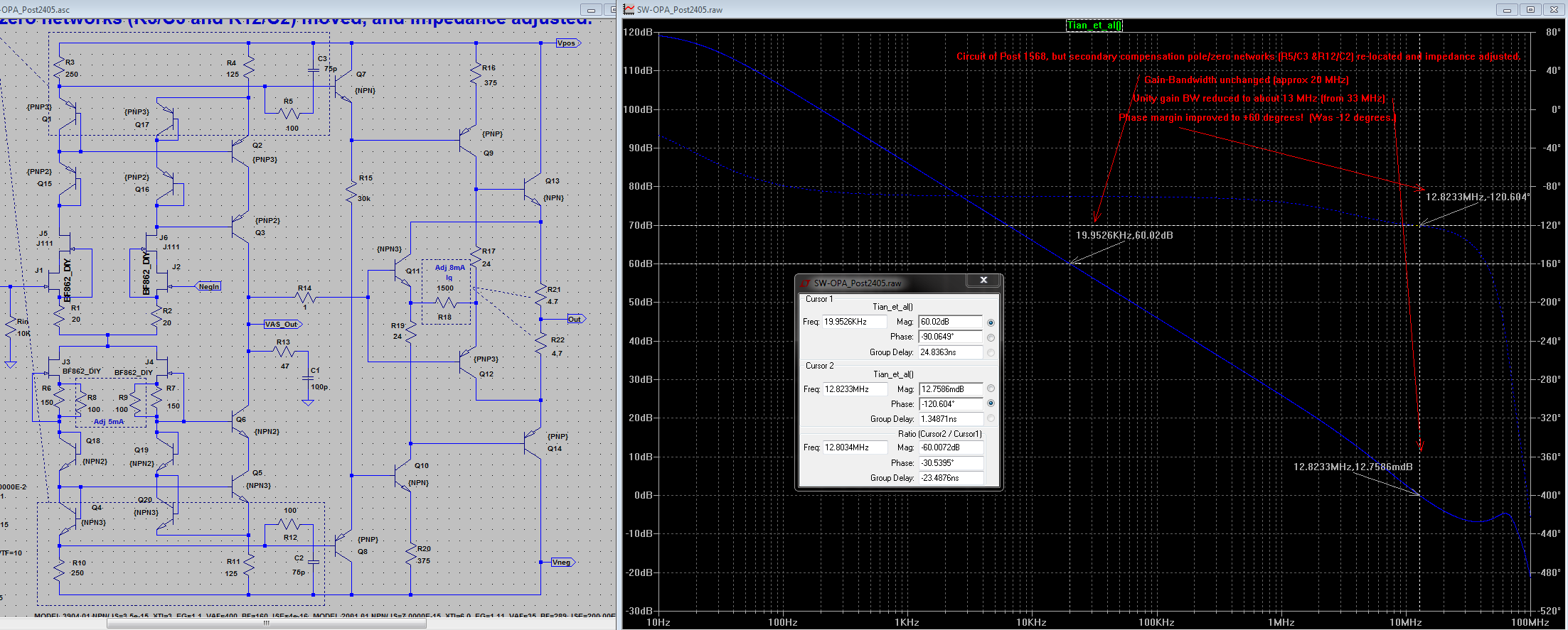

Corrected (??) Circuit from Post #1568
Here's how the performance improves when the compensation networks are placed on the other side of the input differential amps, and values adjusted for the higher values of emitter resistor. The low frequency gain-bandwidth isn't affected, but the unity gain phase margin improves considerably to PLUS 60 degrees. (The unity gain frequency decreases from around 33 MHz to about 13 MHz.)
Dale

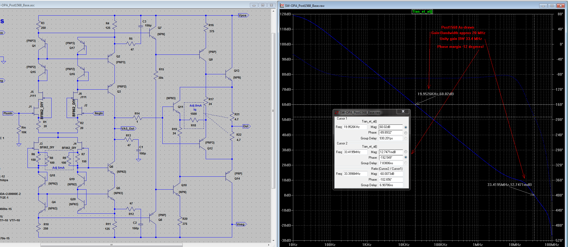

Tweaking Modified Compensation Scheme from Post 1568
And here is an example of what may be feasible with this circuit. It actually looks like a low-frequency gain-bandwidth of 50 MHz or more (with unity gain phase margin on the order of 30 degrees) might be practical without resorting to heroic efforts of selecting components, customizing each unit with the aid of a network analyzer, etc. (We started with an RF JFET, after all!)
By the way, I used the BC550/BC560 models from Bob Cordell for all of the BJT's in this sequence of simulations. I am quite aware that other models, and different component values, will give differences in specific result values - my major concern is determining where the compensation networks should be placed so I can proceed with the PWB layout.
Dale

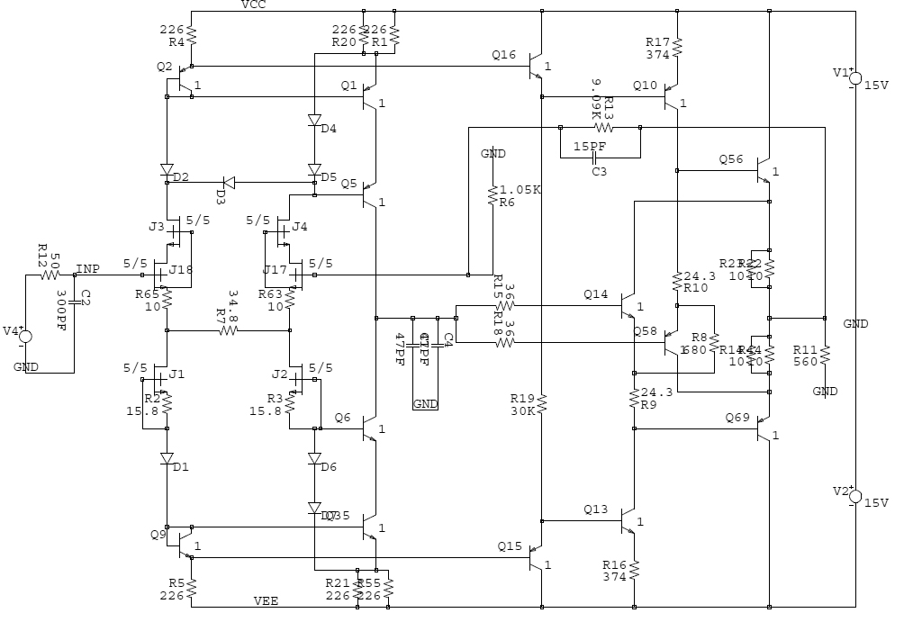

To summarize these are the values that ended up in my breadboard. I am showing them just to be exact there is certainly some latitude possible without changing much. The FET’s are 2SK170 cascoded by J310’s, the bipolar are all 2N4401/4403’s, the diodes 1N4148, bias set at 25mA total. I measured AOL and THD at 10Hz, 1KHz, and 20KHz. Everything looks good, damping the input and adding the 15pF made everything behave. The AOL at 10Hz was 400K and at frequency was right on simulation same for the third harmonics, everything above the thirds far down. Vos was 7mV (simulation of all perfectly matched devices was 3.8mV) with NO matching of any devices. This made for a slight increase of seconds over the sims, I’m sure matched devices and an offset trim would fix this. Yes these were all single devices pulled at random out of the bag.

Scott: Thanks so much! On your updated schematic, the two compensation capacitors in the center of the drawing (one 47pf to ground, the other value is blurred) Thanks, Ray😀

Yes, I just grabbed two 47pF instead of 100pF no OCD behavior allowed 🙂.another 47pf
Thanks for this, Scott.... The FET’s are 2SK170 cascoded by J310’s ...
What current are you running in the i/p devices? It's not clear what J1 & J2 are?
Did you go for 2 x 5mA as on the previous versions?
