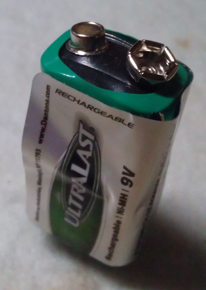

This has been a real Three Stooges weekend. On Saturday I took a couple 9V NI-MH batteries out of one of my test bench pre-amps and put them in my pocket and walked over to where I keep the charger. As these things go the batteries did a face to face meeting and by the time I got to my office I said, “what’s burning?” My first thought was that if the sprinklers get triggered everything is toast. Then I saw the smoke coming out of my pocket and pulled them out just before meltdown.

It's also been forensic electronics for me the last few days, working on manifold problems with a digital touchscreen watch not of my design. But after writing up a summary and transmitting it this morning, it was off to Disney Hall to hear Mozart, Hindemith, and Dvorak. Good music, great band as usual, wonderful hall, but frankly, a rather uninspired conducting job from Zubin Mehta.This has been a real Three Stooges weekend. On Saturday I took a couple 9V NI-MH batteries out of one of my test bench pre-amps and put them in my pocket and walked over to where I keep the charger. As these things go the batteries did a face to face meeting and by the time I got to my office I said, “what’s burning?” My first thought was that if the sprinklers get triggered everything is toast. Then I saw the smoke coming out of my pocket and pulled them out just before meltdown.
