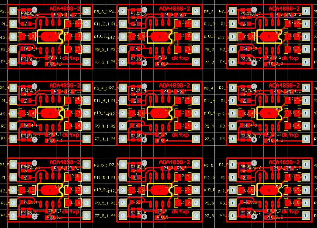

My pain threshold is currently a dozen ADA4898 duals stamps in parallel.
That style of etched subcircuits is quite handy btw, I have designed a nice library
of modules that makes short development of prototypes.

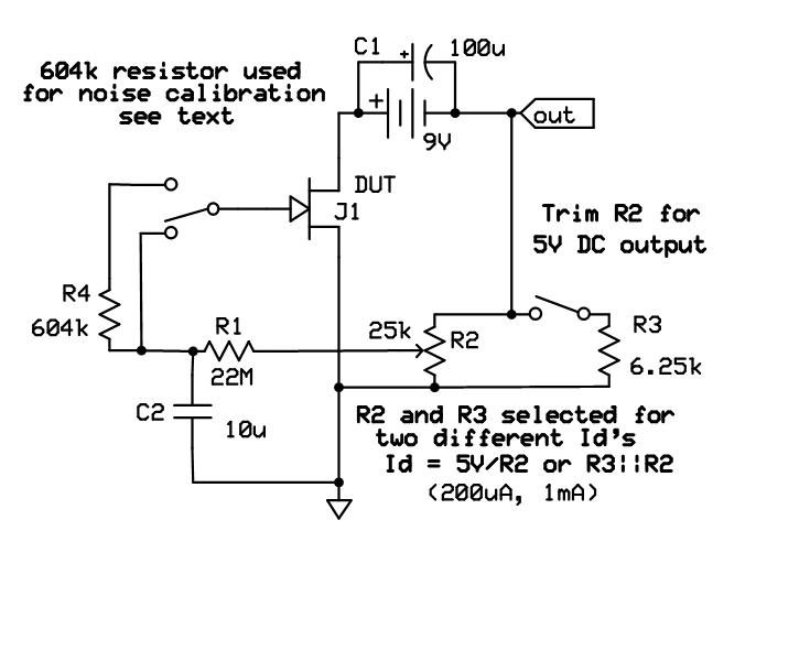

OK, I don't think Jan would mind. The 604K resistor makes a 100nV/rt-Hz reference at the input this allows calibration without regard to bin width or windowing so even the most primitive FFT software should be usable. Just average lots of noise with the resistor switched in and make that reference line 40dB then short it and get the noise of the FET alone, 0dB equals 1nV.
This is all I used for those plots in the Pass forum.
