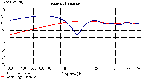

Does your circular baffle caveat hold true only if the driver(s) are centred on it?And here are Edge simulations about what effect the baffle makes to the same 170mm driver. Arrows indicate points of baffle effect treshold, dipole peak and dipole null.
My point is - any kind of acoustical baffle does these changes! This is because sound wave's path length to the edge of the baffle is what counts.
A wool felt sheet is just a little "weak" in this respect, it is virtually smaller than it's measured size. Likewise a thick baffle is virtually wider than it measures. "Wings or H edges add path length and break symmetry. A circular baffle is "worst case" because path lentgh is constant to the edge. A baffle with straight or oglique edges makes variations to path length - distributes and smooths out dipole peak and null. Wool felt makes paths a bit longer an diffuse too.
It seems to me an off centred driver on a circular baffle wouldn't have any common length sound paths to its baffle edge.

Here is a Edge simulation, 200mm diameter circular baffle, 100mm diameter circular driver in center an at edge. Dipole null is almost the same but ripples above it are very much nicer with offset driver. Gradient Helsinki usis this trick with their "cookie cardioid mid"

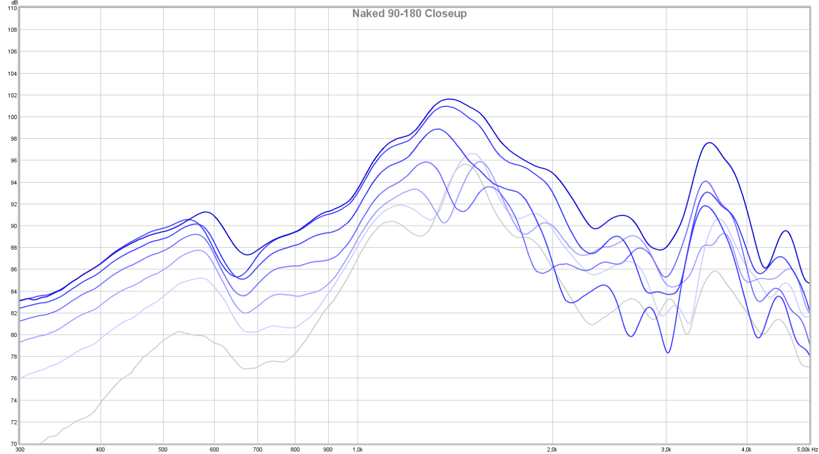

Tried this on a tilted baffle: off centred Seas TV21, used as midrange.
Works well, added bonus- the break ups seem to disappear, as they're beamed overhead.

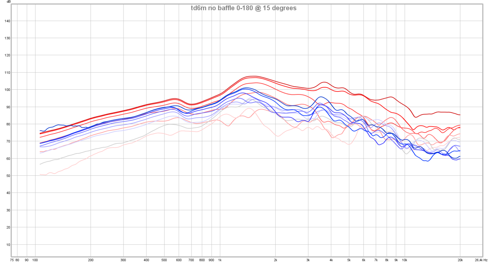

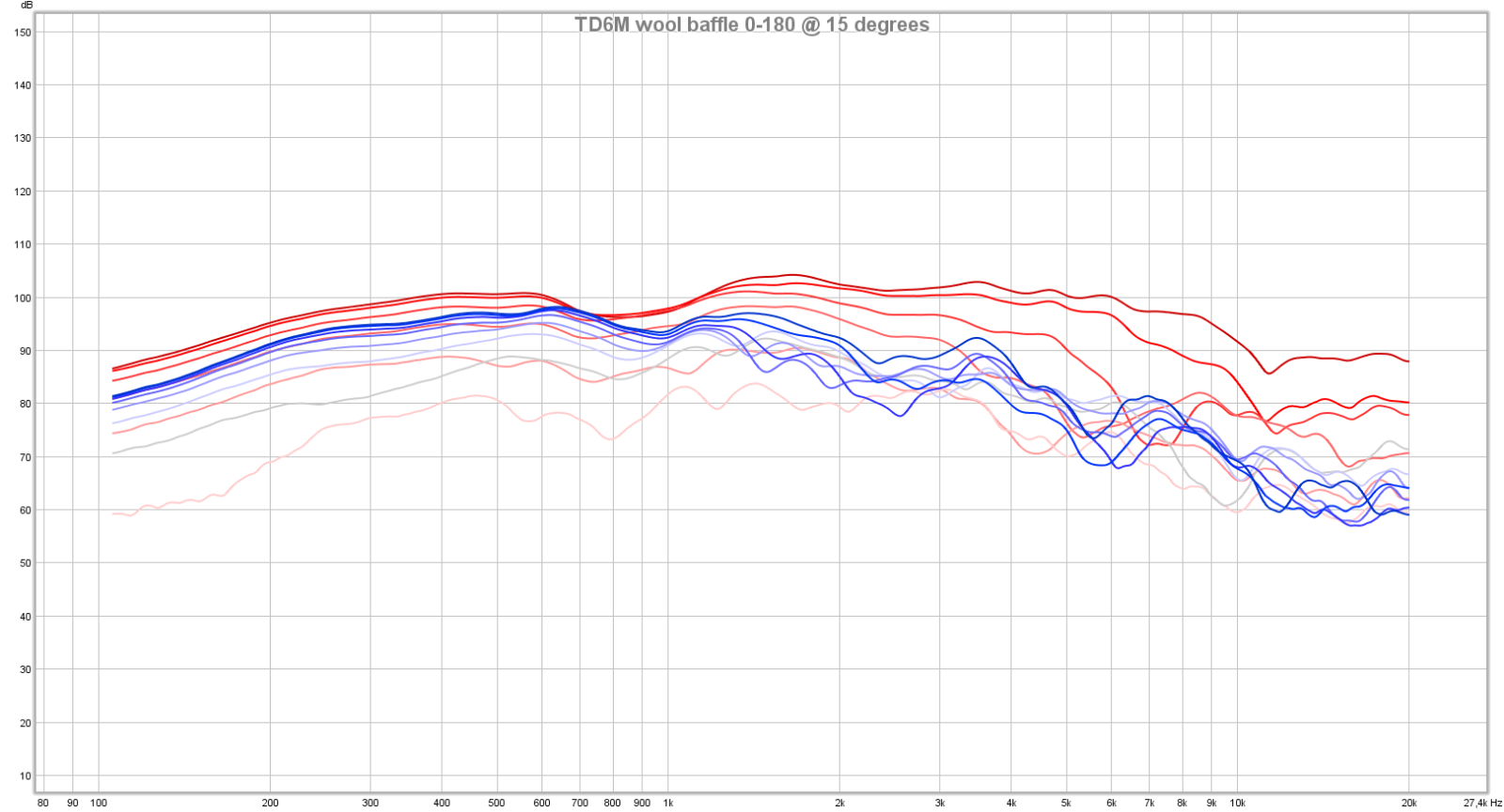

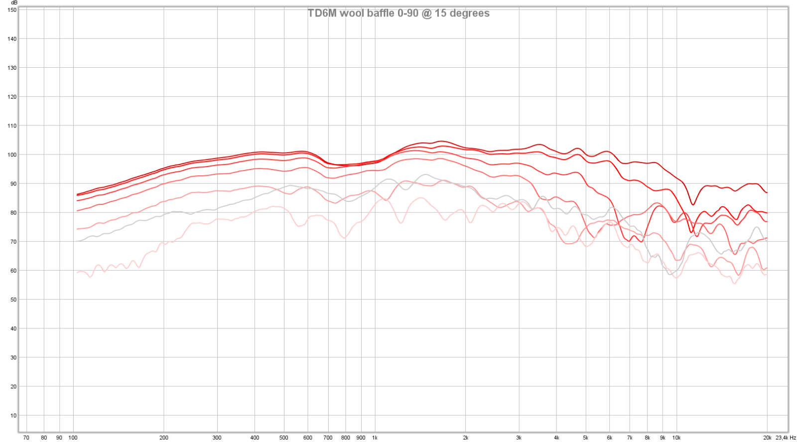

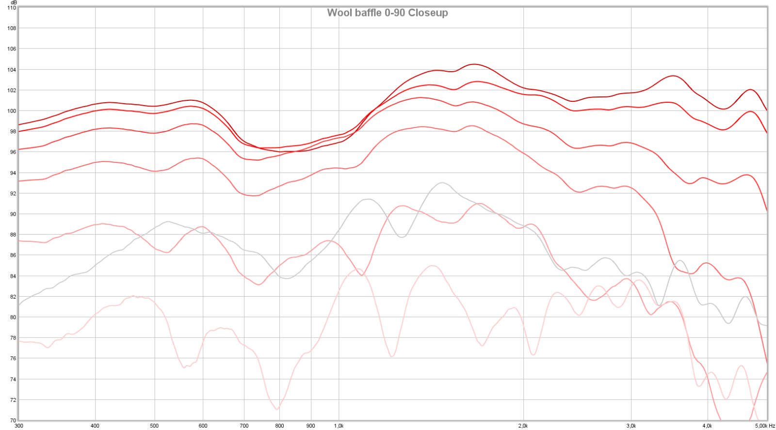

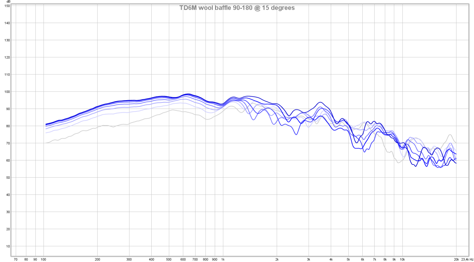

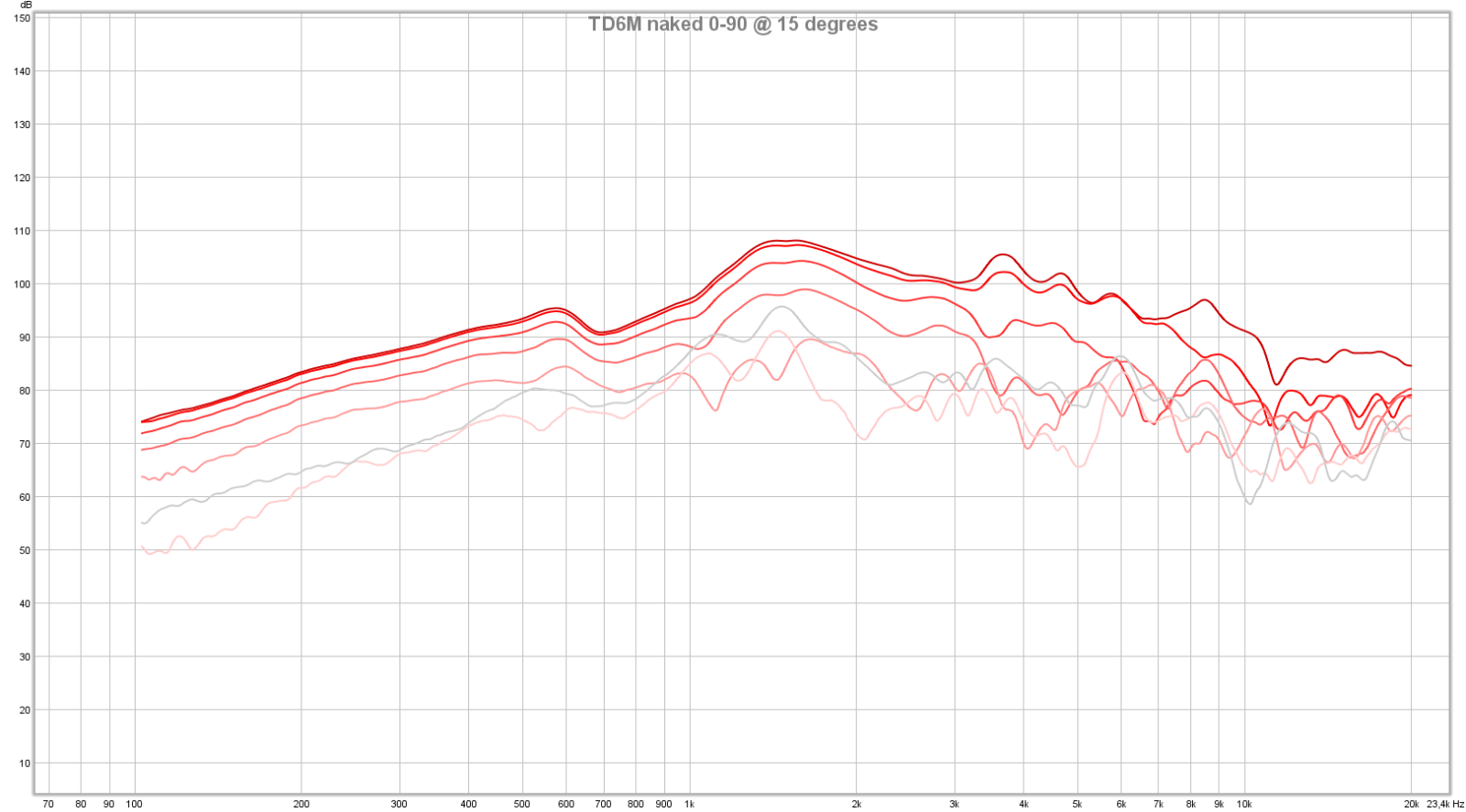

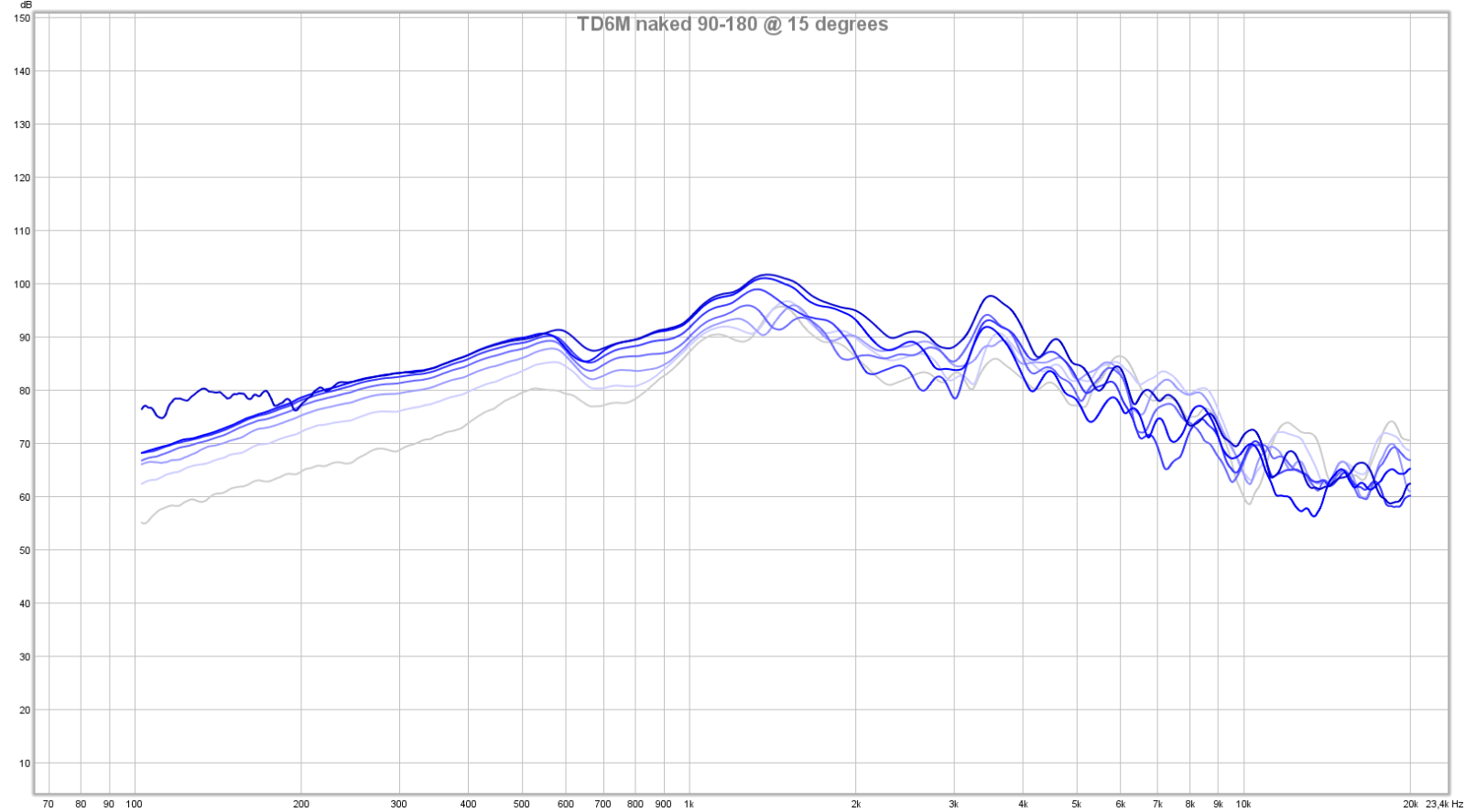

I just tried if wool can save you if you have a too big baffle:
The measurements are 0 - 90 ish, not exactly 15 degrees in between each measurement but somewhat close. And I guess the answer to the question is no, you cant =)
Why am I doing this? I'm moving into a less spacious place + I ideally want less ugly speakers and thus I'm considering minimizing my speaker: Split the subs into a multisub arrangement and then do the 100-150 hz and above in a simple 2 way by crossing to 2 waveguided tweeters. The tweeters have quite a bit of offset though so I wondered if it is possible to do the same but with a pair of 6.5" midwoofers or if the dipoleness will ruin everything.
I did measurements where both drivers were naked apart from wool and those measurements looked promising so I think I'll revert to that and do some more testing. I'm currently measuring indoors and I never get good 90 degree measurements when I do, so I might move the rig outside tomorrow to test naked & with some wool without some walls to ruin everything =)
The ideal is to then have the mids below the waveguided tweeters and then with wool baffles around them end up with 45-50 cm spheres I can suspend from the celing + cover the whole ball in acoustic fabric so they look better... I basically want it to look like a sphere lamp.

The left measurement is the driver naked, and the right one with wool on the sides.

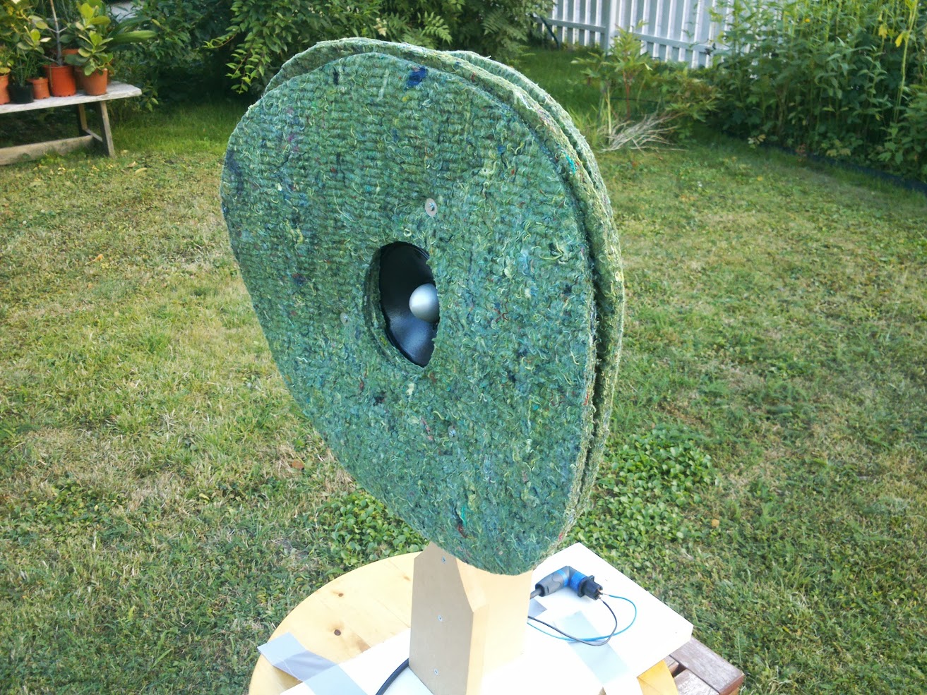

I tried 2" thick foam around a midbass driver, formerly no baffle , extended bolt mounted- which goes up to 1500 hertz in this no baffle, soft baffle, U Frame bass bin setup.
It really smooths out this driver's sound, eliminating a previously unnoticed splashy quality at its upper range.
