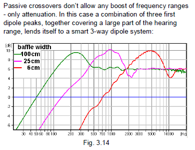

Here is the suggested method of making a 4-way dipole speaker by Rudolf
335821d1363195168-aino-gradient-collaborative-speaker-project-rudolf-smart-3w-dipole.png
