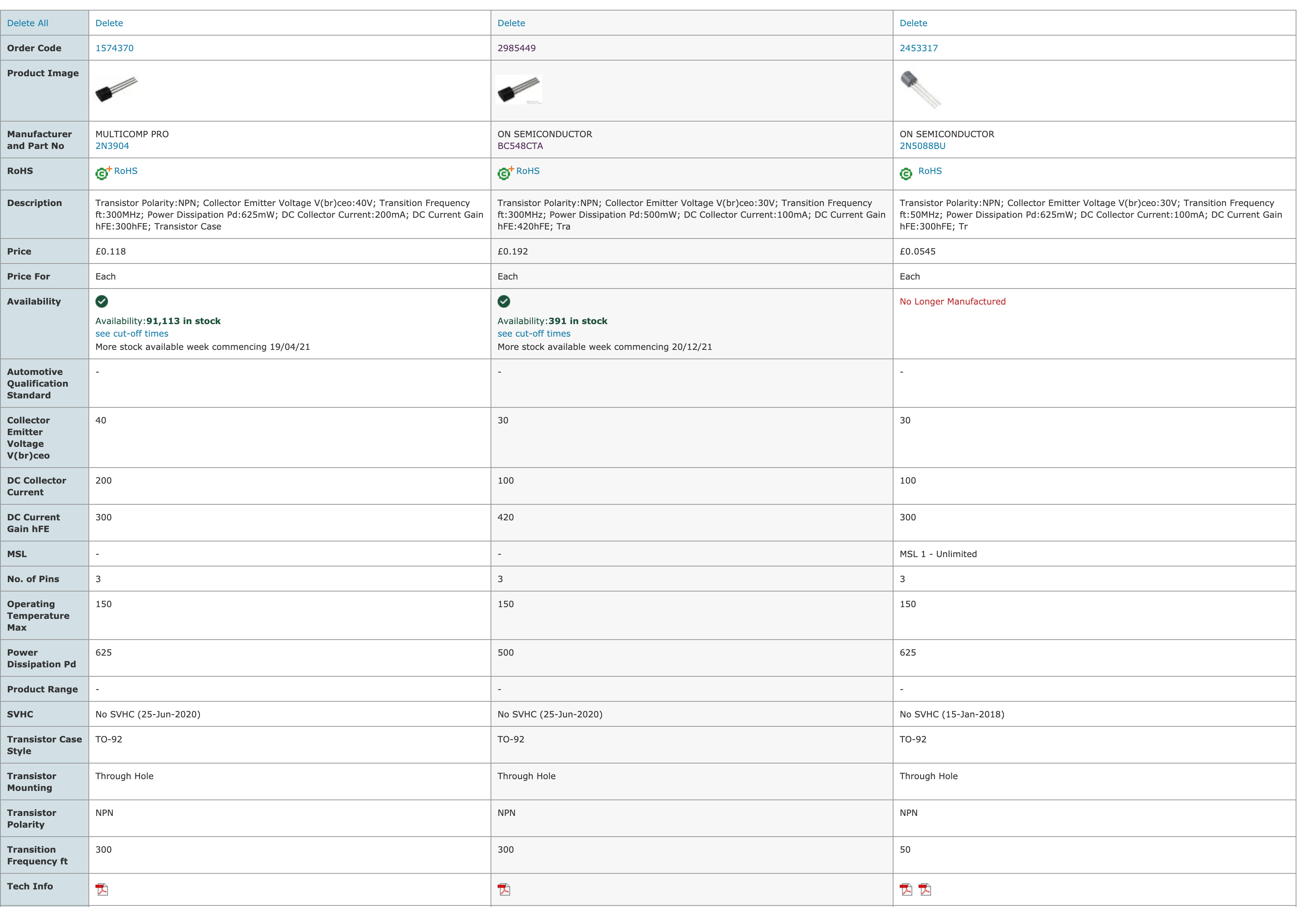

Just looking at the compare in Farnell and when comparing what matters to make sure it matches or is ok to be North or South of the original.

They are all fairly similar, the 2N3904 does have a 40 volt collector/emitter rating vs 30v for the others.
Never go lower on voltage than the original unless you can determine yourself that it will never see voltages approaching its limits. For example if the circuit operates on 20 volts then any would be fine, if it operates on 30 or 40 volts then you would need to study the circuit to see what the device will actual see in use in all conditions.
Same applies to collector current.
ft or transition frequency is the frequency where the small signal current gain falls to 1. For audio figures like 100MHz or 300MHz are so much higher than anything we encounter that it doesn't really make much difference, and the circuit itself should be designed to reign in any unwanted behaviour caused by transistor variations.
hFE is current gain and varies wildly between even devices of the same number. All circuits we encounter should work with values over a huge range... the beauty of negative feedback... it irons all these differences out.
Power dissipation is important and can vary a lot between devices of the same package. Again, unless you know or can calculate the power it will actually dissipate then don't go lower in a replacement.
In basic terms yes 🙂
If a transistor is rated 40 volts Vce then it can withstand that across it. Any higher risks failure. Normally a circuit has a good safety margin and would use for example a 40 volt device for voltages across the transistor of say no more than 30 volt.
Collector current is an absolute as well not to be exceeded.
Power is voltage across the transistor multiplied by current flowing through it and so you can see straight away that you can never have say 30 volts across the device and also its maximum current flowing at the same time.
30 volts * 0.5 amp would be 15 watts. And the device might be rated at 650 milliwatts maximum.
If it was switching a load such as a relay or bulb then you could have 30 volts * no current... so no power dissipation or you could have the transistor fully on (so it might have say 80 mv across it) and a current of 0.5 amp flowing. 0.08*0.5 is just 40 milliwatts and so all good.
