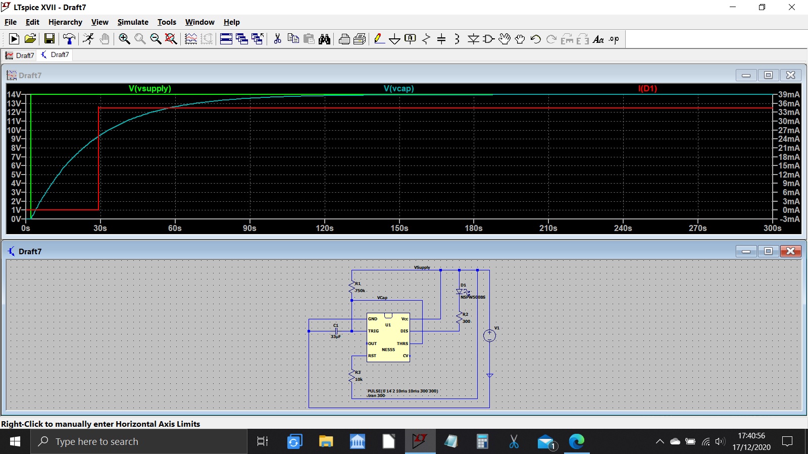

I through this together so you can see how it works. The supply appears 2 seconds into the simulation (bottom scale) and you can see the supply voltage and the voltage across the cap as it charges. When that voltages reaches around 2/3 of the supply voltage the 555 changes state and power the LED. LED current on right hand scale.

WOW that's amazing, and very impressive - thanks

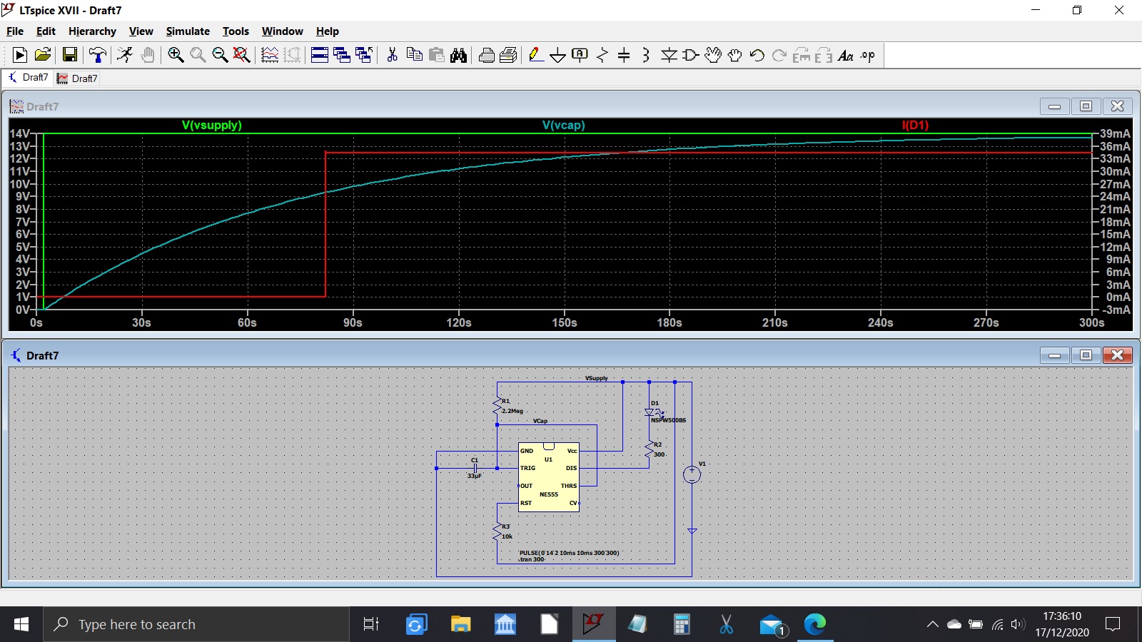

So I did take the mute off and it does create a voltage of 14V, so I will need to try a resistor that gives more like 2 mins, and also find a way of the mute not interrupting the voltage so I can have a light that is on when the amp is 'ready' and stabilised at 2mins.
maybe around 3M resistor as a guess?
I will have a look at the mute cable connection on the operate and maybe I can just unsolder that jumper?

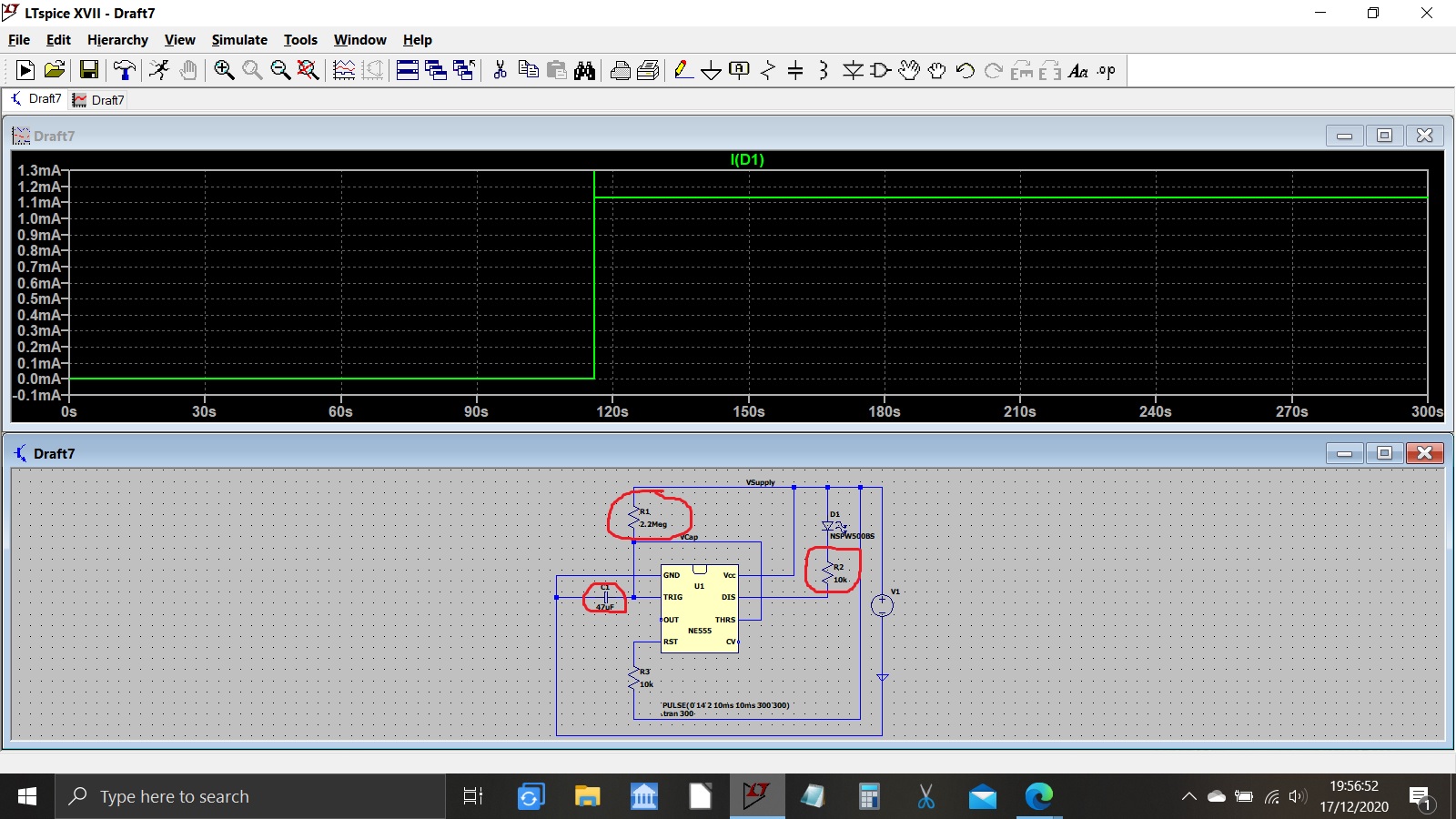

So, LED's are current driven, not voltage. It's a subtle difference.
If you ramp the voltage up across a red LED then no current will flow until you reach around 1.7 volts at which point current increases dramatically. A few millivolts increase changes the current massively.
14v = POP big time 😀
The LED needs to have a series resistor which in your circuit is the 300 ohm, however that value is to low and to much current will flow. It would be OK for a quick test with an old LED but if you are fitting something new and modern then change the 300ohm to say a 10k. The LED will still be very bright with that.

There is a limit to how high a value resistor you can use. The currents are so small that leakage current in the cap can dominate plus the current taken by chip input that the cap connects to. That timing cap really does need to be a tantalum type.
A 2.2meg resistor and 47uF cap gets you close to two minutes delay.

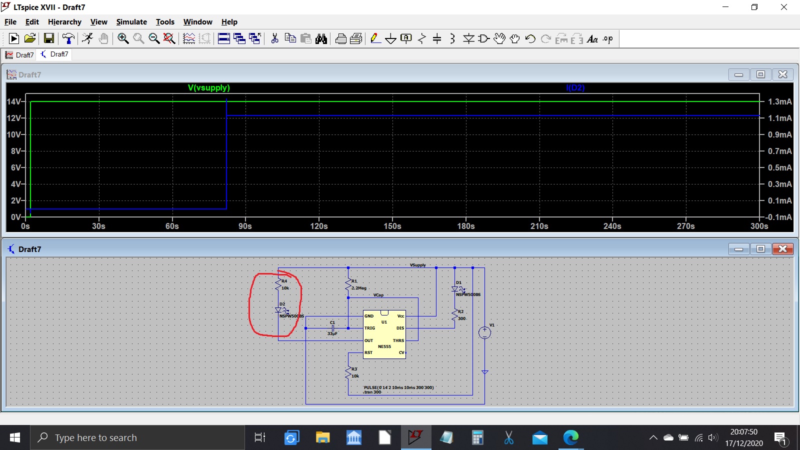

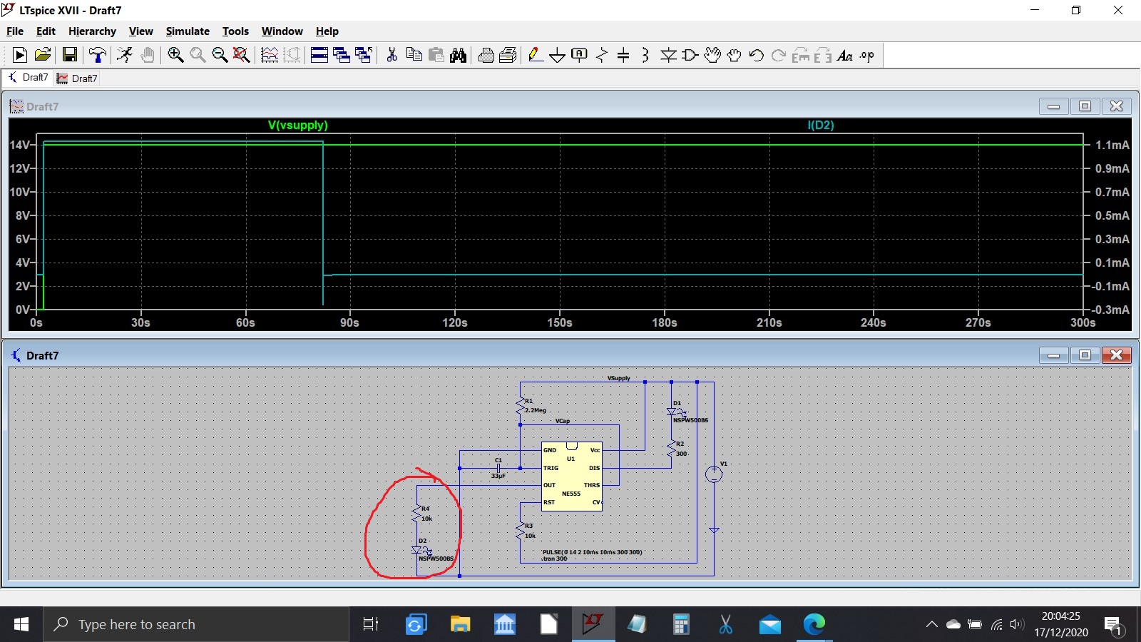

Well we have other options for running the LED.
If you want the LED to work the other way around then we can use pin 3 (that seems to be unused in the circuit) to run the LED.
If the led (and its series 10k resistor) is connected from pin 3 to ground then the LED is on at first (as now).
If the LED is connected from the 14v to pin 3 then the LED is off until the timer operates and then it will come on.

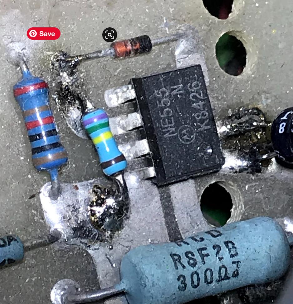

This might help you understand the 555 timer which has been around for 40+ years... and still going strong.

presume with the pin 3 option times switches it off
Pin 3 can both source and sink current, something pin 7 can not.
Look at the timing on the last two simulations and the LED connection and the LED current.
They are opposites.
One is on at first until the delay finishes, the other comes on after the delay finishes.
