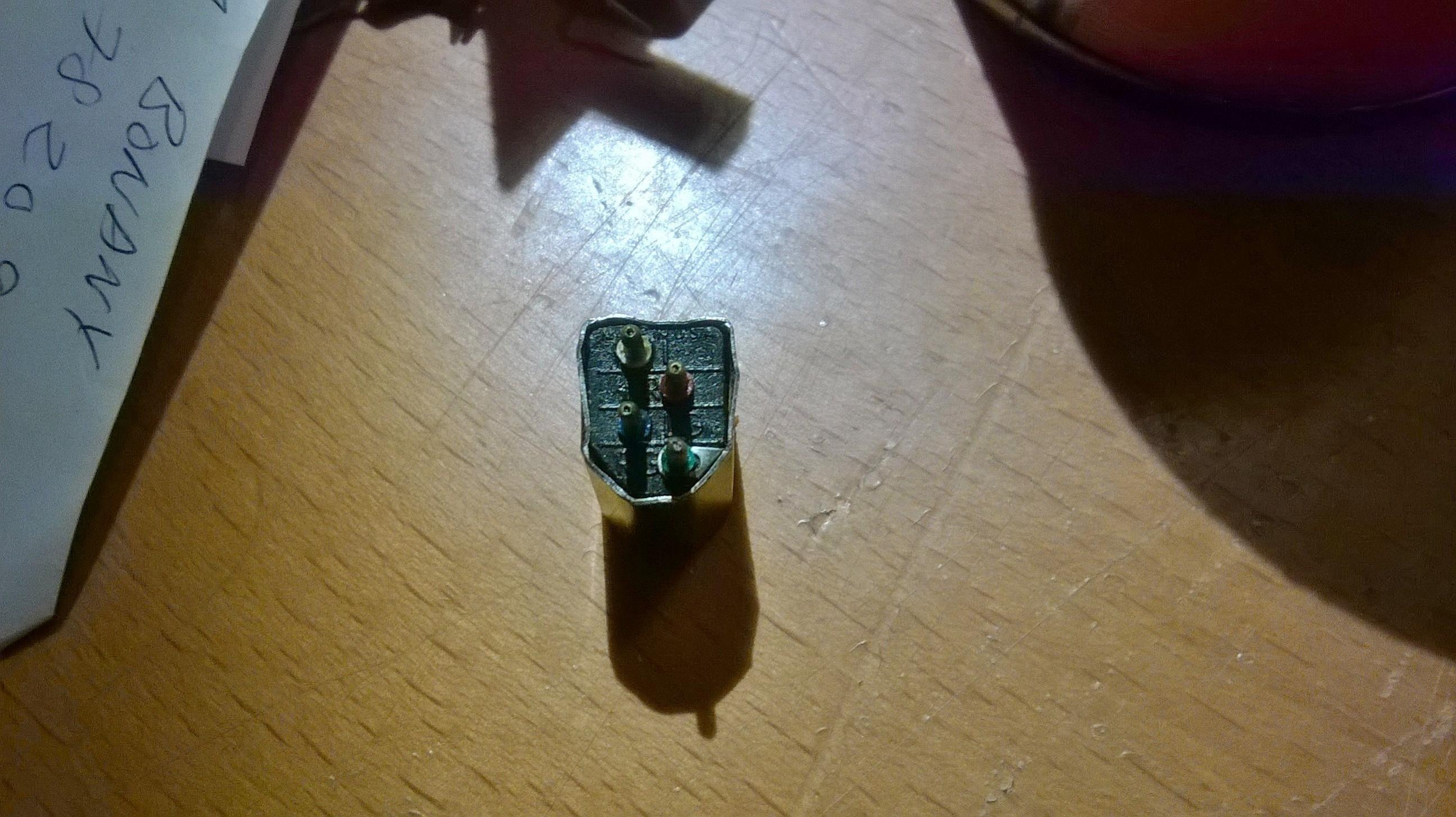

Often there is a metal tab that connects one of the negative pins to chassis ground. That has to be removed for balanced wiring.

Even just going under the base and rewiring for differential voids the warranty and turns a lot of people off. I don't understand one thing, all the TT's I have seen (not that many) were trivially rewired for differential, sometimes the cart had a clip though. Even that U-turn starter TT has a little board with header pins under the tone arm that are easily rearranged. Grado's will drive you to differential.

So for now a nice MM/MC pre-amp, FET in so one size does both with a simple gain switch that could also be head shell mounted (?) is a good bet. A question for those that know more than me is there a standard for the cart pin that gets grounded when there is a clip or connection in the TT? I would propose that the most universal solution would be to use one wire on each channel for ground and Vs and the other as single ended outputs since your pre-amp is low Rout the differential out is no longer needed.

I've seen it only on the Left neg pin. Anyone else?A question for those that know more than me is there a standard for the cart pin that gets grounded when there is a clip or connection in the TT?
Shure V15 Right negative pin
Thanks, you only need one exception to the rule. This could possibly be handled with one of those "you can't plug it in backwards' diode arrangements.

Re Ground tab
Audio Technica: Right negative
Shure: Right negative
Goldring: Right negative
Pickering: Left negative
Stanton: Left negative
George
George
Traditionally (since the late 1950's) stereo tone arm connectors were 5 pin DIN compatible connections. Outliers were always there (AR?) but most did work that way. If you did not remove that ground clip on the cartridge you could get a hum loop if the cartridge body had a metal connection to the headshell. Keeping the shields isolated from ground on the phono cables was critical.
