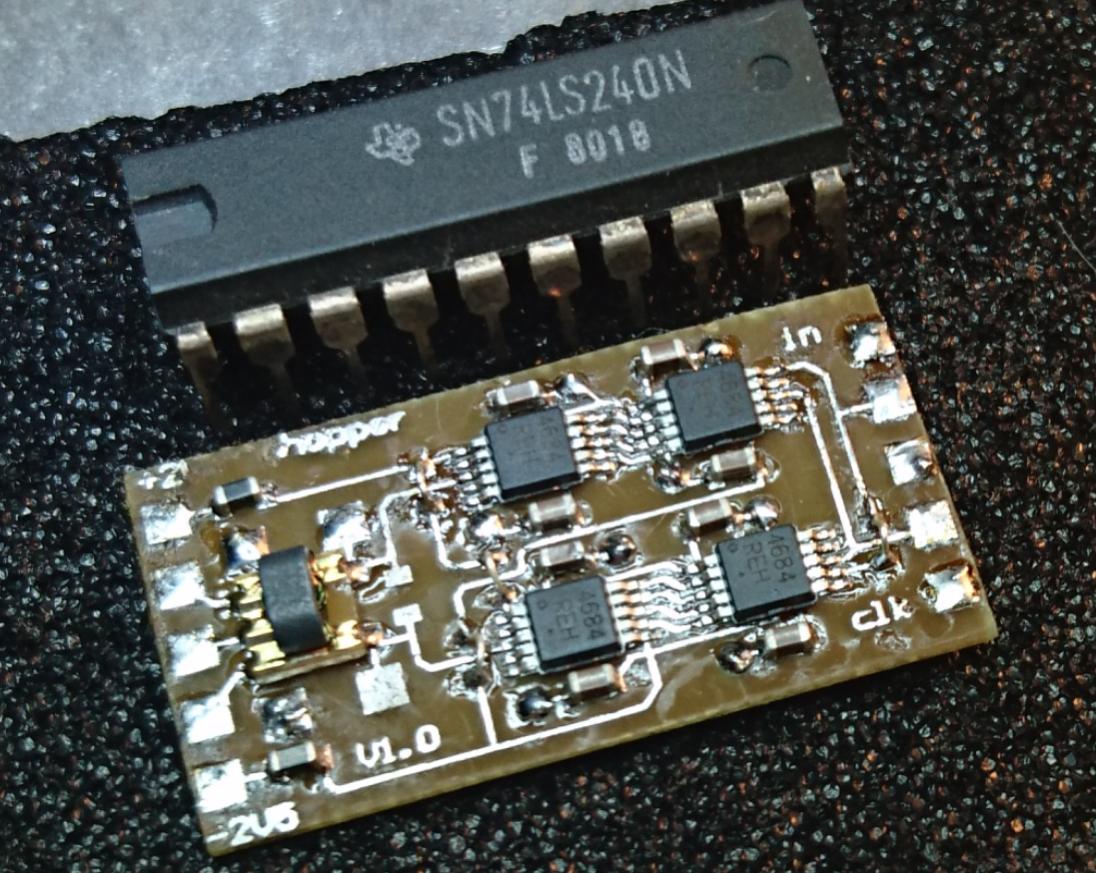

Chopper - Test circuit for my experimental ultra low 1/f noise preamp.
Designed, laid out, home-etched and populated last weekend.
🙂 Gerhard

Gerhard No QFN's there, child's play 🙂
