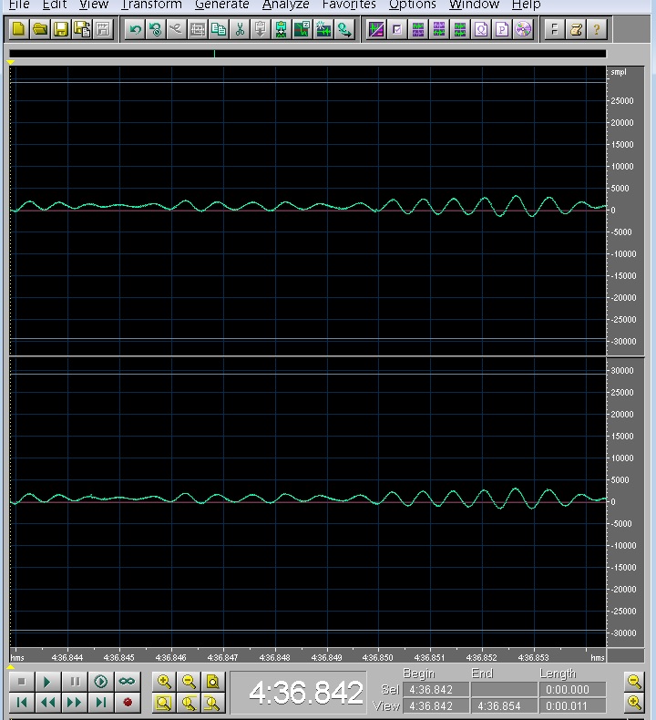

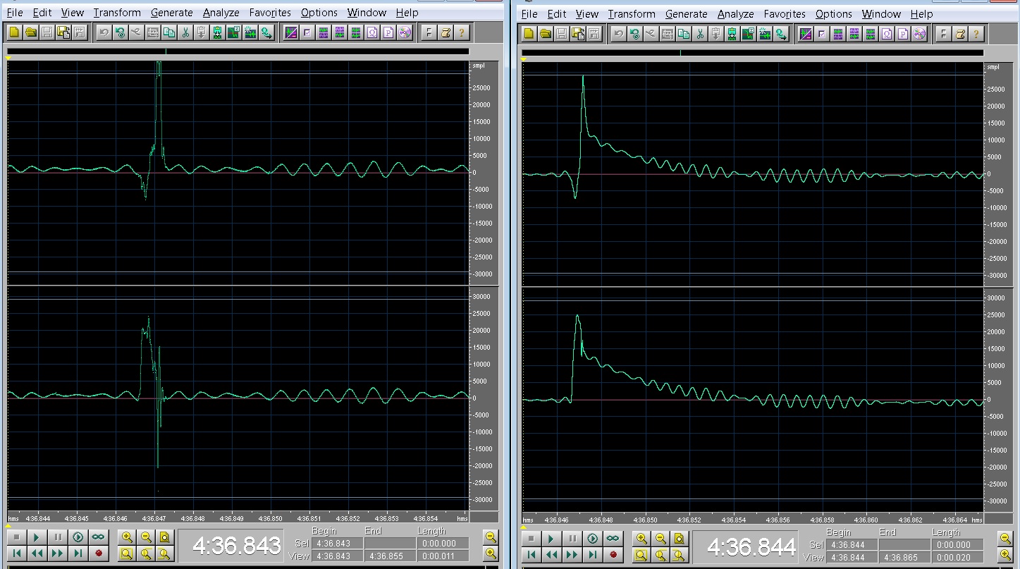

Yes, that’s best done at the pre-amp level. Before A/D designers figured out some solutions clamp-amps were a viable product, mainly because some A/D’s were on lower supplies and broke badly if a transient went outside the rails. Here are some pictures showing what I have observed with even some of the cheaper pieces of hardware. This is a Tascam DR60D recording band 25 on an old Telarc Omnidisk (1kHz 1/3 octave noise) with an unfortunate scratch. The second picture shows the first pop isolated where the upper channel clips, left is unequalized and right shows that after minimum phase RIAA you get basically a copy of the impulse response of the equalization. The point here is that extending the pop above clipping would only increase the area of the result but keep essentially the same shape i.e. the same sound only slightly louder. This of course is if the pre-amp does not stick at the rail, invert phase, etc. I see the Channel D folks are now recommending the Scarlet 2i2 USB soundcard, thanks to Jan I got one of those too. A problem with some of these devices is that line in is not differential and the differential mic preamps are 1-2k input load so a simple adapter is not a solution for MM/MI if you want to go differential. Also the noise performance/gain on the line in might not be a good fit.
Now notice that the equalization spreads the effect of what is ~1msec of lost track across a few msec of program. So this is another reason why the removal is best before equalization. The third picture is ClickFix in force fix mode where (you need to experiment at first to get it right) you select just enough program to get a near perfect repair. It seems to be some algorithmic thing in that trying to repair an entire track does not fix these really big pops as well. Usually there are only 20 or 30 bad clicks on records that I have chosen to keep. Obviously restoring badly scratched LP’s is a labor of love or money if you buy something like CEDAR.
Real time pop removal would require a different tool which I have not evaluated, or the easiest thing if I chose to do it would be to write it in C and use SoX in a pipeline. I don't have any interest in writing VST or any other standard plug-ins.
