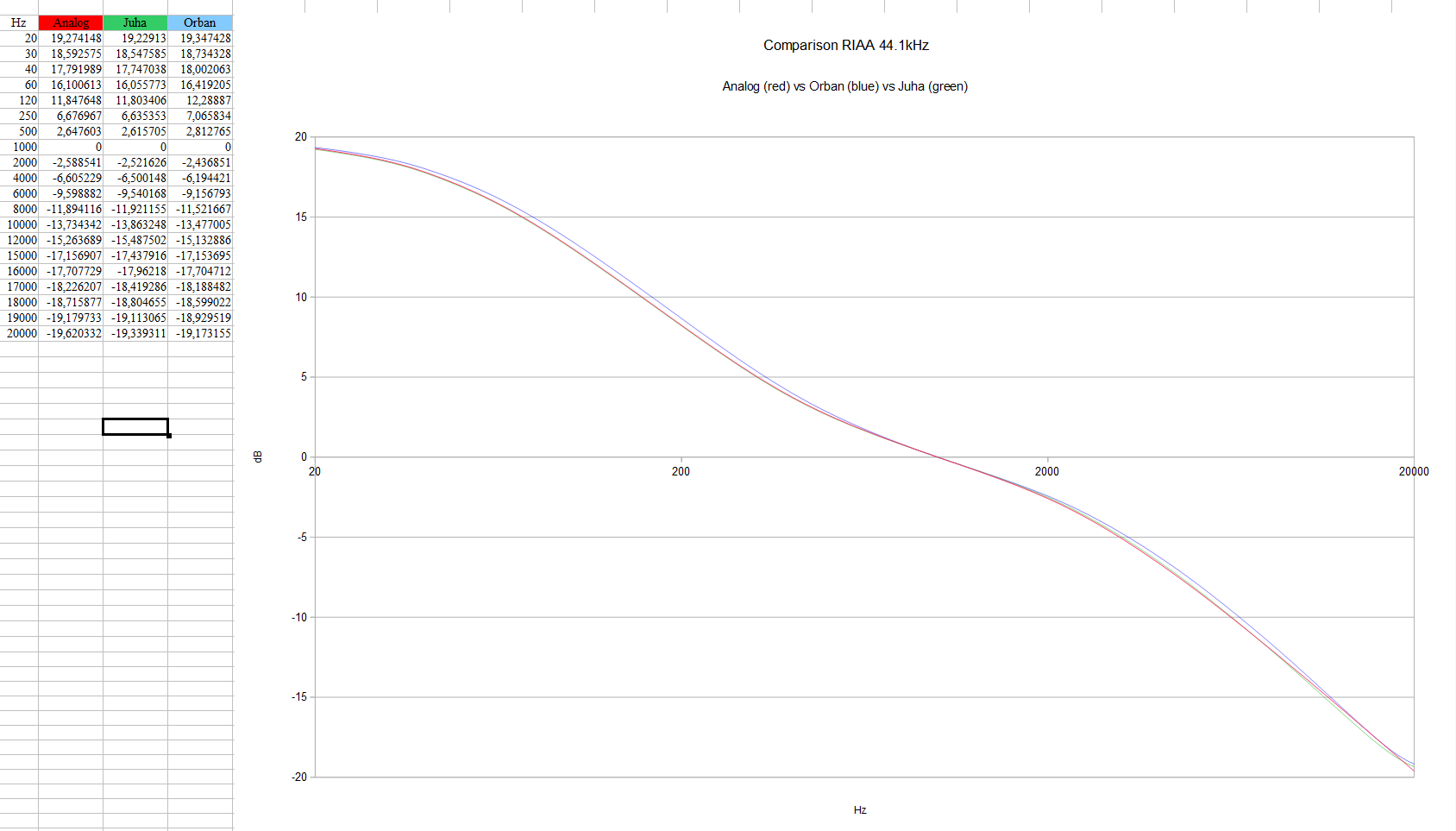

There's also another way to do the digital RIAA in a Windows based setup ...

You need to know how to use this information (and correct for his 50.5 Hz mistake, trivial BTW), he is a way smart guy and assumes a lot of knowledge of his audience.
I don't understand jiiteepee, I thought it was clear Bob Orban's solution is the global minimum. That is a mathematical concept meaning there is no better solution, you just compute them and put them in a table no CPU load at all. In any case use two bi-quads and the results at 44.1k and 48k are better than .001dB.
Nothing prevents using them with EqualizerAPO ... also, you can even use those Orban's higher order filters as well ... -> abandon everything else from that script shown above and use
Filter: ON IIR Order 4 Coefficients `b0` `b1` `b2` `b3` `b4` `a0` `a1` `a2` `a3` `a4` where a's and b's are the z-plane coefficients from orbans calculations.
Also as my EqualizerAPO script can be used for to produce non-RIAA EQ as well ...
IIRC, biquad coefficients for 44.1kHz RIAA EQ filter my EqualizerAPO script spits out has magnitude error of around +-0.3dB ... just try ABX the filter against Orban's or your's coefficients (i.e. do you really hear the 0.05dB-0.07dB difference between biquad implementations there?).
One nice matter with my script for EqualizerAPO is that it calculates coefficients for 'any' samperate.
Yes, that 0.45Hz error doesn't produce much difference in filter output ... I actually did measure it once but can't find the results anymore.
Attached comparison between Orban's and my MZT based RIAA filter against analog model (notice that error in my filter is quite small at below 10kHz area).
