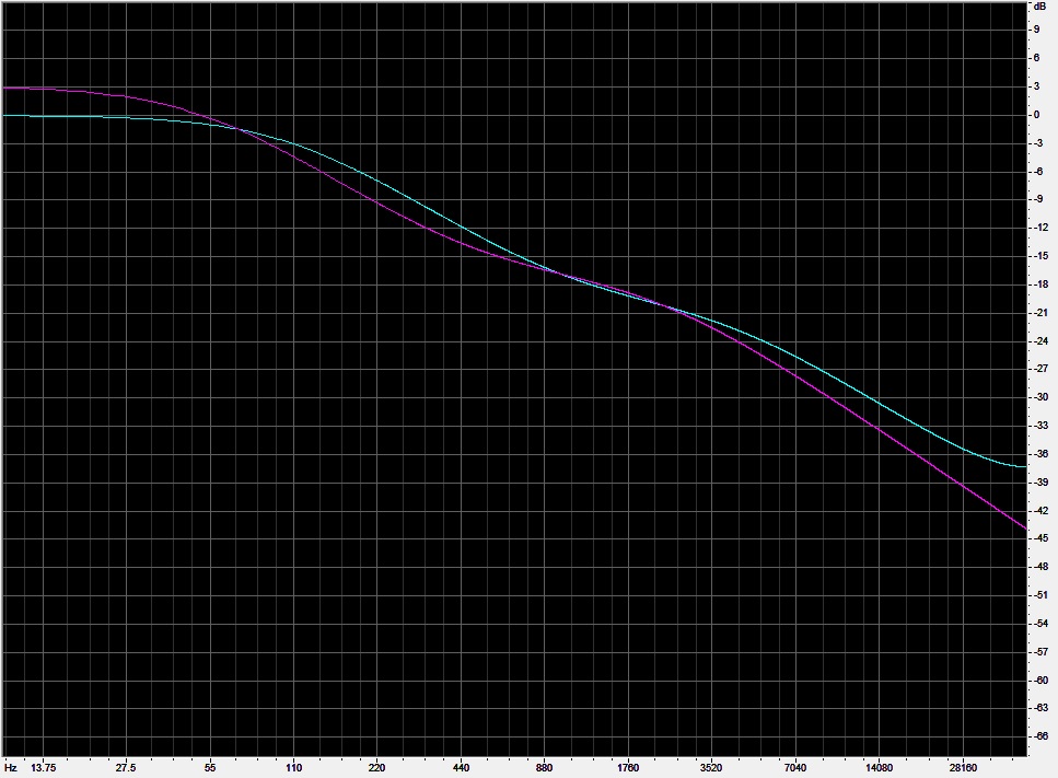

What do we know about its RIAA and Inverse RIAA?

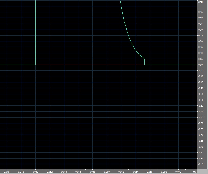

Impulse response is minimum phase but at first glance there is only ~33dB drop from 20 - 20k which would be way off.
EDIT - Adding picture, purple is ideal for comparison set equal at 1kHz
If you're talking 'bout Acoustica issue then could it be wrong coefficients for the active samplerate or did they just manipulate the normalized (0dB@1kHz) coefficients? IIRC, I did contact Acon at some point regarding some issues I found but I could not find the e-mail anymore.
If you're talking 'bout Acoustica issue then could it be wrong coefficients for the active sample rate or did they just manipulate the normalized (0dB@1kHz) coefficients? IIRC, I did contact Acon at some point regarding some issues I found but I could not find the e-mail anymore.
No, it looks like a badly truncated FIR. See picture this can't happen with IIR but it is possible that there are other problems too. At 96K the impulse response is only about 1600 samples long, it would be very hard to do an accurate min-phase FIR this short.

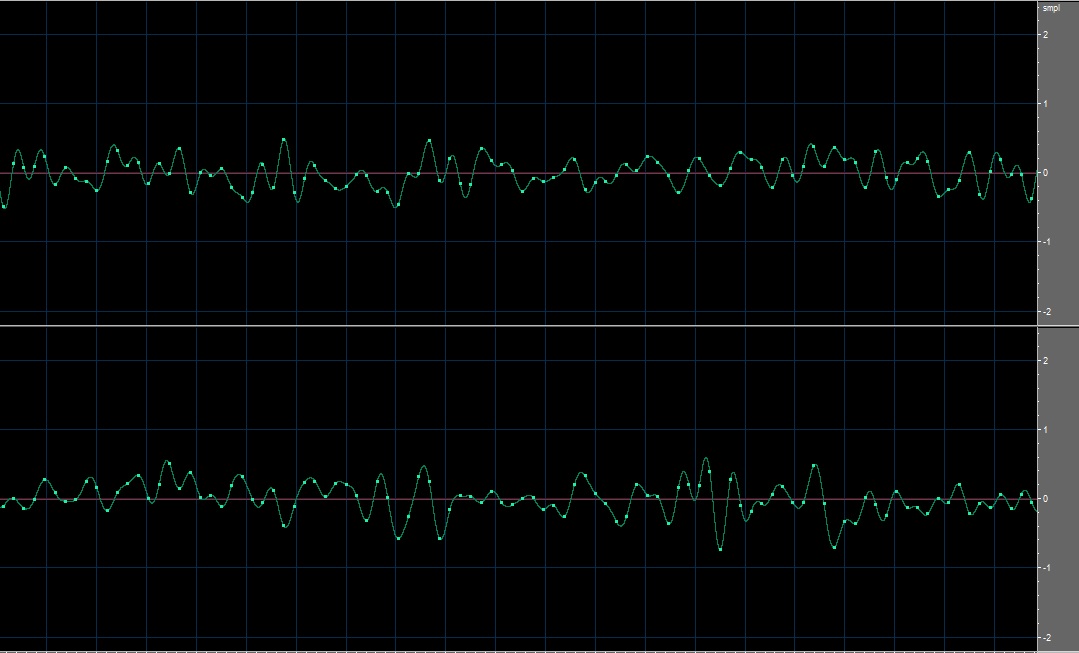

What's a good tool to verify 24B data?
Rendered the EQ's file using Acoustica with Olaf's RIAA vst. I'm very happy with how this sounds and, so far, I haven't had to buy anything which is the best part.
Your eyes, simply expand the vertical scale a lot. Look at the pic I just posted (#467) the 1, 2, etc. on the vertical axis are 16 bit LSB's 16 bit data lies only at integer values if there are points in between there are more than 16 bits. We've posted pics here a few times in the past.
There is one catch I have seen 16 bit data dithered to 24 bits, this is rare but the histogram is wonky. Usually it's pretty obvious, at +-32767 full scale the data is only at 1, 2, 5, etc.
With Cool Edit and my 2i2 the data with the amplitude turned all the way down as in that plot the data is nothing but -1, +1, or 0.
