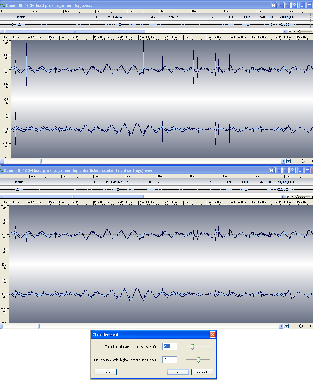

Hi Bill
Audacity “Click removal” effect does a decent job.
For a one LP side recording (24b/96KHz) it takes 3 minutes to do (enter into Audacity, open file, declick, export file, exit Audacity)
With just the standard settings, it takes away the HF content of the artifacts without affecting the HF content of the music. Fiddling with the settings, it may do a better job. Try it.

I will (one I have a few things in place like an ADC). I have worked out the test album. I have a very kn*ckered copy of 'the sound of bread' which I inherited after my sister had played it to death. Not everyone's cup of tea but relatively sparse recording so the ticks are very obvious. BTW I found an interesting link last night on spectral declicking with Reaper using spectro Declicking in REAPER? - Cockos Incorporated Forums
Hard work, but worth trying, even if it's to dismiss as not worth it! Confusingly there are two products called spectro. Spectro Stillwell Audio is the one.
You can readily use the DL-103 Mahler file Bill.
I doubt your LPs are that badly scratched and popped as that 😀

IIRC Audacity uses spectral signature to identify the clicks which according to the paper Bill posted is inferior to statistical. I found ClickFix (free) better but only for Audition or Cool Edit.
Just checked, Audacity won't allow individual click removal (maybe the repair effect works for that?) and silence with a full scale pop (passed through RIAA) in the middle came back with no change. This means that your results before vs. after RIAA with this tool are going to be more extreme (my guess).
I already posted that picture of the huge discontinuity repaired by ClickFix in one of these threads. My experience has been that any tool used over long sections of music has to be tuned by ear especially if it's full of pops. For those with patience and say one or two bad pops per minute I would do the individual removal only or at least first.
ClickFix has an aggressive mode where you identify the damaged spot so it goes right into the recursive restoration the results as I posted are amazing.
Yes.

But it must be less than 128 samples, so definitely only really useful before RIAA.
