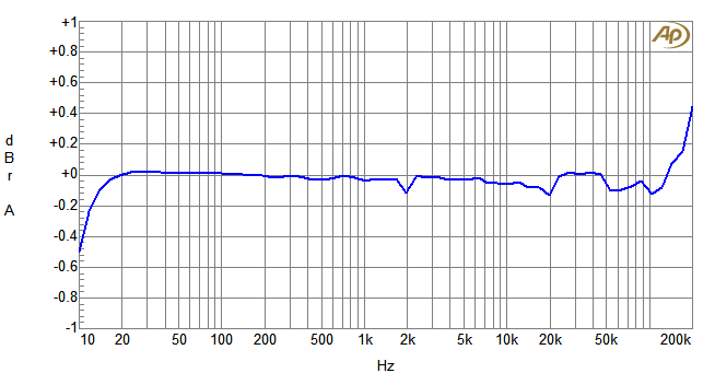

The Analog Devices with the ADG prefix are excellent and quite easy to program.
Very nice data. I think i can live with this very minimal drop at 2k and 20k.
Which adg do you think would suit best for low level input?
I consider the adg707 because of 8 dual inputs. Do you think its okay for an input selector?

The ADG707 is a low-voltage device and the THD% might be somewhat worse than the ADG1414. The lowest and flattest "on resistance" associates with higher supply voltage.
Unfortunately, the ADG1414 is TSSOP -- get yourself some adapters and solder paste -- Scott mentioned in another thread that they use a hot-plate for rework on these small parts. Would seem to be better than the toaster oven!
