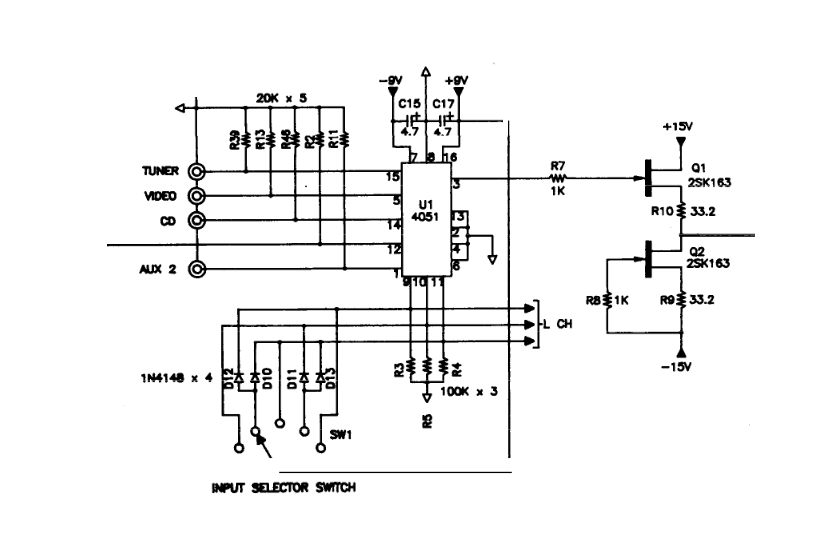

Often its the implematation, that matters. If the CD4051 does not switch the signal itself, but only drives the real switch, than anything is fine. But i cant imagine, that the CD4051 switches the signal directly 😉.
The CD4051 most deferentially does switch the signal....
http://www.hafler.com/pdf/archive/Series915_preamp_man.pdf
Look at page 22, U1 is the 4051 and the Tuner, Video,CD,Phono/Aux1, and AUX2 are ALL connected directly to and switched by the IC. The signals are inputted on pins 1,5,14,14 and 15 and exit on pin 3
You're right. I cant tell you why, but i had thd of over 12% under 1k with the cd4051, but perhaps i need a better psu for this chip.
I will try both, the relay way and once again the cmos way with a better psu.
Thank you for pointing this out.

Nevertheless, with some smart circuit design, these types of switches can be pretty much invisible, audio-wise. If for instance you use them to switch the inv inputs of opamps in inverting mode, there's just mV across a switch. Prety invisible.
This type of switch can even be found in well-regarded distortion analyzers, switching the signals and attenuators.

LinuxGeek,
If you intend to give it another go, I would try and build it exactly as in the Hafler 915 data sheet, relevant subsection picture attached here as it's known to work. Note the load on pin 3 looking at the gate of the jfet is many millions of ohms, meaning the switch will develop virtually no voltage across it. You can replace the jfets with LSK170 or 2SK170 or LSK389. And you can even run the jfet buffer from the same +9/-9 rails used for the chip. In fact you can try it with two 9 volt batteries as a quick mock-up. Like the B1 buffer you may wish to add a 1k safety resistor at the output, to prevent blowing the jfet in case you short the output, dc decoupling unlike the B1 is optional for this circuit, DC offset will depend on the jfet matching, if it was me I would use it. Keep the connection between pin 3 and the gate of the jfet as short as possible it's practically floating when switching between channels. I found some pictures of the inside of the Hafler 915 online so you can get an idea of a "known good" layout. I would be interested to know how it sounds.

Guys, thank you all for your help. Today i realized my problem. My older attempts were wrong from a design perspective. I never "sank" or how to call it the not selected signal. All signals, that are not selected should go to a high impendance resistor to sink the signal. I did not do that in my former designs.
So the signals, that were not selected were floating and this was all that caused distortions and also crosstalk with the adg1414. I will go back to breadbording and correct my designs. I will once again try the cd4066, cd4051 and the adg1414.
Only my old relay will not benefit from this treatment.
I will report as soon as i tried cmos way the proper way.
For the cd4066, that was still on one of my beradboards, the distortion went back from around 12% at 1k to just 0,15%. Still too high for me, but i think the adg1414 could do the trick or perhaps the cd4051, i will try.
