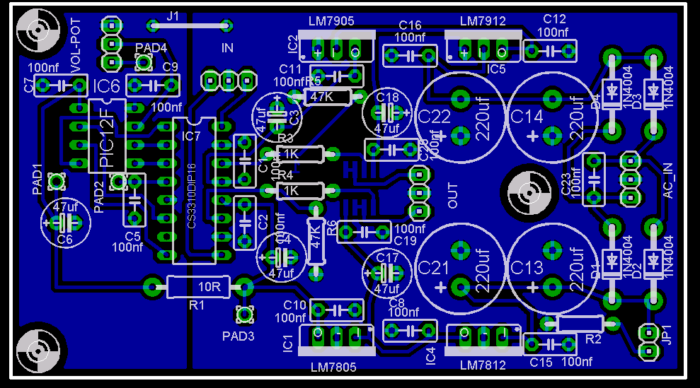

Hey, Russ!
Don't feel bad about the signal leakage, I have seen plenty of commercial gear that does that, too.
Do they make normally-closed super mini relays? You could always short the output when the power is off. 🙂 It wouldn't be in the signal path, relay current is irrelevant, but if your amp is battery-powered, then the current draw much but make it a non-starter...
Wes
Wes
Well that is good to know Wes. 🙂
It is a very tiny signal which is passing through, barely audible.
I will check out the normally closed relay idea, I had actually used that once before, but in this case I think I should probably put a resistor beween the relay contact and ground so as not to completly short the output of the AD8620 during the brief time it is powering down.
I wonder if that would get me the desired effect.... 🙂

The resistor is not a bad idea -- I wouldn't have thought of that!
That said, I checked the Analog datasheet for that chip. It lists "Output Short-Circuit Duration to GND .... Infinite" in the abs. max ratings section, so I don't think the resistor is strictly necessary.
Snubbing the relay with a diode is also worth considering.. but I'm not sure if the spike would happen while the amp was capable of "pop"ping your headphones.
Also, IF I'm reading the sheet right, it says the chip draws 65 mA when the output is shorted -- that may happen when the amplifier is first powered on.
Hey, check these babies out -- http://oeiwcsnts1.omron.com/pdfcatal.nsf/PDFLookUpByUniqueID/E96F438DF5E13E9B86256FC7005C765D/$FILE/D20G5LE0305.pdf
The G5LE-1's (12V, 24V) are in stock at Digikey, Allied, Sager.... and worth about three bucks. The largest dimension on this relay is under one inch. It is SPDT, so you can use one side as if it were a SPST-NC. Coil current is 400mW.
I have 280mW Omron relays that are even smaller, but the price doubles and nobody seems to have stock.
But I only spent a few minutes looking.
Wes

Wes, you have been very helpful.
I will look at some relays, I will also try to come up with some ideas for the layout. Thanks for your input. I can always use an extra pair of eyes. 🙂

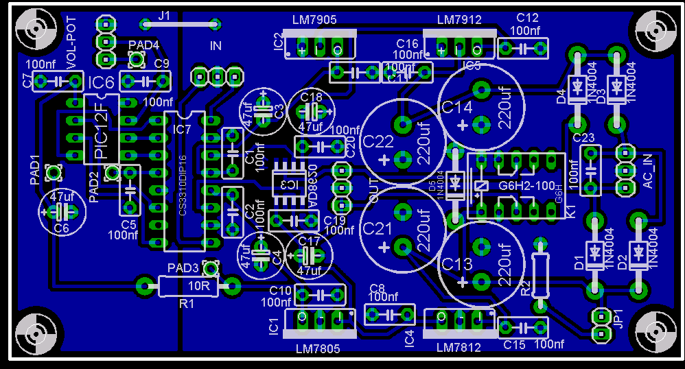

So far this looks like the best candidate... It only draws 200mw.
http://pdf.alldatasheet.com/datasheet-pdf/view/82419/ETC/DS2Y-S-DC12V.html
And I can get them for about $2.00US and they are not large, and I would only need one per board. 🙂
Atually now that I look a little deeper I think these DPDT
AZ847-12
http://www.azettler.com/pdfs/az847.pdf
which is equivalent to
Omron G6H-2-DC12
Are perfect.
Very small (DIP10) and low power consuption and fast acting.
And I just got some on ebay for less than a buck each. 🙂
Cheers!
Russ

Brian and I discussed the switch and the relay, and pros and cons of each. In the end I think I will try both, but the relay version will come first because I acually think it will have the least effect on the signal.
In any case, here is the new layout with the spot for the relay. In can be omitted without any ill effects(except the noted leakage with hot sources).
The leakage of the 2311 is mentioned in the datasheet, now that I have re-read it.
Cheers!
Russ

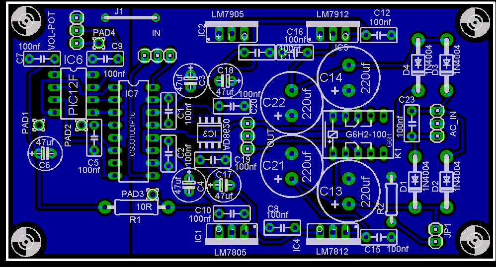

maf_au said:Want one 🙂
Soon.... I hope. 😉 Lemme get a couple protos built first. 😀
BTW I forgot the snubbing diode for the relay, here is the corrected layout. 🙂
5mm pin spacing.
Thank you, I assume that these are polyster types. Smallest MKP's I can find have a ps of 7,5mm. (Epcos B32 620)
