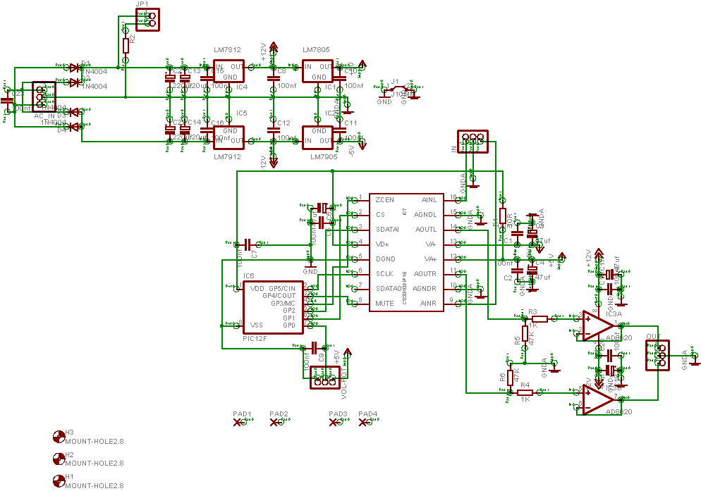

Internal or not to internal
Hi Russ,
Just a small question. I was looking at your schematic, and realised you have not included a crystal.
If you are, what speed would you like it to run at? I assume 8MHz.
Please let me know.
Also, one small question. Instead of having a rotary encoder and stuff; have you given thought about a Digital Pot and IR(or RF 🙂 ) remote?
thats all for now.
~M.

Re: Internal or not to internal
Nope no chrystal intended. It should not be necessary I don't think.
The only human interface is from a 5K pot with the wiper read by the ADC to get my value for the PGA2311.
I have given though about the IR or RF, but I wanted to get this simple example working first. 🙂
In fact if I couldjust get the part to send the serial data to the PGA2311 I would be happy. 🙂
Thanks!
12F683 has an internal oscillator -- you also use the power supply for VREF.
These are wonderful devices to work with.
Russ -- as you know what you want to accomplish in VB perhaps using a BX24 from Netmedia would ease your implementation --

To assure complete happiness:
1) on each of the control pins of the PGA2311 (SDI, CE, SCLK) place a 10K resistor to ground.
2) on each lead from the PIC to the PGA2311 place a 50R or 100R resistor.
these two changes will result in reduced "ambiguity" -- they also decouple some of the clock noise from the PIC to the PGA.
You might be happier using LM317LZ and LM337LZ voltage regulators for the V+ and V_ supplies == 2 pairs == these are in a TO-92 case and will do about 100 ma each -- they will also give you better noise performance.
not a bad idea to decouple the Digital Power from the supply -- or provide it with its own LM317LZ or 78L05.

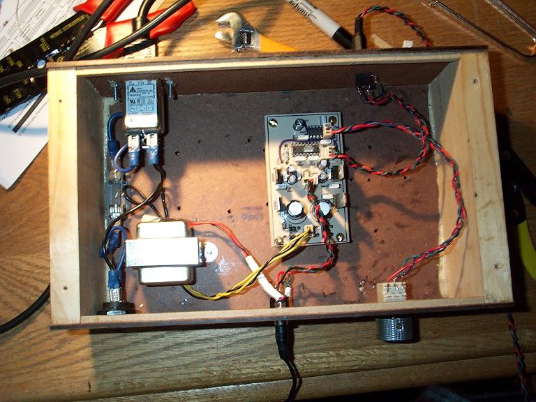

Well folks, I could'nt be happier today. I programmed the PIC and plugged it in and it worked on the first try. 🙂 Talk about about a good feeling, that does not often happen for me. 😀
Here is the code as it is now, and it works great..
Volume transition is smooth. I can't detect any noise from the digital pot changing volume at all.
Here is the code.
I am working on a REV 2 of the PCB. Stay tuned. 🙂

Question...
OK, this preamp sounds awesome, but I have noticed something odd.
When I turn off the pre, but leave the source on as well as the power amp a very small about of sign leaks through. This only happen when the power is off. Well this makes some sense looking at the PGA2311 datasheet it appears that at power off state the digital pot resets to about halfway.
Soo... I wonder how to prevent it.
I have a couple of theories:
1) make the impedance to the opamp(or rather from the PGA2311) lower by adding a resistor from the output of the volume control to GND.
2) Isolate the opamp from the PGA2311 by adding a 1K resistor in series with the output to the input of the AD8620.
3) both of the above.(the attached schematic is what I propose to do)
4) I could add a relay or a didgtally controlled switch, but I don't really want to do that.
Anyone got any ideas?
Other than that small quirk the thing sounds amazing.
Thanks,
Russ
Thanks,
Russ
