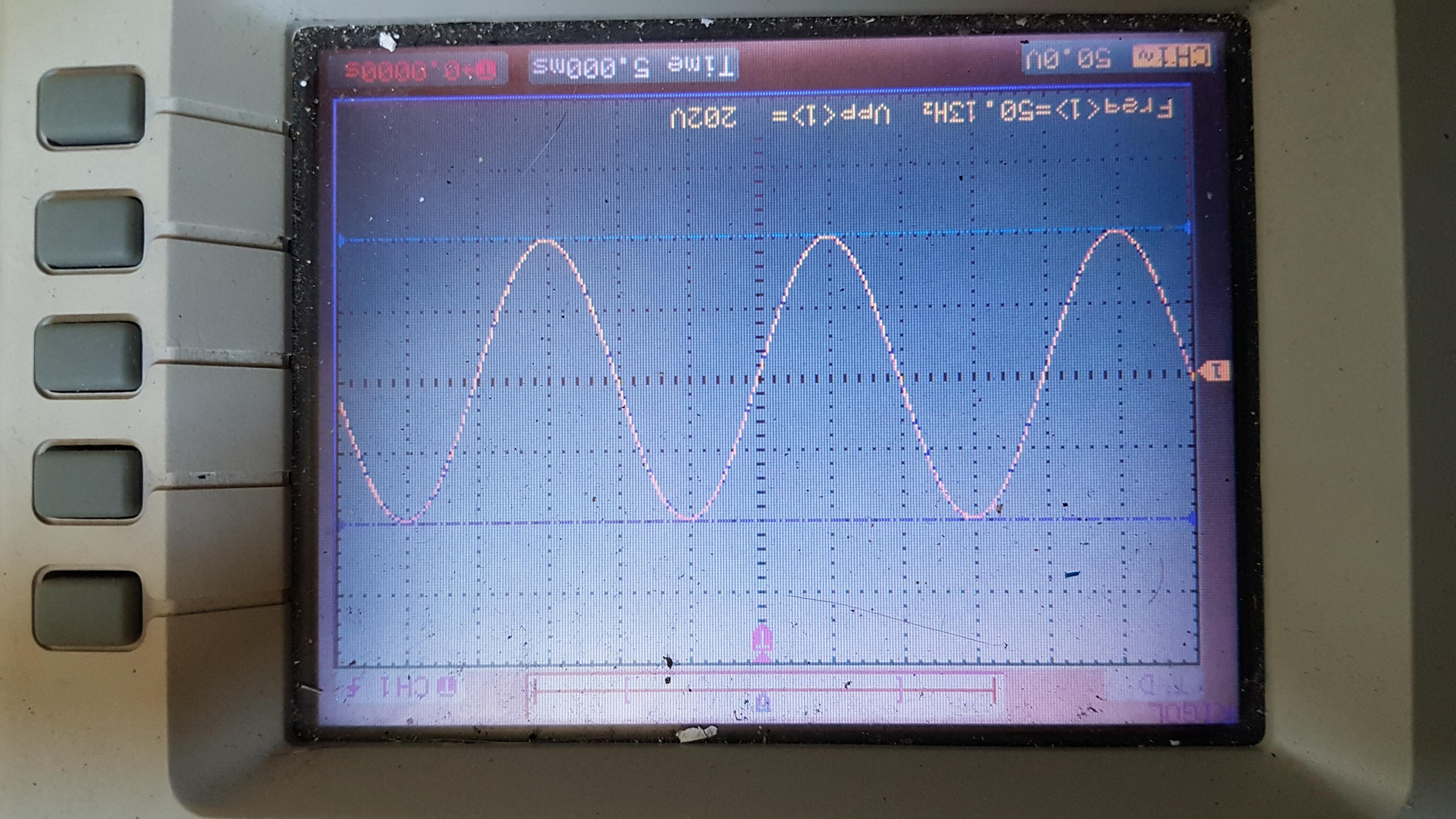

Hi sq225917, (and Greggan) well I am happy to report that with a slight circuit modification I can generate any sinewave voltage from 4v up to 225v controllable from software. (Each phase can have its own voltage setting). So that means a whole range of extra options for the motor now available. e.g. Rega 24v synchronous 2 phase AC motors. I will build this modification into the revised PCB.

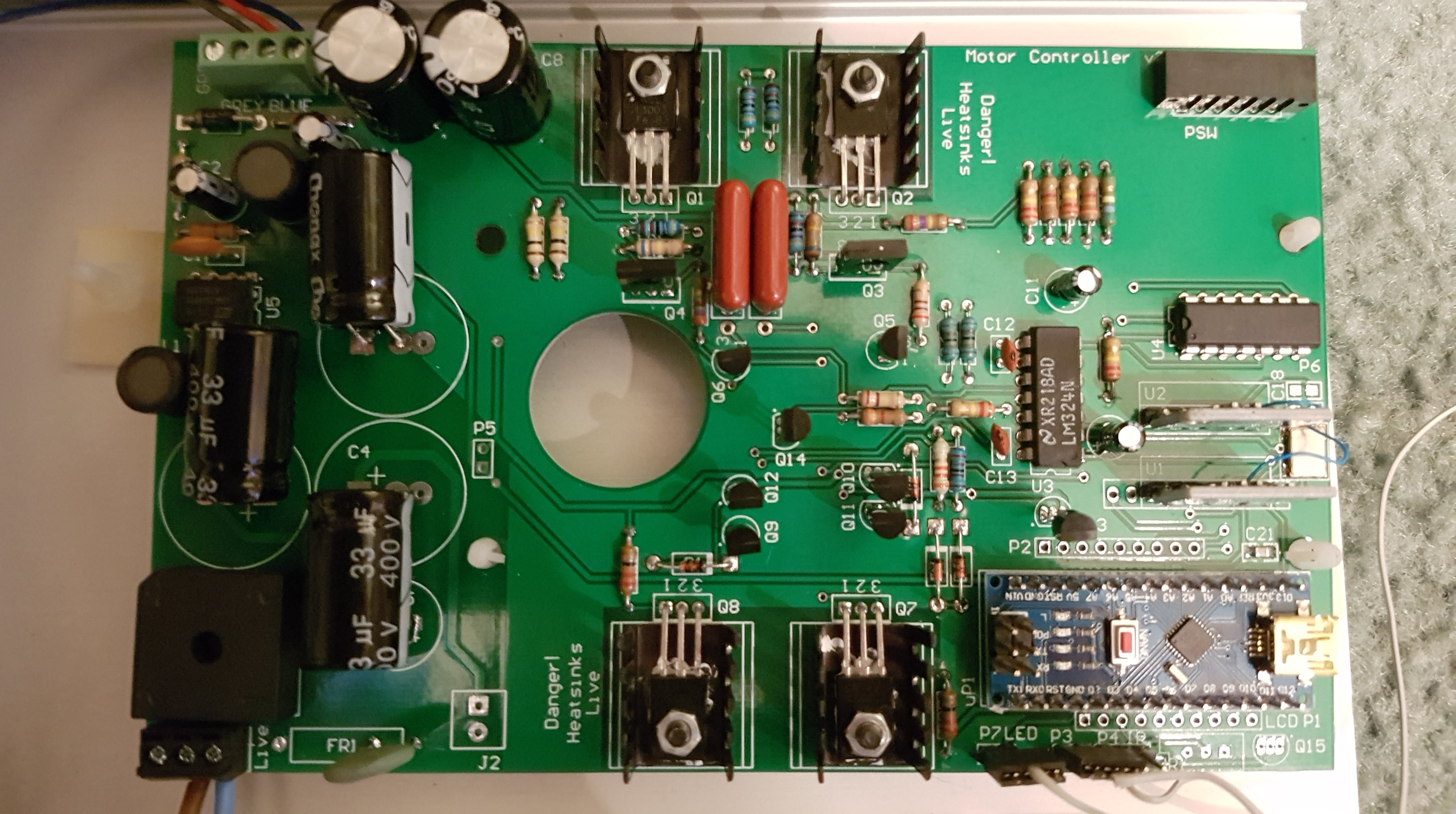

So just an update.
New prototype PCB’s arrived with the re-designed efficient PSU. First prototype built and tested – see picture. No LCD attached at the moment to this one as need to wire that up. Software in a more or less ready state. Its working both as open loop and with PID control. I want if possible, to add auto-tuning for the Kp, Ki, Kd parameters as they can be quite fiddly to work out manually. The PID control loop achieves full stability after about 20 seconds reading 33.333 rpm but I would like to think I can make this quicker with better tuning. I also need to test 110V operation and trying to find smaller height PSU capacitors so they don’t need to be mounted on their side when installing in say a Linn LP12 and replacing a Valhalla board.
I have also had a request if this board will supply shaded pole motors – the answer is yes but the current board configuration expects the motor to draw about 8mA per winding. So motors with larger current consumption will need larger heatsinks for the transistors and possibly larger output capacitors. Currently testing what’s practical.

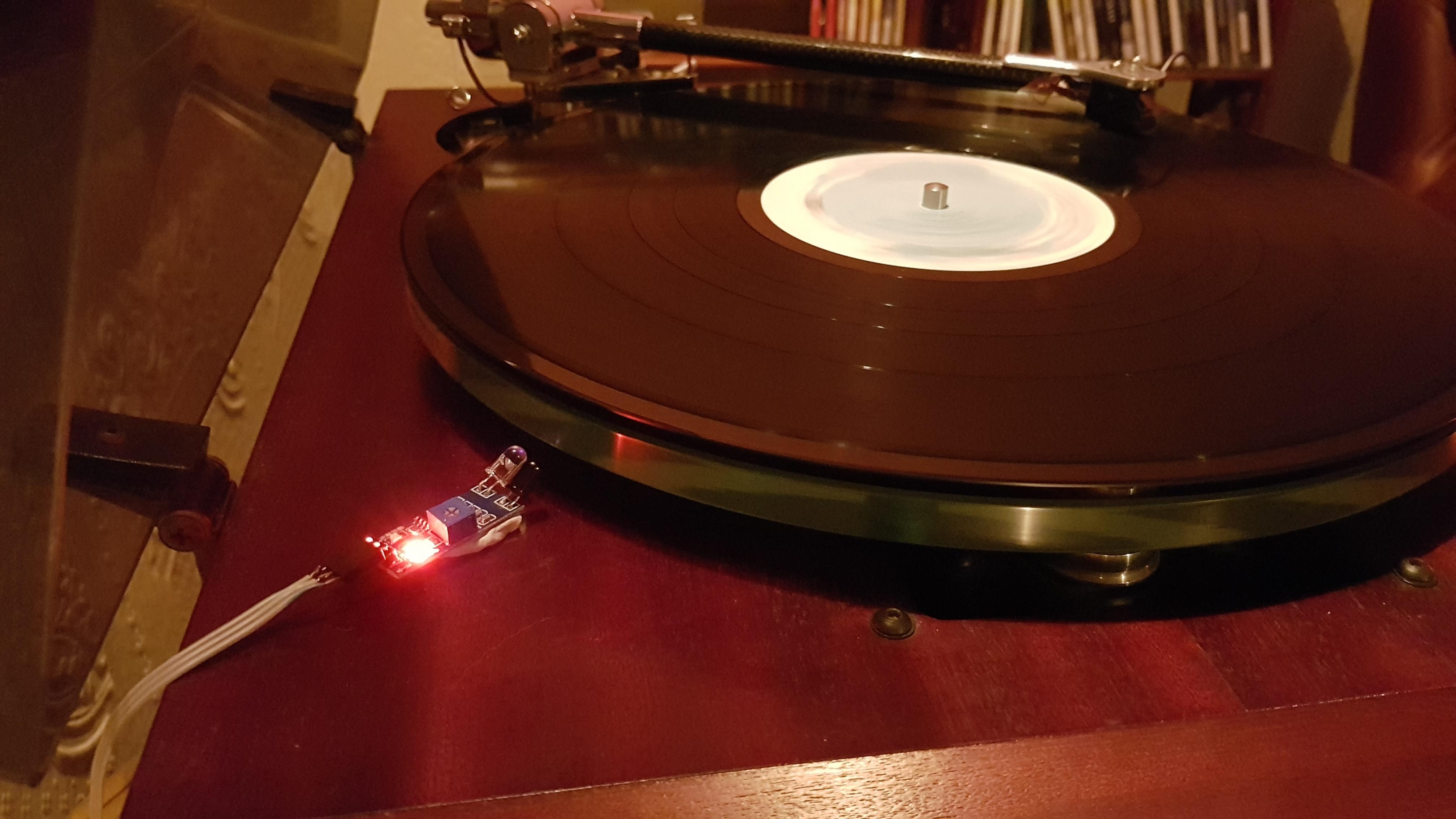

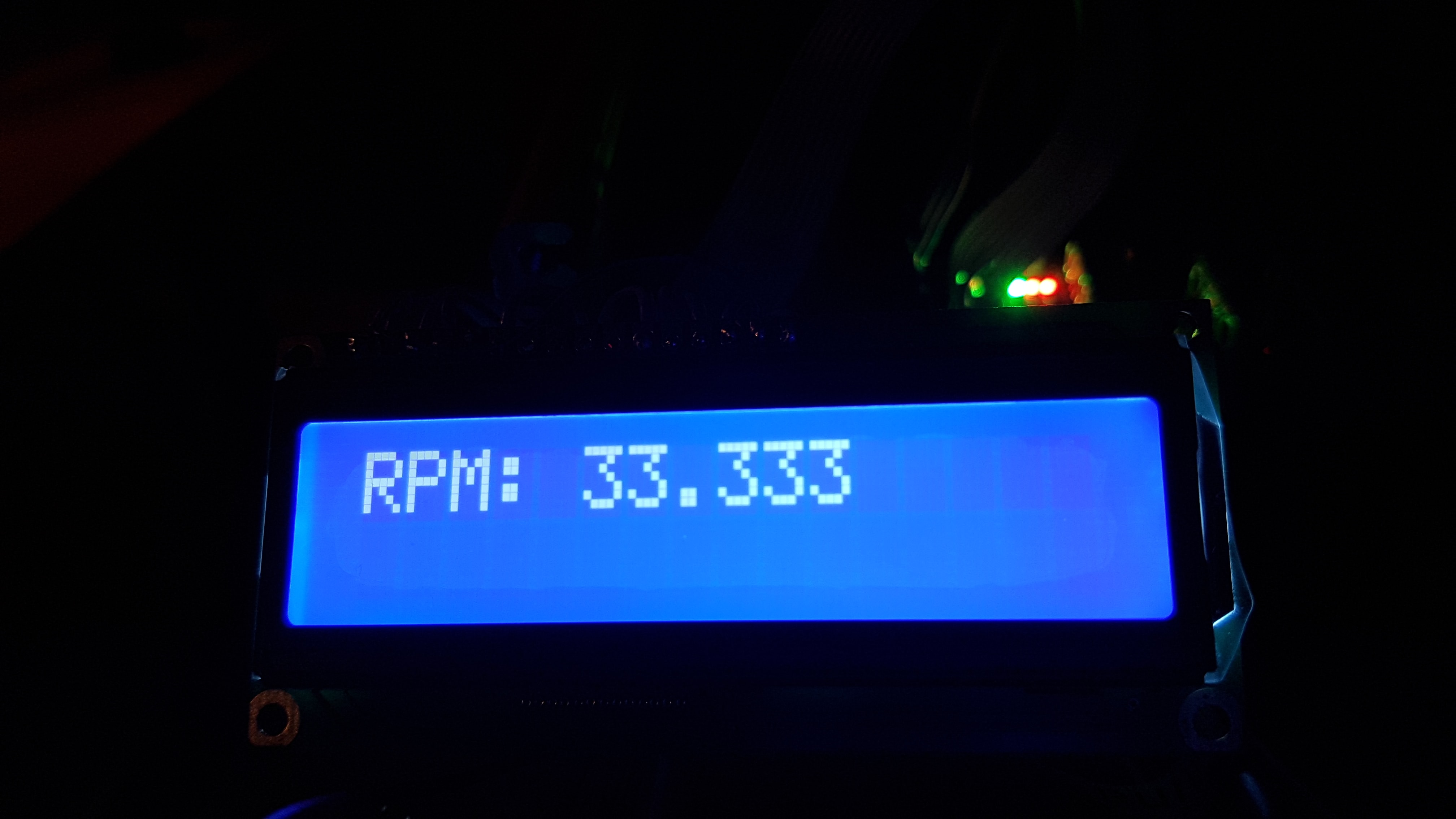

I have also made some progress with my tacho project.
It has now a 3D printed enclosure and the project website is updated with all the details and downloadable cad files so that anyone can download them and build their own 😛
DIY LP Turntable tachometer |

That's very clever! I like it! Just be sure to experiment with damping to see if that device or the USB cable dangling from it effect the sound at all. I wonder if a right-angle connector is available for that cable to reduce strain on the jack too. I really do like that approach overall, though!
As I mentioned in my project website I'm looking in to a design with a thin and flexible USB power lead that is fixed (like direct soldered to the Arduino PCB) and will exit at the plater side of the display casing. This way it will be possible to route the wiring underneath the platter an slip it between the cover and plinth at the back of the TT to make it neat

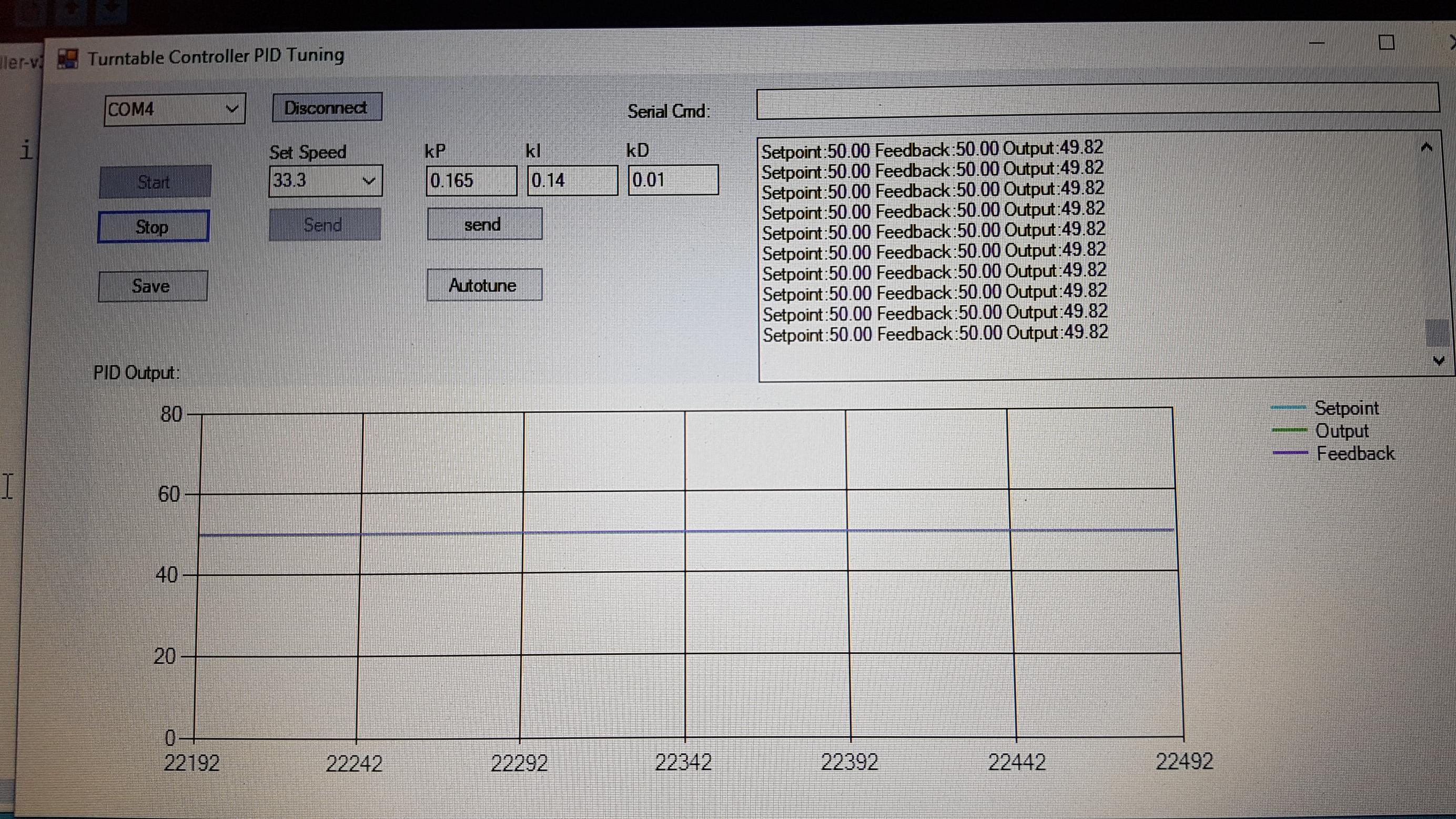

Well the turntable controller prototype is debugged, tested and finished.
A couple of screen shots below showing the sensor (which needs a nice enclosure like Greggan has made), the LCD showing measured speed locked at 33.333 rpm and a picture of the completed PCB. I have my PCB mounted in a separate enclosure. I am using the Linn Valhalla switch to control but it can be any switch (there are separate connectors on the PCB). Electronic switching up to 45 rpm works fine.
I am planning on making this a group buy if anyone is interested. Options will be a 1) bare PCB with pre-programmed arduino nano, 2) bare PCB with pre-programmed arduino nano and a full kit of parts, 3) fully assembled board.
The board can be used without a sensor to provide stable 50 / 67.5 Hz, with sensor just to read tacho speed, or full PID closed loop mode where the motor speed is adjusted based on sensor feedback. (The PID tuning is a manual process as I have not been able to make the autotune routines produce good results. However, I have a procedure for determining the Kp, Ki, Kd PID parameters manually).
The design is a drop-in replacement for the Linn Valhalla but will work with any turntable using a synchronous aka Airpax, Premotec, Philips motor 9V – 115V.
The board will work 110v – 240v and drive 2 phase motors. By daisy chaining a second board (less PSU, LCD and arduino components) 3 or 4 phase motors can also be driven as long as they operate on 9v – 115v RMS at about 10mA max per phase.
