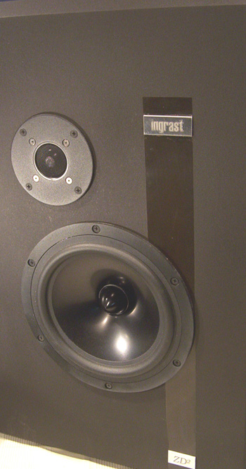

Yes, the project is going on. Attached are some shots, and I will be posting more soon.
At the moment I have 2 boxes working and have accumulated about 50 hs. of listening time with different material from classics to rock, and am quite satisfied. I will be presenting them for evaluation to knowledgeable people to get impressions and critique.
In the next post are the measurement results.
Rodolfo

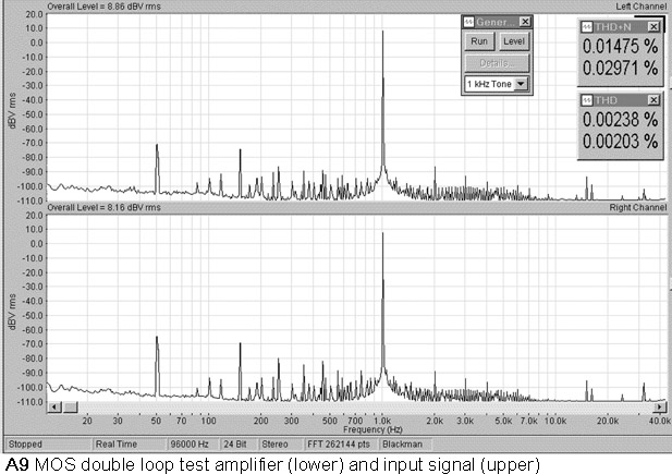

These are measurements performed on the prototype amplifier.
Due to differences among the audio nboard right and left channels, it seems amplifier output has actually less distortion than the input signal !. Of course this is not so, but underscores the fact the amplifier contribution is about an order of magnitude lower than the measurement baseline.
Rodolfo
