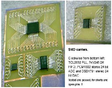

Progress report
Apologies for the poor images, the camera on hand does not focus closeup and I had to hold a magnifier glass in front to barely snap something.
SMD carriers are ready and devices soldered and tested OK.
Will now build mainboard.
Rodolfo

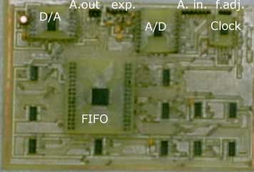

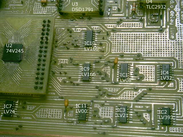

Digital delay progress
After some weeks pulling time to work on the project, the basic module is mostly assembled except for the output current to voltage converter.
Power has not been applied yet, so the magic smoke allways packed inside each electronic component has not been released😀
Apologies for the phono quality, will try to upgrade to a better camera soon.
