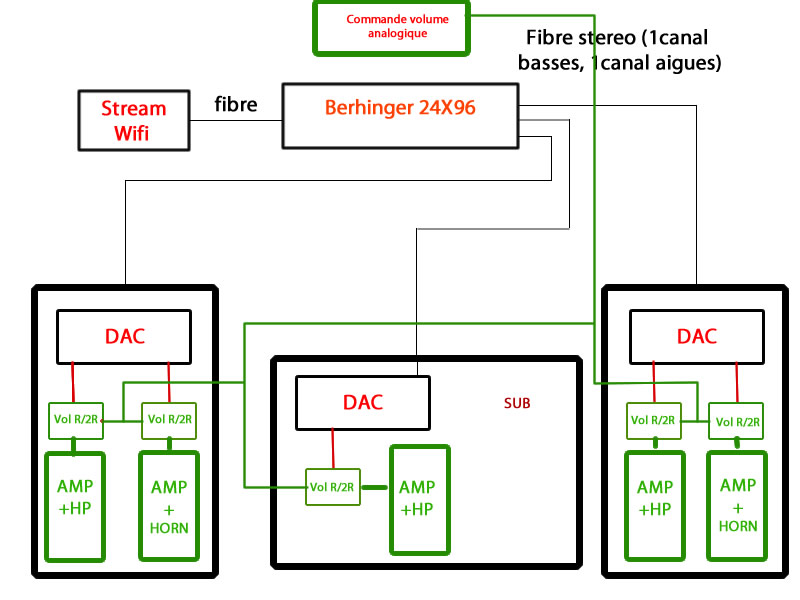

I'm looking for way to mix two mono digital outputs in the DCX to a stereo one, the target is to have the canal left transmitting the basses and the right the treble ? One link, one DAC for one speaker's enclosure.

If I understand correctly - the DCX only has analog outputs, but you want digital outputs after the DSP?
It's in theory possible. You would need to tap the I2S or TDM pins that feed the AK4393 DACs and add a small PCB with an SPDIF transceiver or some other method to drive a long cable. I have no idea if you could easily fit it or if there are test points to make it easier.
Yes, (Thanks chris719), but a little more. I would like to can send after the DSP that is used as an active filter, in one single optical link the bass and the treble of one of the input stereo channel for they can be decoded by a simple standart DAC in my speakers enclosures: left basses, right trebles.

The idea is to have no grounds leakage between the speakers and the sources.

Does the DCX already output your bass to left and treble to right channel analog outputs?
If so, then you only really need something like one TI DIT4192 or AKM AK4104 for each pair of channels.
http://www.ti.com/lit/ds/symlink/dit4192.pdf
See Figure 14 to see how it's interfaced with a Toslink transmitter. You'll also need a simple microcontroller to configure the chips. I don't know if there are any that are still in production that are controllable via hardware without a I2C or SPI interface.

Yes, this is also what I suggest except he's using CS8404 which is obsolete. Helpful that he's already identified where to tap. There are 3 AK4393 DAC chips. They are stereo, so 6 channels total. You just need to bring the master clock, bit clock, word clock, and data signals to each SPDIF transmitter. The Toshiba TOTX173 is also obsolete, but I believe there is an alternative that is still available from another company.

And then the optical fiber you are thinking of is standard TOSLINK, or something else?
If TOSLINK you will probably be limited to 24/96, although 24/192 might barely work. Also, you might want to do some processing to remove jitter picked up along the way using the (TOSLINK?) optical interface.

Toslink seems to be the easiest way, don't you think? (DCX is 24/96)

The ESS Sabre DACs have an internal ASRC to attenuate incoming jitter. Usually sounds best if the jitter is very small to begin with since otherwise the DPLL bandwidth will have to be left at a wide setting (assuming there is any user control of it). Lowest possible DPLL bandwidth sounds less distorted, and ESS recommends to set it at the lowest stable value. Most Sabre DACs leave it set at the default, unfortunately (seems to me anyway).
The other main alternative for jitter suppression would be an ASRC chip such as perhaps SRC4392 or AK4137, possibly used along with a AKM DAC chip. Possible to use a Sabre DAC after an external ASRC too, but can be tricky for getting the best sound (although Benchmark DAC-3 does it).

It's a tiny FIFO in an SPDIF receiver usually, but it depends on the exact model. It's usually not more than a few samples because no one wants a long delay. The PLL loop filter corner frequency is usually not super low to facilitate quick locking.
IMO this is not a problem like Mark is making it out to be. Jitter is an overblown bogeyman.
I would suggest you use the TI SRC4392 in the DAC portion if you're designing it yourself. It's both a decent SPDIF receiver and ASRC in one chip which will bridge the two clock domains and allow you to use a single local master clock to clock the DAC.
