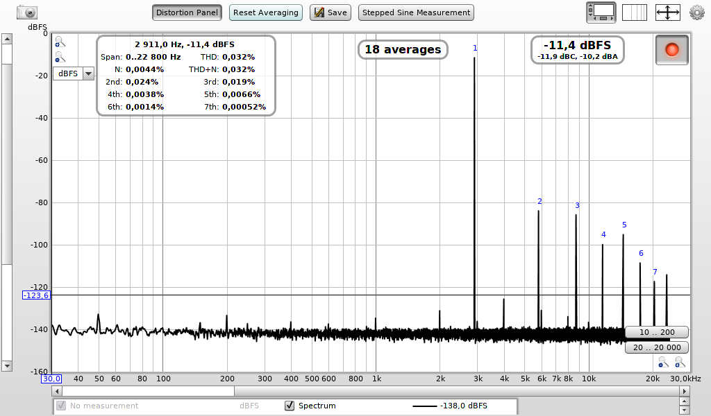

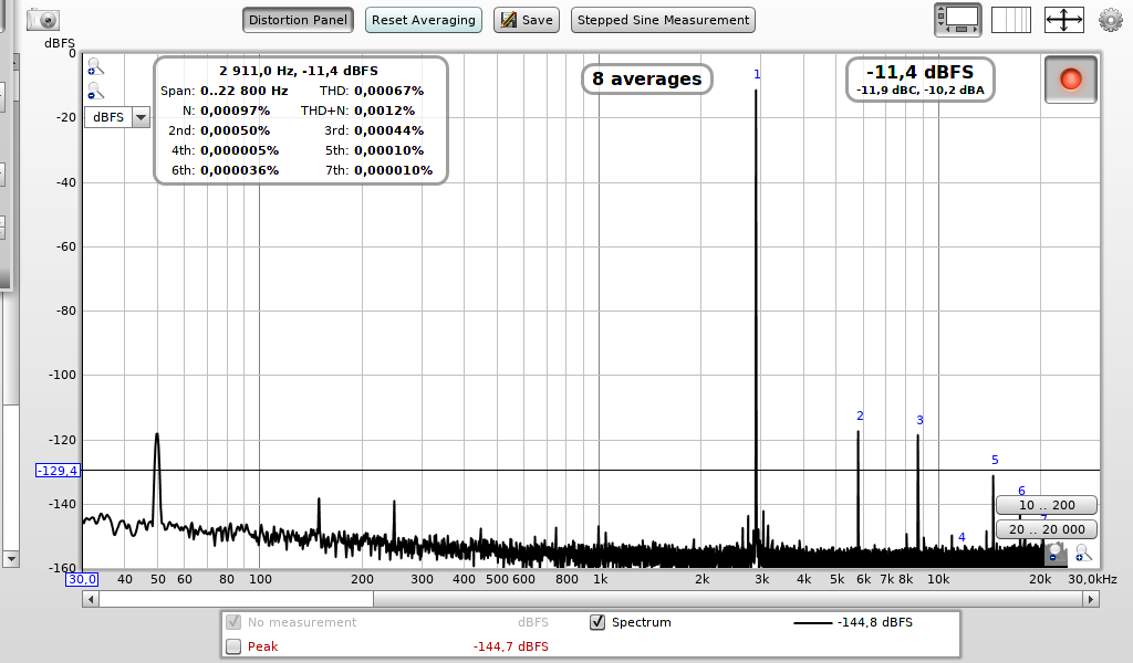

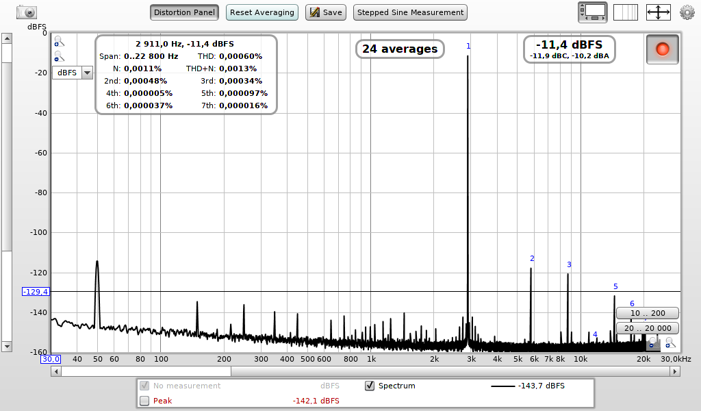

The other "well behaving" 4556 nb. 4:
1) 1x yesterday - 0.00067%
2) 1x - 0.00060%
3) 11x - 0.0059% => 10x
4) 48x - 0.029% => 48x
Also notice how similar the individual harmonics on the 1x screenshots are.

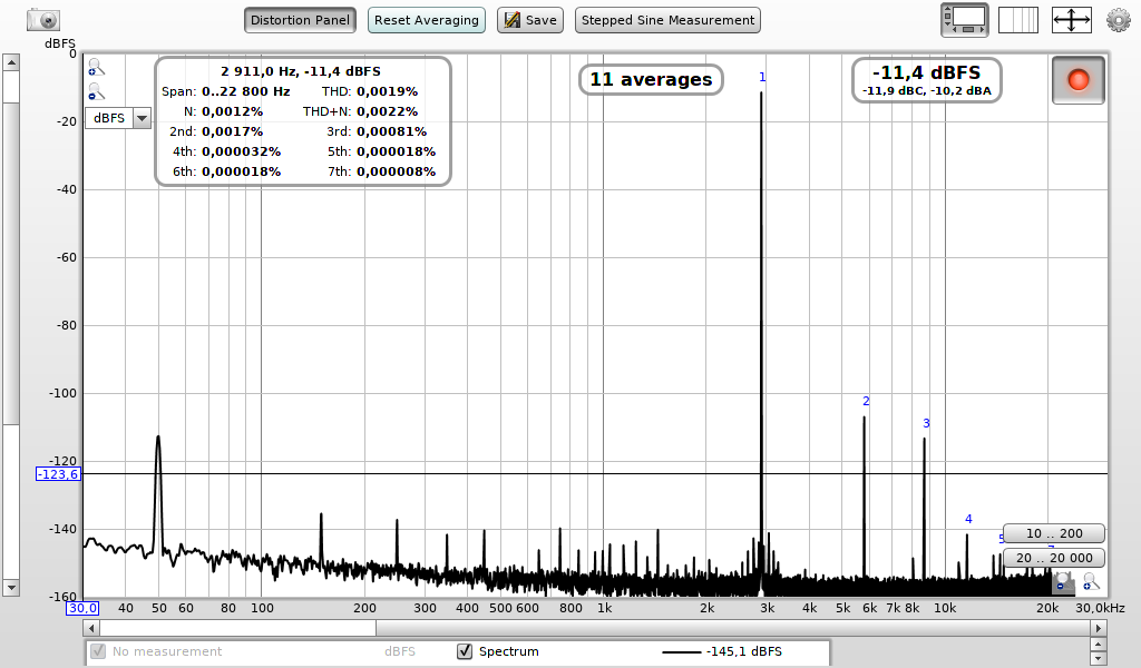

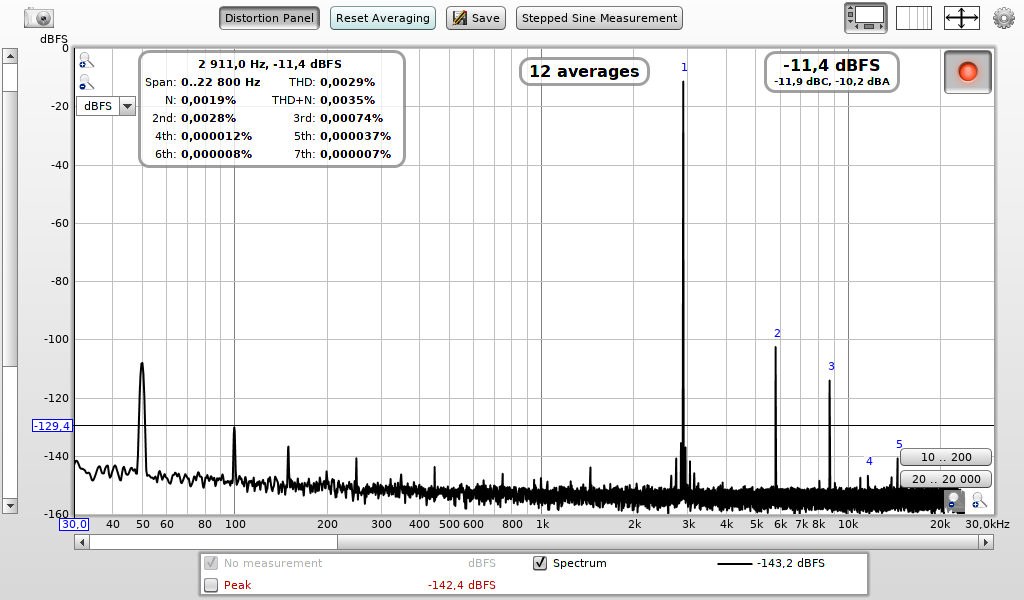

Now 4556 nb. 2. This appears like it has the common-mode distortion somewhere around 0.00015% and the remaining distortions being majority of the distortion profile. I do not know.
1) 1x - 0.0019%
2) 11x - 0.0029% = 11x 0.00015% + 0.0012%
3) 48x - 0.0085% = 48x 0.00015% + 0.0012%

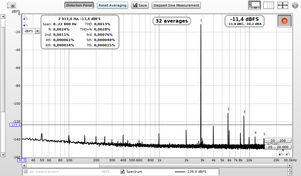

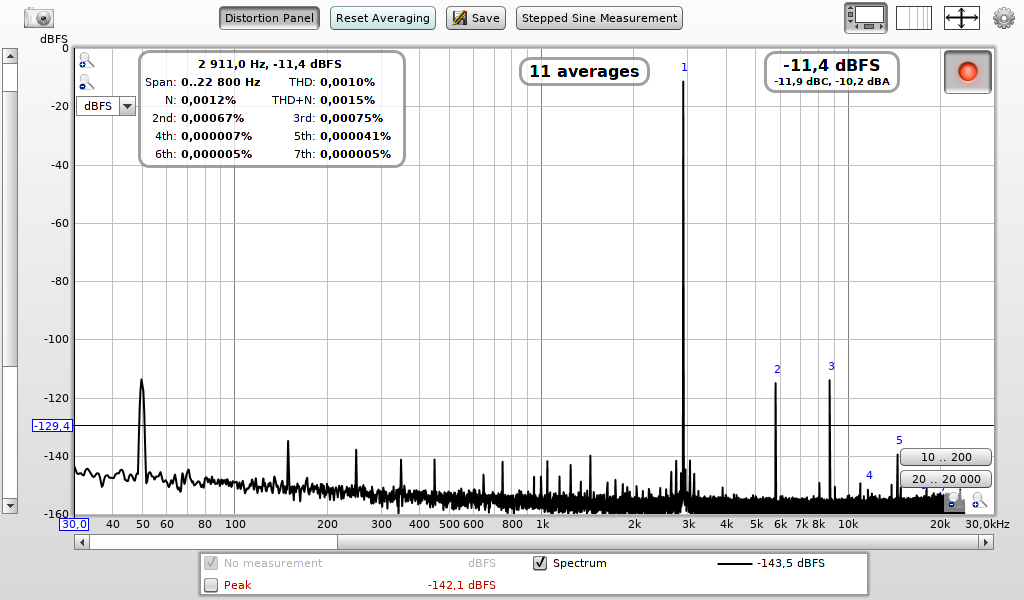

The remaining 4556 nb. 3 behaves differently. Measurements are identical from yesterday.
1) 1x - 0.0010%
2) 11x - 0.0019%
3) 48x - 0.0098%

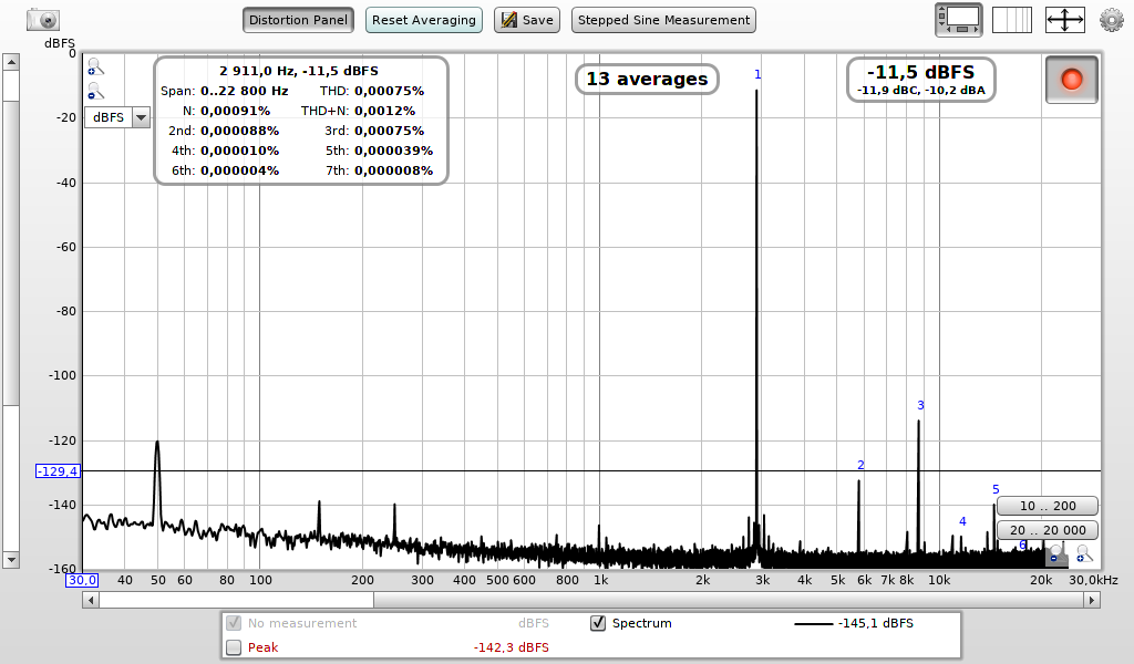

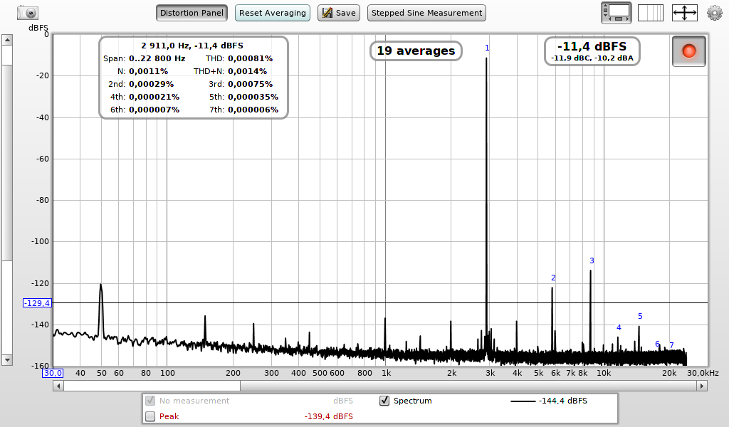

The 5532 displays a similar pattern - nonlinear increase in distortion
4) 1x yesterday - 0.00075%
5) 1x - 0.00077%
6) 11x - 0.00081%
7) 48x - 0.00130%

One thing I have noticed. The two "well-behaving" 4556s (1, 4) have a clearly higher noise floor at 48x than the two "non-behaving" 4556s (2, 3).
Also their overall distortion at 1x gain is much lower, but is attributed almost completely to common-mode type. The other two start at higher distortion which grows much slower and at 48x ends up way lower.
They behave a bit like two different chip groups. But 1, 3, 4 are labeled JRC and look the same, 2 is some generic RC4556.
If I were to measure all 4 opamps with the high-gain method, I would pick 2 (0.0085%) and 3 (0.0098%) as opposed to 1 (0.032%) and 4(0.029%). Yet in no-gain scenario the winners are the other way round 1, 3 (both around 0.00060% ) vs. 2 (0.0019%) and 3 (0.0010%).

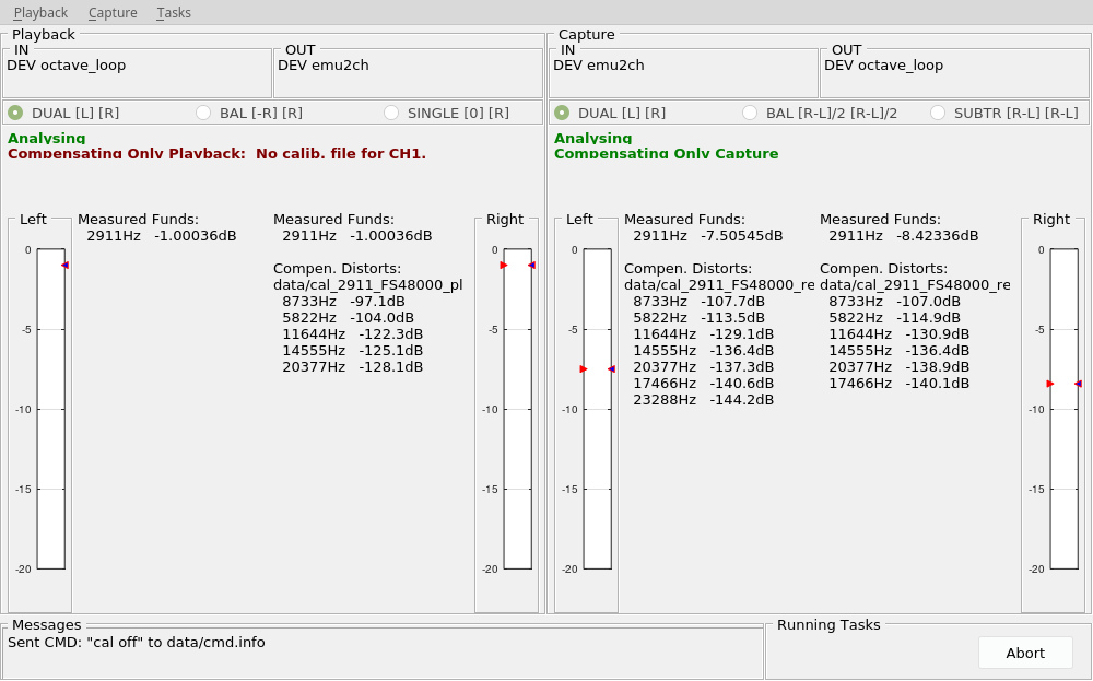

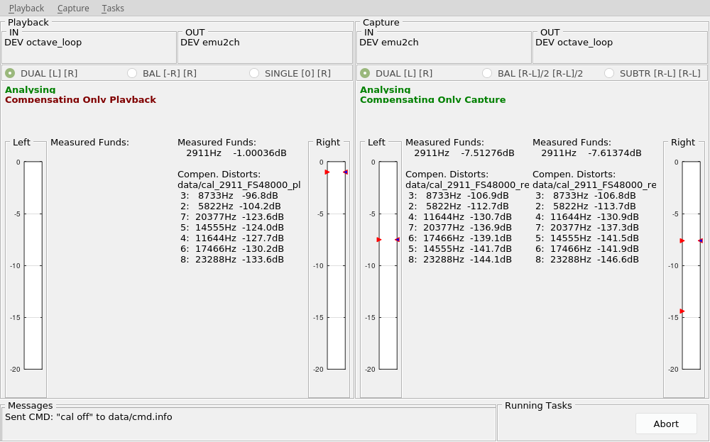

During measurements the tool has compensated distortions on both sides. The right channel on capture side was used for measurements, the left channel keeps receiving full output signal to preserve the same conditions as during the calibration.
After swapping each opamp the recording side was quickly recalibrated to make sure all opamps get the same conditions. Since all opamps had same output level, no multiturn-pot adjustments were required, calibration was just a matter of flipping the in/out switches and selecting the "Calibrate capture side" in menu - 4 seconds in total. The playback side was split-calibrated only at the beginning of today's measurement session.

My 2 cents the opamp nb. 3 labeled JRC 4556 yet displaying very similar characteristics to the nb. 2 labeled RC4556 is a fake, relabeled chinese RC4556 as brand JRC.
The RC5534 is vintage Raytheon from the time that they (Raytheon) had their own selection and branding specs for vendors. They are screened for MilSpecs. I have a few RC5534's and they are definitely no fakes.
But your findings are very intriguing, I have no suggestions to offer, unfortunately.

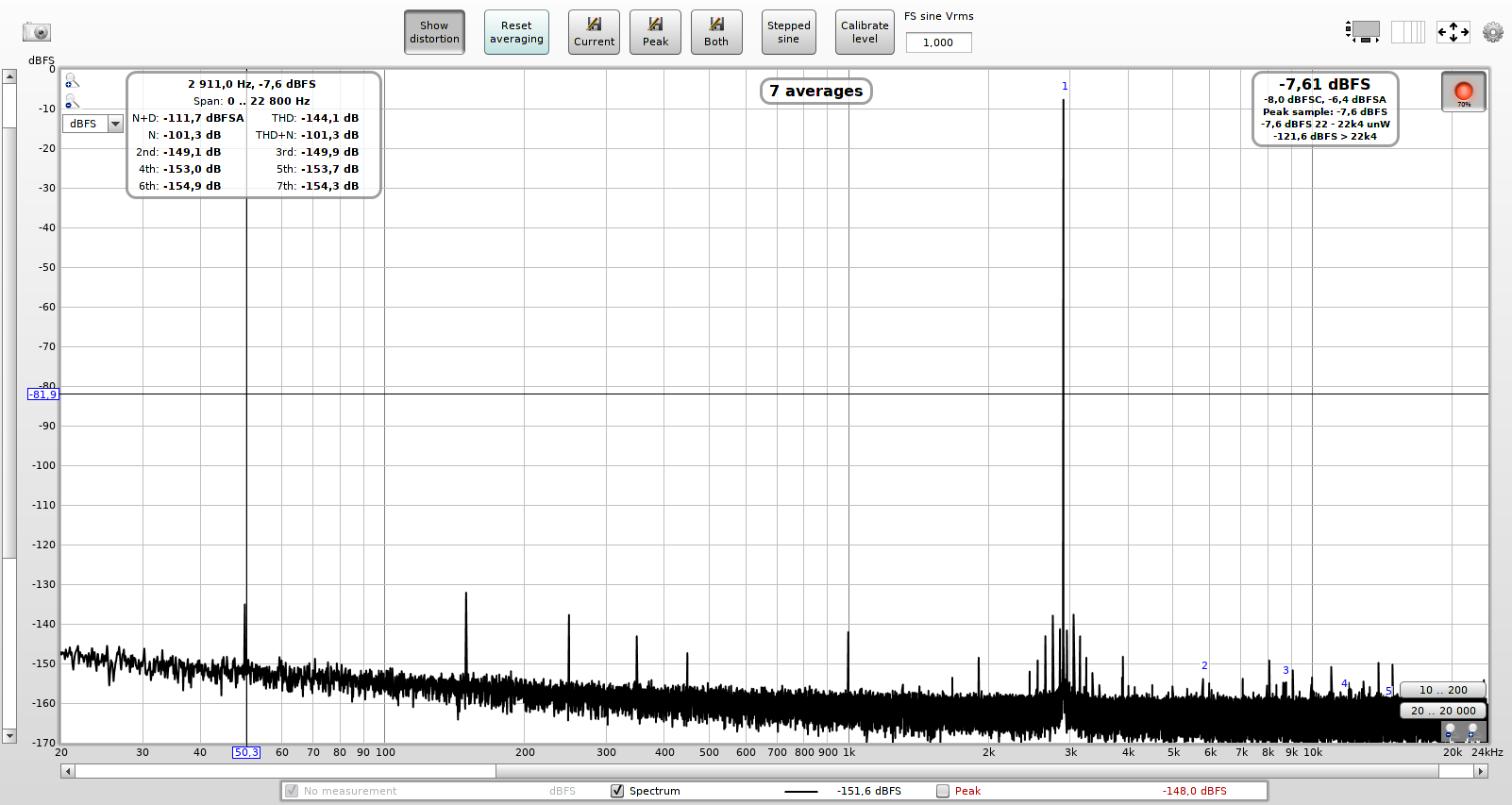

In all the systems I have tested keeping the level at -15 dBFS gives the best distortion results at a cost in SNR. Also, when dealing with such low distortion levels, using dB instead of % really helps reduce confusion. Counting zeros is tedious and error prone. . .
Like this :
These are harmonics. I do not like the forest all the way up to fs/2, but THD as well as THD+N are still within specs of that device. Try to lower the level, this looks like first signs of approaching limitation.
Your E-MU has input amplifier, use it to find out whether it is the DAC or ADC side which starts limiting.
The joint-sides compensation will clear these harmonics but 20th+ harmonics of 1kHz are very attenuated in the LP filter, lowering the split-sides precision so far from the fundament. Also measuring the LPF&VD transfer all the way to 20th harmonic takes some time.
But my 2 cents if you lower the level the high-order harmonics will drop significantly.
