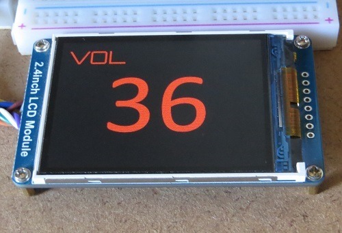

It's rewarding to work on the project with Muses + hi-res LCD screen. I haven't seen any offerings online that does the same. So, are we raising the bar, or what? 😆
This sample screen shows the quality of the display and smoothness of the font. Btw. I can use just about any TrueType font on the screen. The big font used here is Calibri.

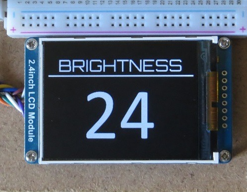

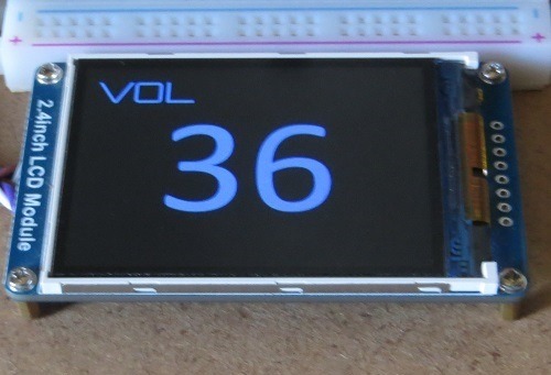

Thanks. It can display other colours too. See pics below. The screen looks so much better in real life. The camera doesn't do it justice.

It's a full colour screen, but I prefer white on black. Colours will be selectable by the user from a settings menu. There is also a function that fades the screen after a certain amount of time has elapsed; The time interval and fade amount is selectable from the settings menu. I did the coding for this while I impatiently waited for the Iron Pre kit to be released.
Btw. I like the volume readout to be a percentage from 0 to 100. Obviously, it can be changed to -dB, but I prefer 0 - 100.
