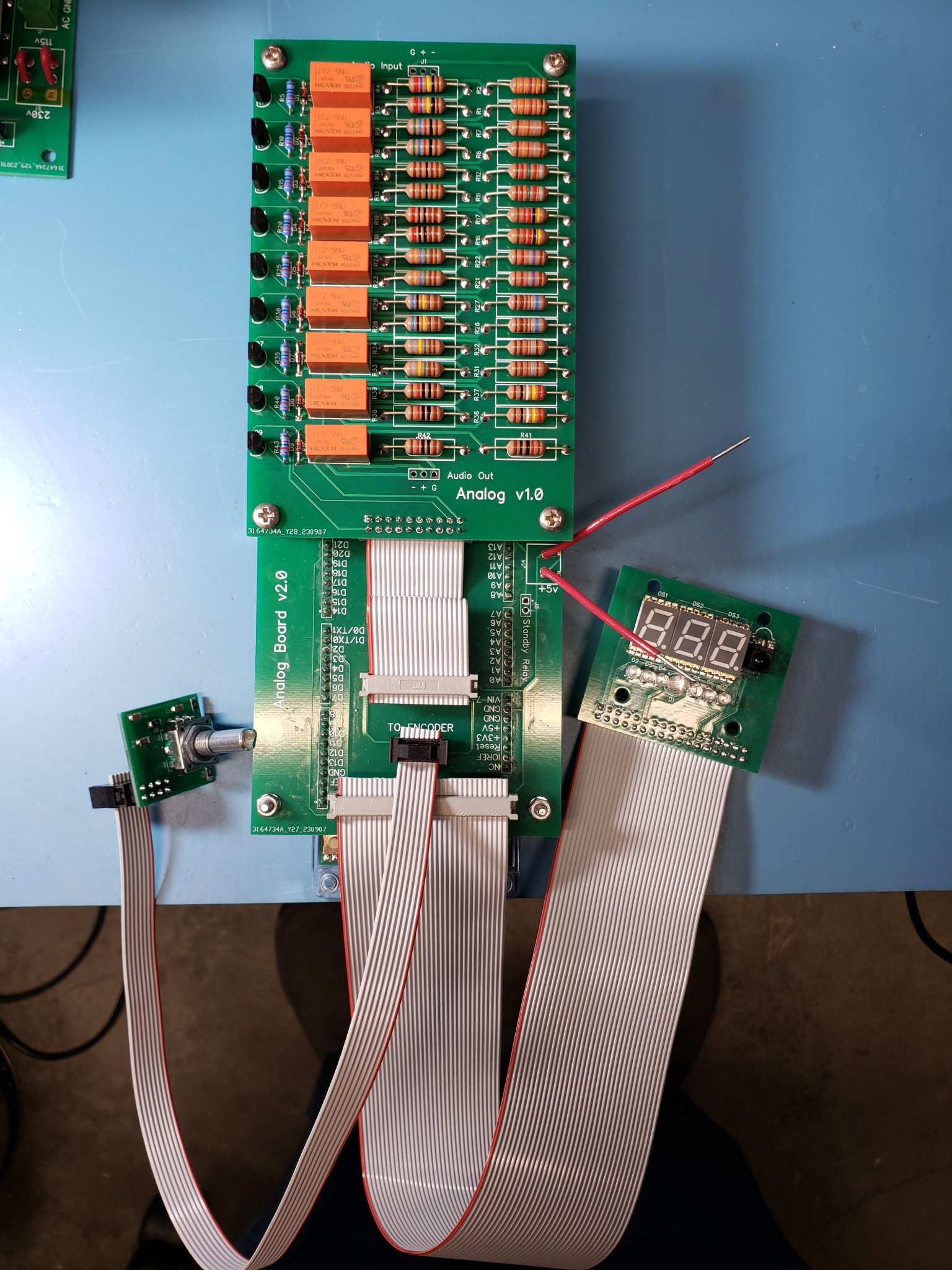

255-step, approximately 0.25dB steps, volume control, mute, balance, input designed by @johnhenryharris balanced or single ended. Uses an Apple remote or rotary encoder for volume, standby power, mute, balance, display dimmness.
https://www.diyaudio.com/community/threads/preamp-control-volume-input-mute-remote.326029/
Input selection board

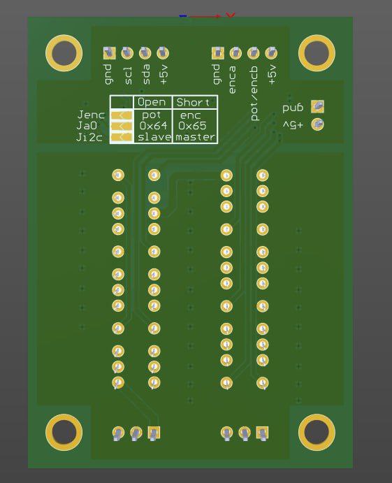

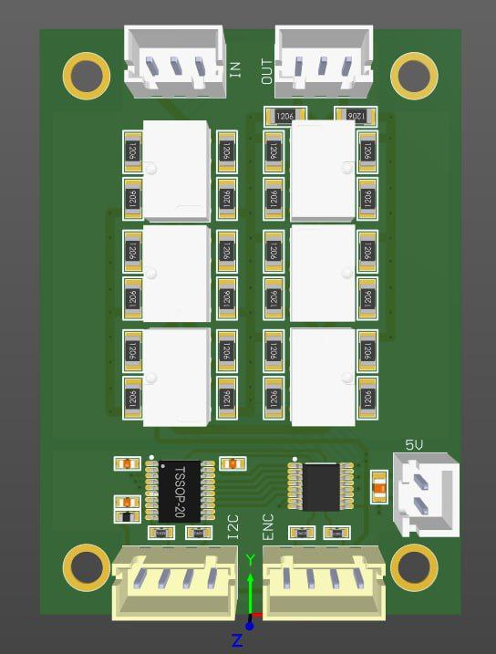

I was thinking about something simple and came up with following design:
6 relays attenuator [0..-63dB]
Three options for control:
1. Potentiometer
2. Encoder
3. External MCU, via I2C
To enable it as standalone module, it can be configured as I2C master and output attenuation level to a display (I'm thinking about ssd1306 128x64 OLED)

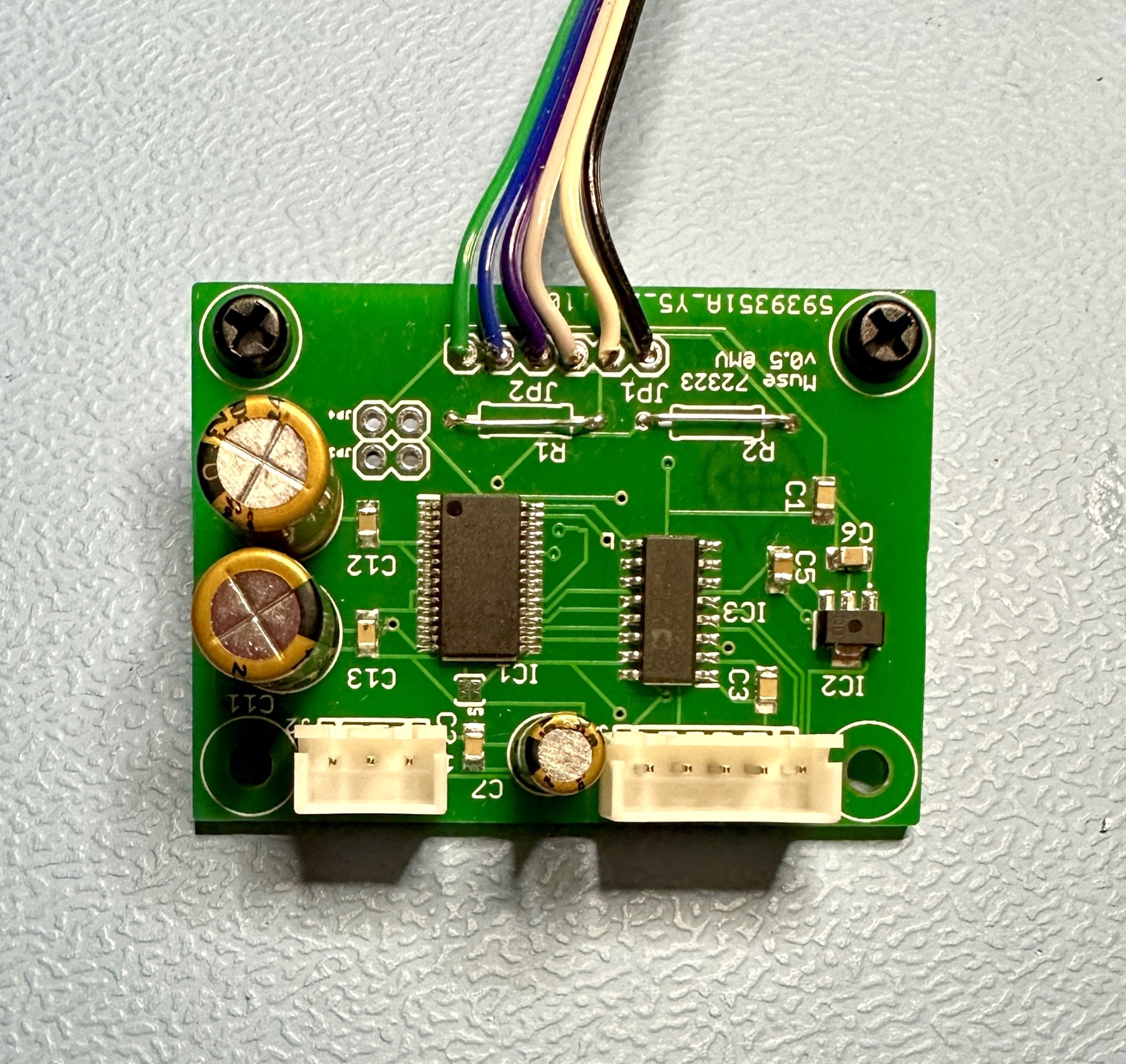

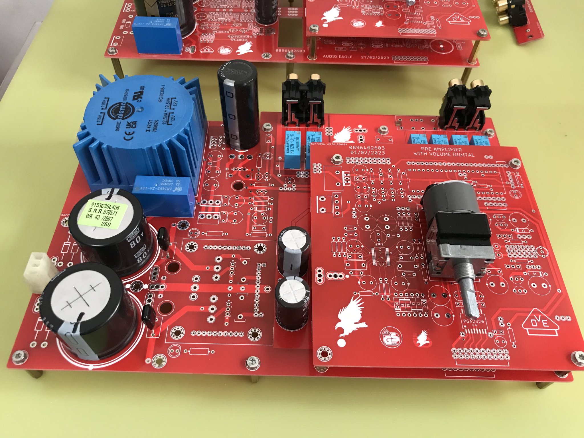

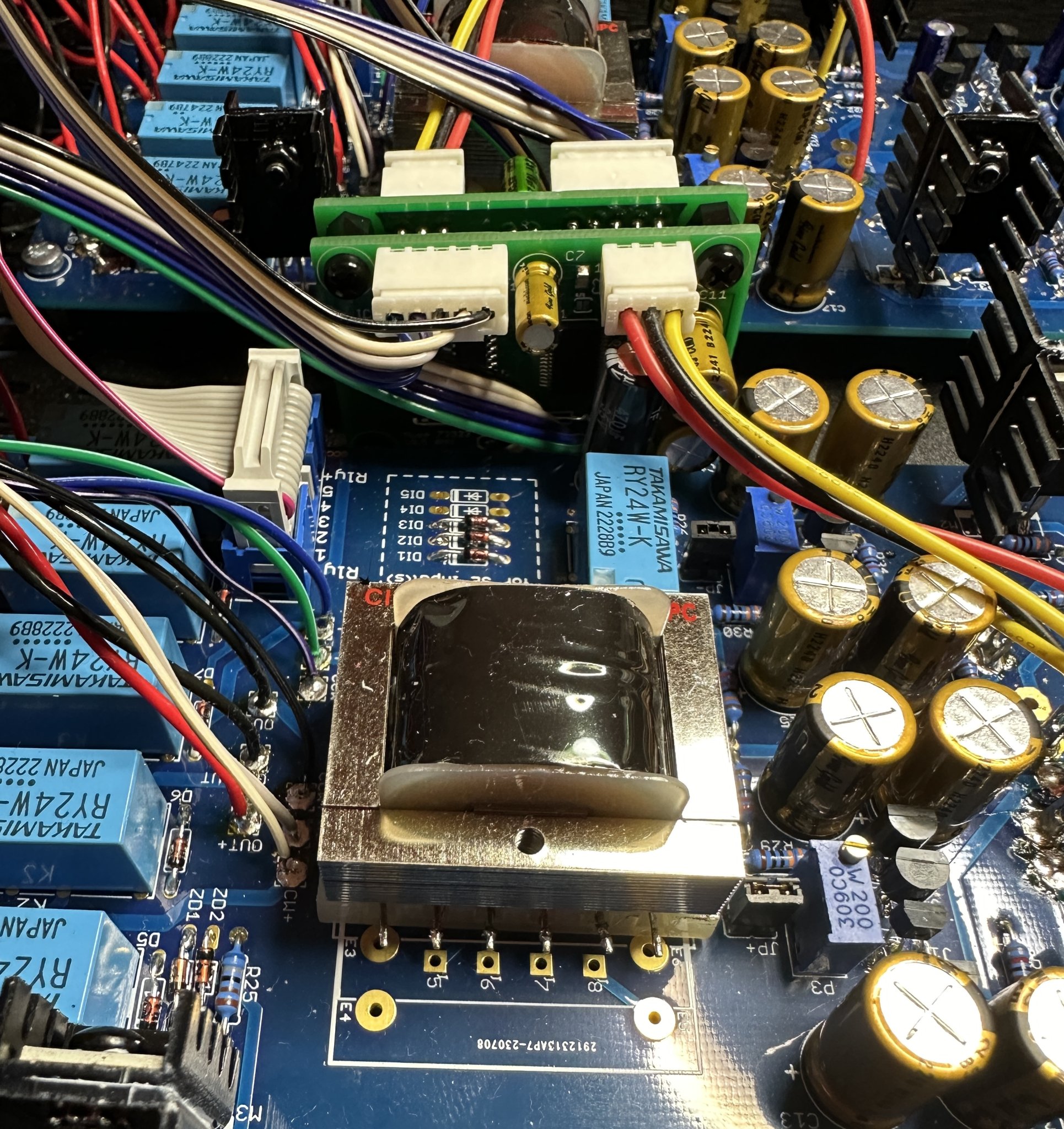

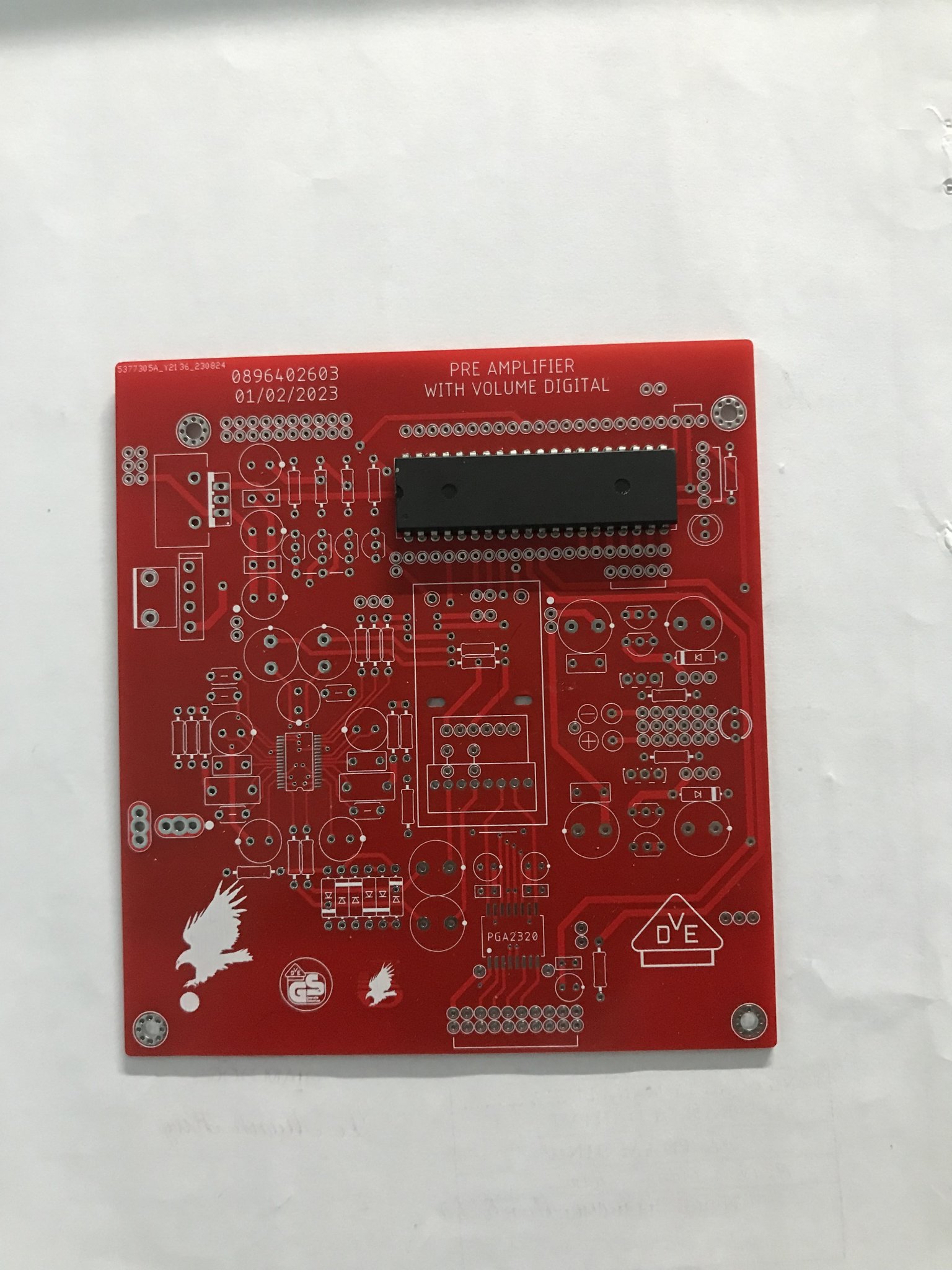

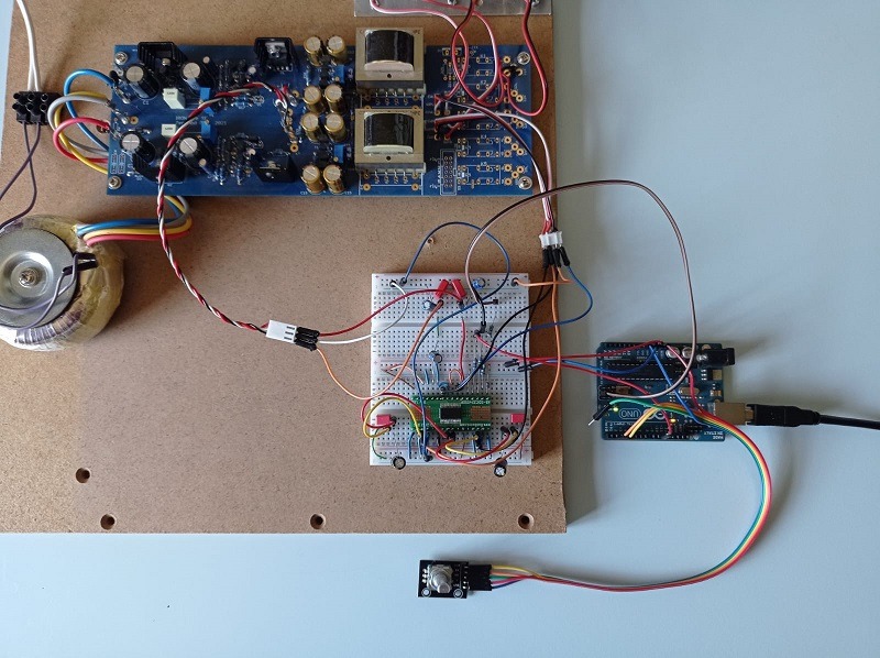

When I finally get my Iron pre kit, I had to decide what to use for volume control.
I found that Muses solution were very attractive and I decided to try it.
Since there where no any non commercial project available I decided to make my own.
Free time is very little so it took a while to get the job done, but here it is.
  • The board is based on Muses 72323 (not the 72320. 72323 is the newer version with better spec.)
  • 3ch ISP Digital isolator on board in order to avoid any noise transfer from MCU to Iron Pre.
  • 5v Voltage regulator on board for the clean side of digital isolator and 72323 digital section.
Board as been tested on both Iron Pre version, SE and Balanced (two board are needed for Bal) and it work very well.
What next?
Now that I have a working Muses board I will make a MCU board for it
In this moment I’m using an Arduino Uno with the code that can be download in the very first post of this thread.
I’m planning to make the MCU board with these spec:
  • At the beginning my intention was to make a board with an embedded microprocessor, but then I changed for a more DIY friendly solution. It will be a kind of hat for an Arduino Nano. The Nano is available with different microcontroller. The basic one is the ATMega 328, but there are others like Nano 33 BLE or Nano ESP 32. All the Nano’s share the same pinout giving the user the possibility to choose a more powerful microprocessori if and when needed. This give the user the possibility, for example, to start with an Arduino Nano and the above mentioned code, and change later with a more powerful Nano, to drive an hi-res lcd for example.
  • Five optoisolated line to control the IronPre input relays. In this way there is no need for separate PS for relay.
  • 1 optoisolated line for optional power on relay
  • 1 optoisolated “trigger” line (to turn on an external device like a power amp)
  • 1 optional front panel button for power on/off
  • Connector for ISP and I2C bus (to drive an hi-res LCD)
  • Rotary encorder
  • IR receiver for remote control
Once I will have the MCU board ready I’ll share it and also start writing a code for it. In the meantime if there is someone that want to collaborate writing the code, I can send an assembled and tested Muse board at shipping cost.
Here are some picture of board and IP BAL under test.
I’m making some aesthetical change to the board and next week, once I will get the new ones, I will publish the Gerber files.
By the way, any comment or suggestion is very well welcome.
Michele
