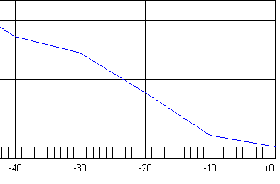

Thanks for putting up the link to those measurements because it illustrates the graph I was referring to earlier. Here's the relevant section of the THD+N vs level plot. The top of the window shown is 0.01% or -80dB for this figure, vertical scale 5dB and across the screen heading to the right is the level increasing:
Yeap.
Same with THD vs level, there you can add the input level (horizontal axiss) and the measured THD+N to get the THD+N relative to full scale. As an example at -60dBFS the THD+N is -70dB, so the THD+N relative full scale is -130dB.
