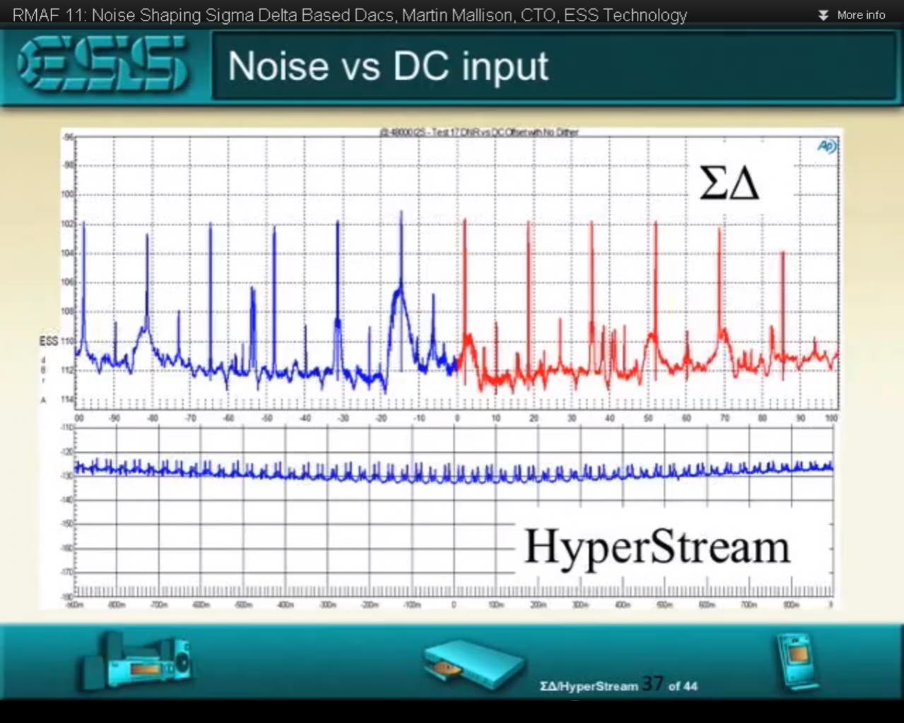

apart from ESS who indicate how SNR changes with DC offset if I recall correctly
Look at graphs from ESS OWN presentation. Look at db scale on SD vs Hyperstream. Do someone actually notice this???!!! With same scale the graph will look +- the same. Now tell me something about ESS credibility. Do you think this is correct way to presents facts?
Ah that's a very good catch yeah - the scales are totally different - 10dB per div on the bottom one which is supposed to be 'good' and 2dB on the top one. But the overall level of the ESS is much lower. I agree, comparing two graphs with substantially different scales is calculated to mislead.
