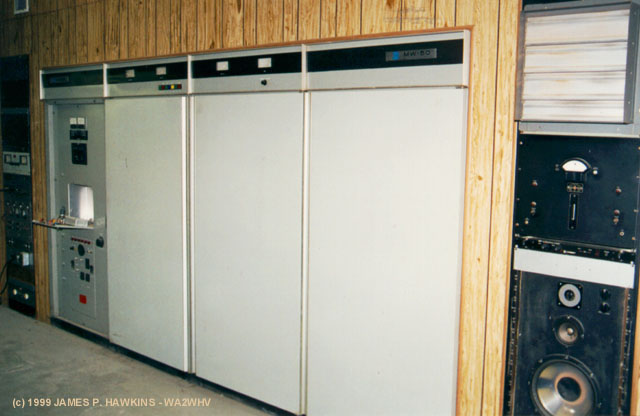

Never claimed that it is, quite the opposite. My first significant experience supporting an analogue PWM amplifier similar to the one below included a 20 kV, 100 kW power supply and operated at 800 kHz.
Otherwise we appear to be in substantial agreement.
