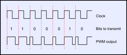

That's what I don't get either. Revisiting this graphic it appears to be a perfectly valid time multiplexed representation of 1100010 = 98.
You also prefer to fight straw man? Where your opponent saw that PWM can't be digital signal in general?That's what I don't get either.
How this 98 is related to the PWM output of a switching power amplifier or a topic of the discussion?Revisiting this graphic it appears to be a perfectly valid time multiplexed representation of 1100010 = 98.

Using pulse width (an analogue quantity) to indicate a binary value is not fundamentally different from using voltage (an analogue quantity) to do the same. In either case if the width/voltage is greater than some threshold then 1 is read; if less than some other threshold then 0 is read. Using an analogue quantity to indicate a binary value is how digital works. This does not mean that anything which uses a pulse width or a voltage is necessarily digital. On the contrary, it is only when there are thresholds etc. that it is digital; everywhere else (including Class D) it is analogue.rdf said:That's what I don't get either. Revisiting this graphic it appears to be a perfectly valid time multiplexed representation of 1100010 = 98.
