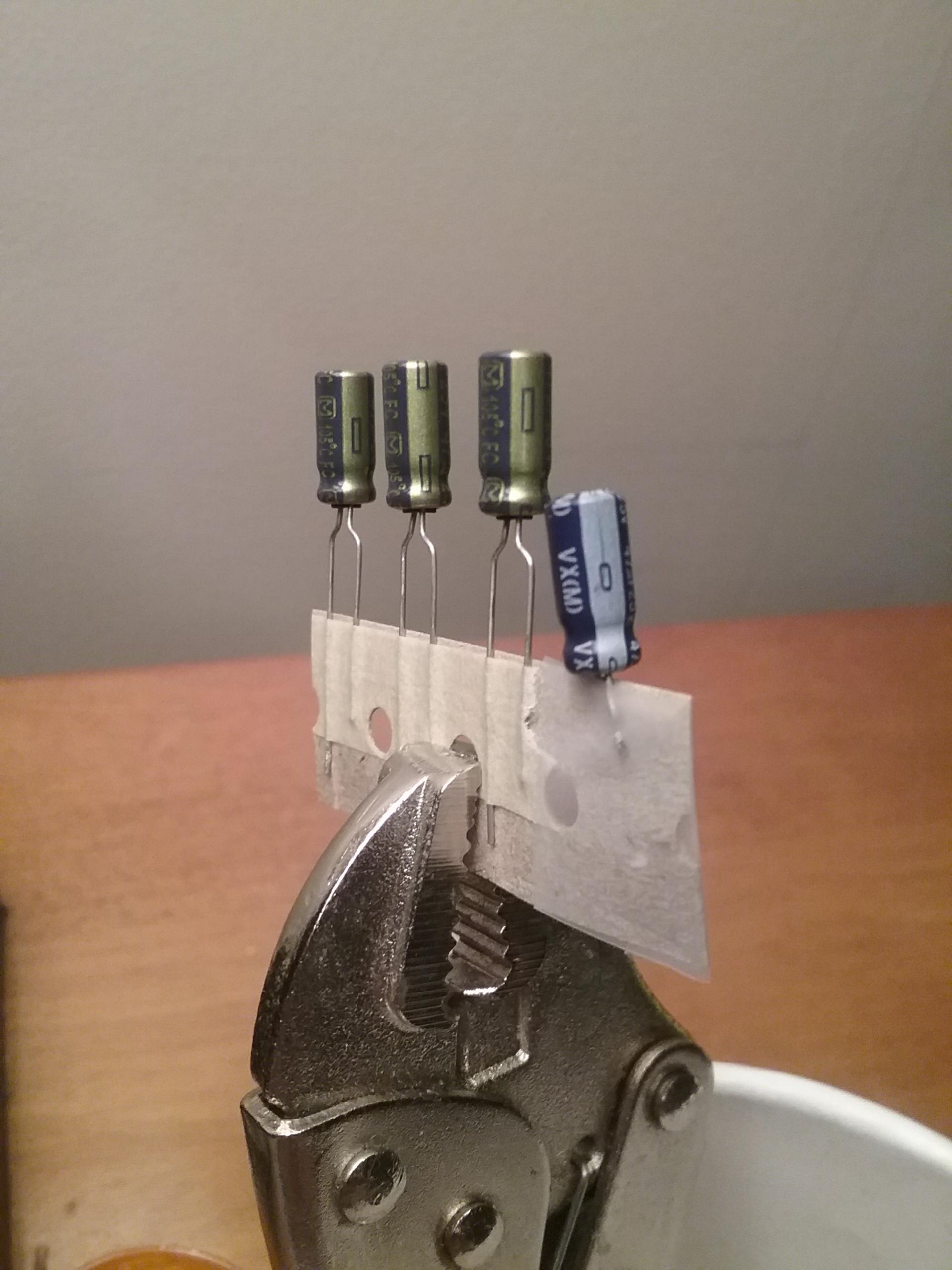

I replaced C2521 47uF. The machine doesn't seem to recognize a disc has been inserted.

I replaced it because my unit had a problem, and I had read that this cap causes trouble.
The original blue cap had the gray stripe closer to the edge of the PCB, so I oriented the new cap's green stripe the same way.

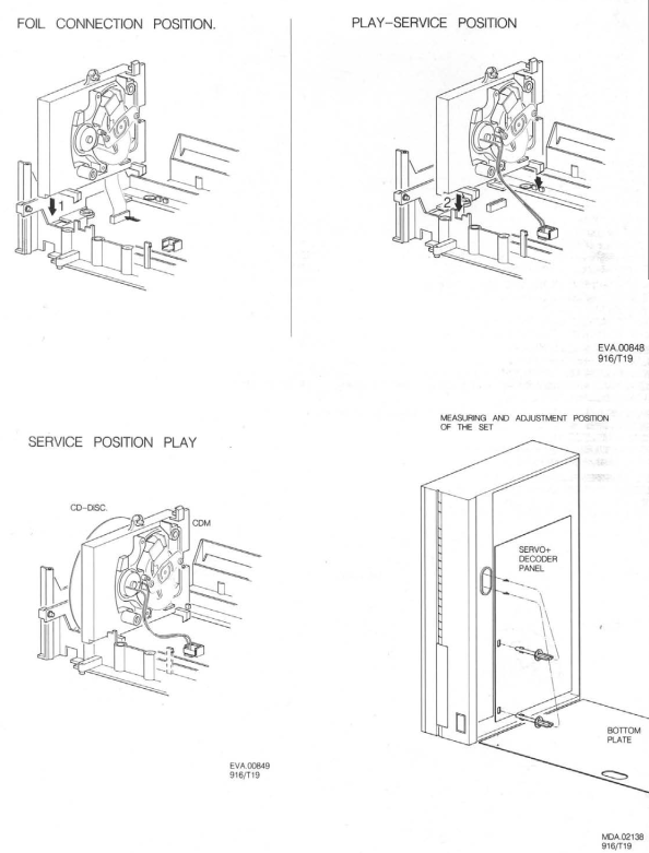

It may be that the combination of mounting and tilting the unit as in the picture makes the CDM mechanism level.

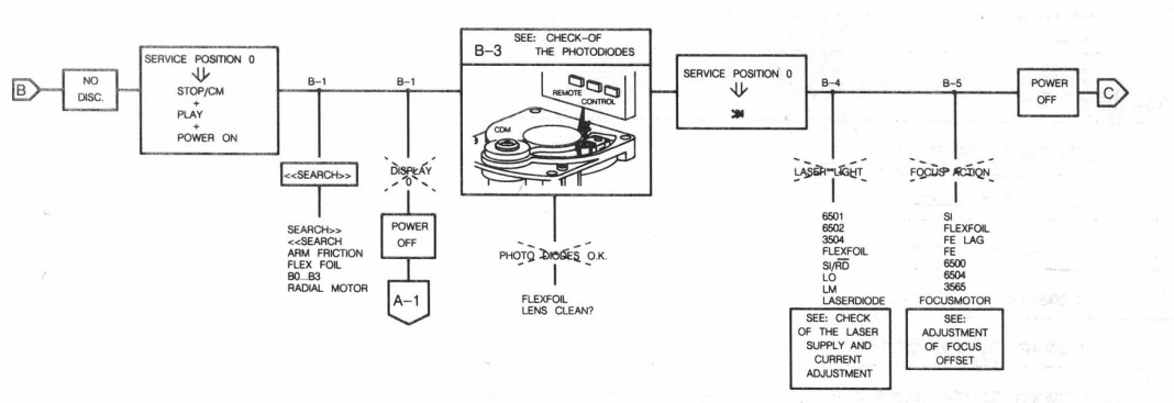

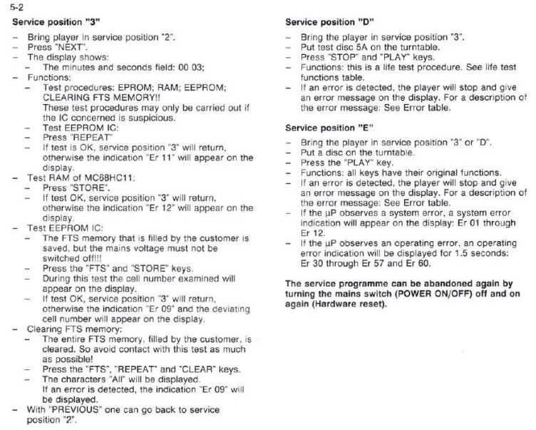

@bajjisw I have been through the entire SM, numerous times. The Fault Finding Tree calls for Service Positions 0, 1, 2, and 3, yet nowhere does it depict them.

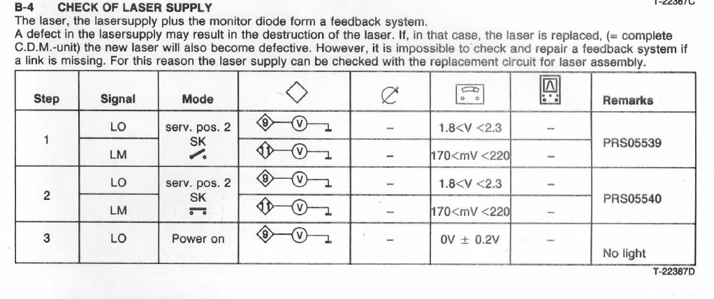

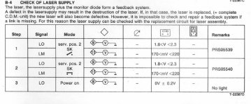

I have attached a section of the Tree. The remainder of the tests require two Philips Test Discs, which cost $200 and $250.
I have also attached a portion of the SM from a different machine, which would be more helpful to someone at my level.
