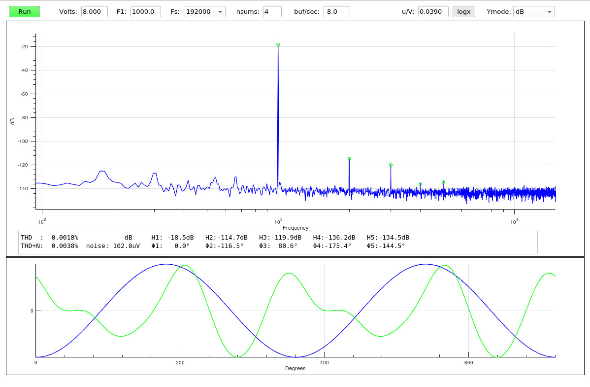

Let me explain how averaging works and why "sample rate is whole multiple of frequency"should be avoided.
Input samples are mapped into a fixed interval, ranging from 0 to 2pi (by means of modulo 2pi arithmetic).
In order to make this stream of data manageable, this interval is subdivided in 1024 bins (actually an array 1024 x 80 bits) and each sample, after the fundamental has been subtracted (leaving only the residual), is accumulated in one of these bins. ...

The problem is that if the whole cycle fits in exactly say 1024 samples, then you will only get samples at the same places in the cycle. But if it needs say 1024.111111111... samples, you get samples in different places on each cycle. This way you get more data and when you collapse all the cycles it's like having one cycle with as many unique samples as you took the measurement with.
I still do not understand the issue. I am developing a Spectrum Analyzer using Octave (MatLab) and find that if the fundamental F1 is an exact divisor of the sampling frequency Fs, and if there are an integer number of cycles of F1 in the signal, then I do not need to apply a window function to the signal before the FFT, (ie. I use a rectangular window), and the resulting spectrum is excellent, as shown in this image:

Normally, DiAna uses long doubles (80 bits), but currently the demo version uses "only" 64 bits (i.e. doubles), because my compiler for long doubles generates code that triggers some (silly) AV scanners who think it contains a virus (false positives).

Firstly, DiAna works radically differently (it's a distortion analyzer and not just an ordinary spectrum analyzer). Instead of averaging a number of FFT's, it averages the signal first and then takes the FFT. IOW, just the other way around.
The bins I was talking about, are not FFT bins (in the frequency domain), rather bins in the time domain (modulo 2pi), spanning just one cycle of the fundamental. For this reason one doesn't need a window at all, but as keantoken also explained, one should take care that all bins contain some data, otherwise some high order harmonics might be attenuated.

Thank you for the concise explanation. I now better understand how your method differs from FFT based spectrum analyzers. However, I am not sure how the analytic results might be better than that produced from "ordinary" spectrum analyzers, which can produce amplitude and phase information about individual harmonics.
Sure, also an ordinary spectrum analyzer will show the individual harmonics, but it also shows spurious components, not related to the fundamental, which in turn complicates the assessment of the real harmonic distortion. Also noise is easily and effectively suppressed, which otherwise "pollutes" the spectrum.Thank you for the concise explanation. I now better understand how your method differs from FFT based spectrum analyzers. However, I am not sure how the analytic results might be better than that produced from "ordinary" spectrum analyzers, which can produce amplitude and phase information about individual harmonics.
A nice example is a design flaw of some Lynx sound cards, which was not discovered using an Audio Precision analyzer, but clearly visible with DiAna.
Doing it "the other way around" has also a historical reason: The development of DiAna dates back to the time that audio ADC's as we know them today, were not available yet. Instead, there were SAR ADC's with relative low sampling rates. Normally, it would not be possible to capture signals and it's harmonics above the Nyquist frequency, but DiAna reconstructs the original signal, so to speak. This way it can show spectral components far beyond the sampling frequency (provided that they are not filtered away by means of an anti-alias filter). Think of one of the first "sampling scopes", showing signals up to 300MHz, while sampling at only 50Hz.
By the way, DiAna also calculates a regular/traditional FFT, though primary intended to show spurious stuff.
