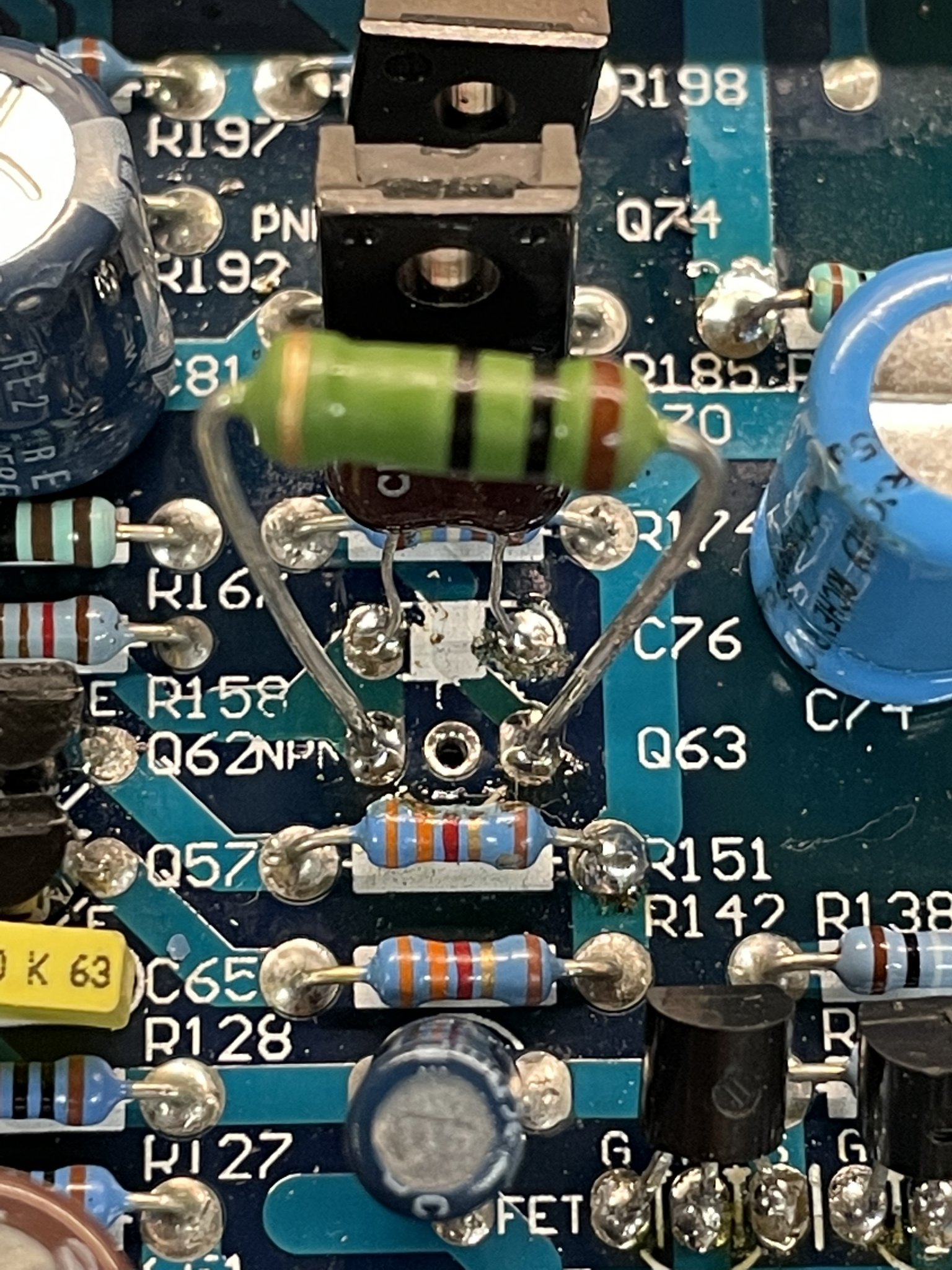

I agree testing only. I put a 10 ohm 1w resistor across B-E pads of Q63, and lo-and-behold the amp is holding unloaded output straight out to massive clipping. Jumping seems to have worked for testing. I am going to perform some high-output load tests to see if anything else pops out... That being said, CH2 now has a very slight turn-on/off pop. Hmmm

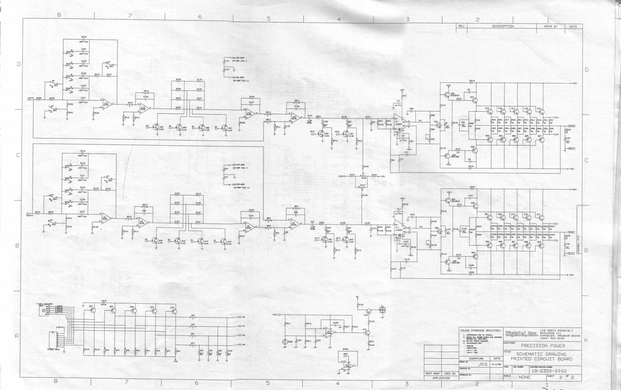

Would you happen to have some sort of schematic which might detail a bit of the muting circuit?

Hey um... Q63 backwards?
On the board/pads,
1: Base
2: Collector
3: Emitter.
Again, the -36v is crossing over B-E.

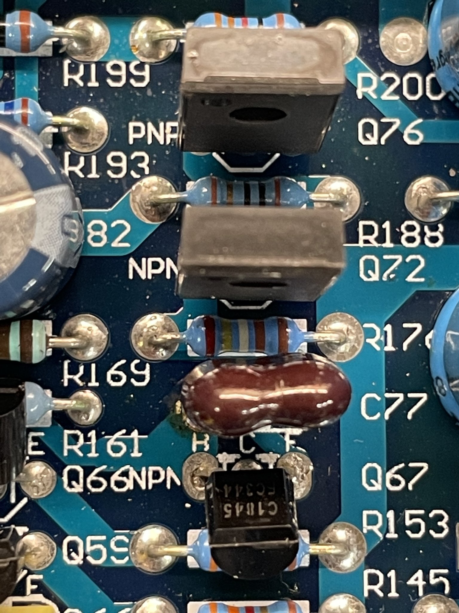

Photos next comparing CH1 and CH2 in this location.

I've attached the PPI diagram that shows the muting transistors.
It's rare that current would intentionally be passed through the base and emitter.
In your amp do you have leg 3 connecting to the brown capacitor in front of it?
Can you read the value of that capacitor?
Yes to your question leg3 to the brown cap. That cap is marked CMD100J. I actually tried swapping CH1's cap with CH2's. That didn't help CH2. I also tried removing that cap completely from CH2, and when I do the amp will not power up; and R186 smokes and the amp draws excessively (About 5A)

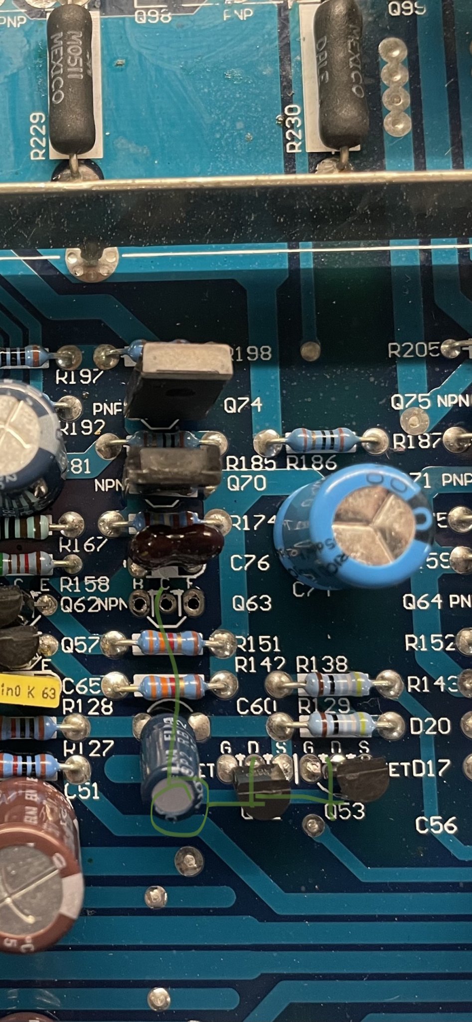

What is the collector connected to?

Q63 collector is connected to secondary/channel ground, which is also connected to the jFet muting circuits' drain. See photos and green line.

The 10ohm resistor across B-E in post #26 photo is a possible solution. Actually I checked all channels and they ALL have a turn on/off pop anyways. Seems to me the muting circuit isn't working anywhere in this amp.
