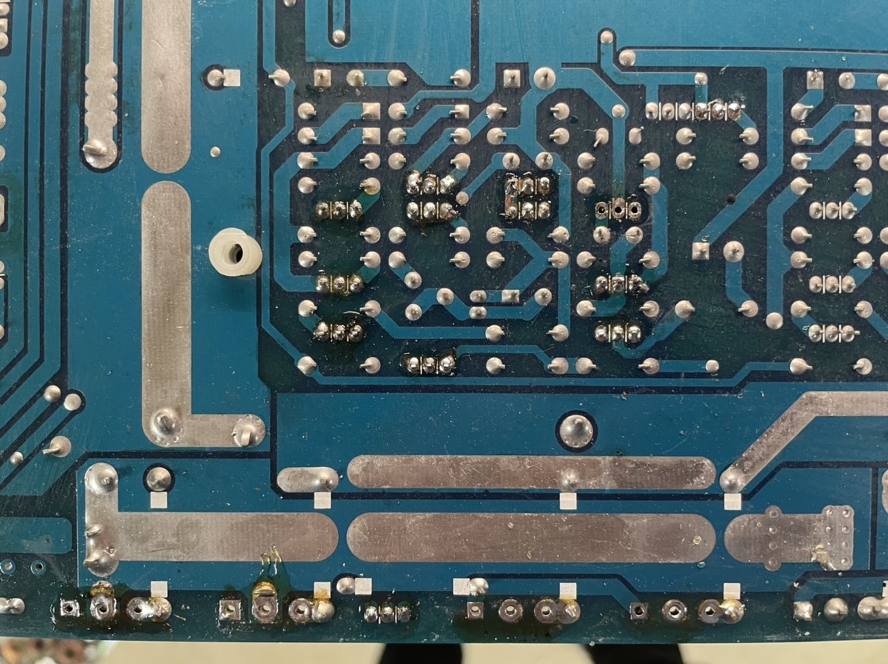

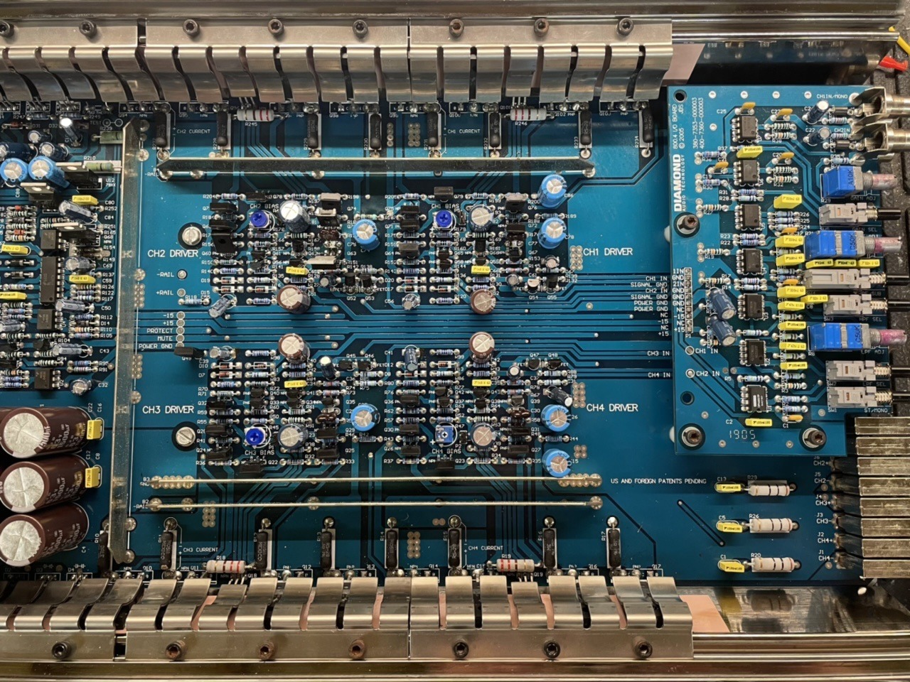

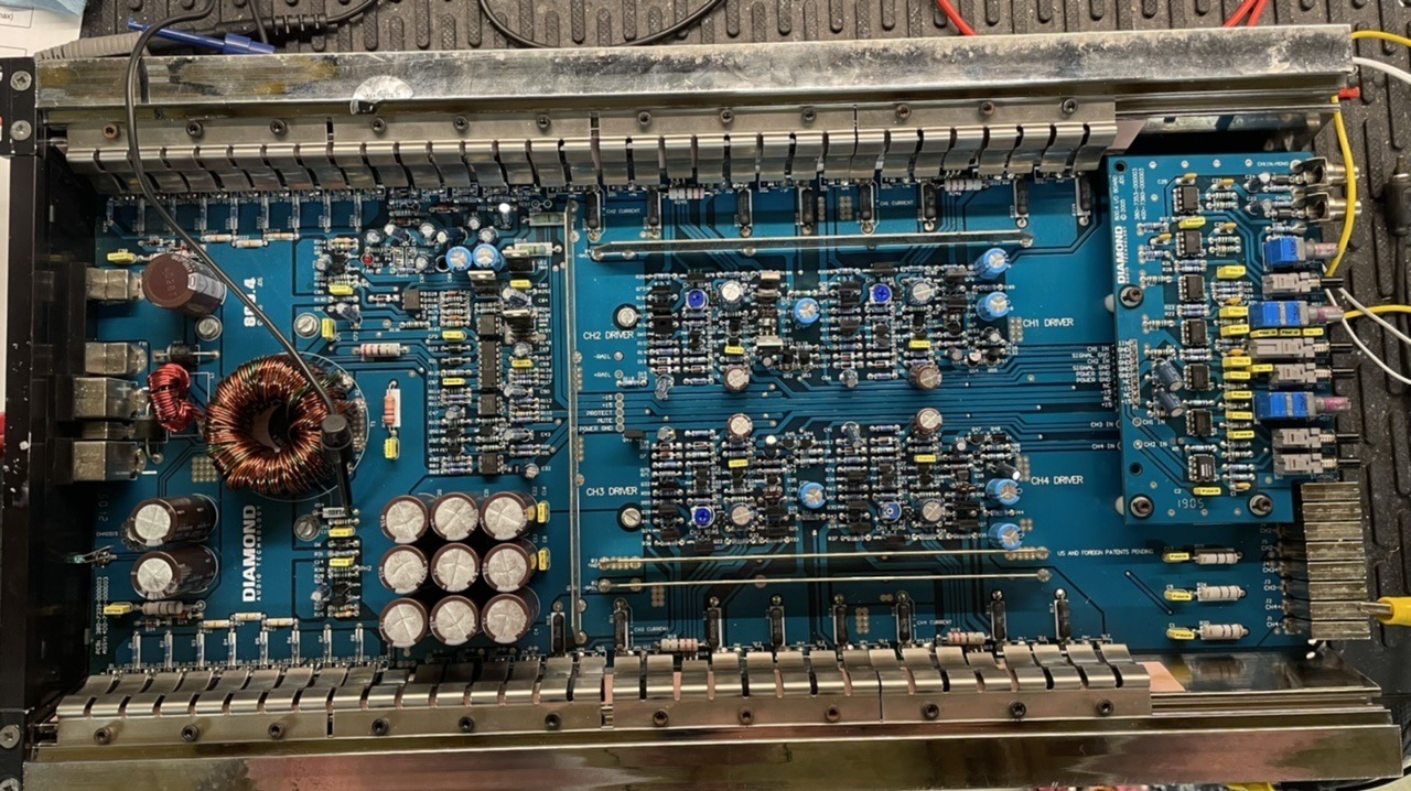

Capacitors will act the same as series resistors. If two of the same value are connected in series and a signal applied across them, they will divide the signal in half at their common terminals. The frequency required will depend on the value so you'll have to use lower frequencies for larger caps.
If you connect the brown cap in series with the 47pf cap, most of the voltage will be across the lower value capacitor (the brown cap if it's actually a 10pf). The attached is an example. Ignore the resistor. It's there to make the simulation run properly.
Thanks for the tip.
I put the weird cap in series with a known 47pF cap, and pushed a 20KHz, 1v sine way across the pair (Red-Black leads). The 47pF cap measued 0.35vAC across it, and the bigger one measured 0.65vAC. So that means the bigger one is smaller than 47pF.
Im thinking its probably a ~500v cap.
