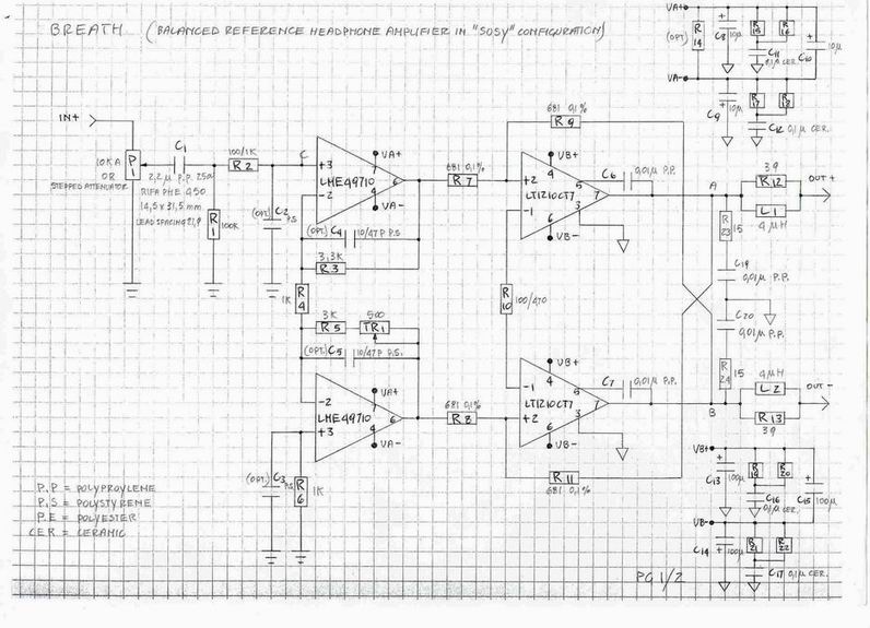

Hallo, Mr. Russ,
Nice circuits!
I'm curious to see the simulations at low loads (25-32 Ohm) and
high frequecies...
I like the output stage solution. You think to plan the possibility for others output chip like the more powerful LT1210 or similar types?
What do You think of my idea for a balanced out headphone amplifier in "SuSy" configuration?
Maybe a contribution for the evolution of Your new circuit?
Regards
semola

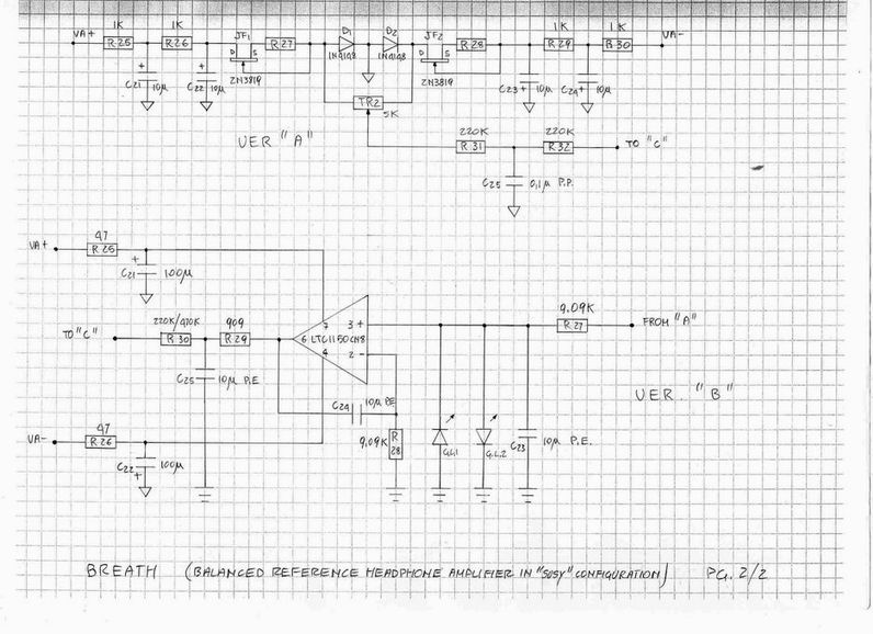

monitoring A and feeding back to C is OK for one side.
Does the cross coupled feedback assure DC servo action for output B?
If not, does the circuit need twin servos?
Hi, Andrew T,
Right questions! This is what I whish to know......
Someone can help to clarify the mistery?
I prefer the "manual" version since is not a feedback circuit but ,it can work properly in this application?
Regards
semola
Regards
semola
