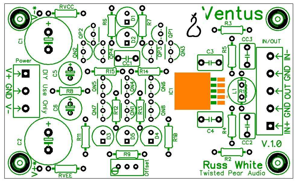

So about a year ago, I started thinking of variations on the Diamante theme.
One thing that struck me was that the diamond buffer was taking up a lot of board space. I looked at the datasheet of the LME49600 and realized it was exactly the same kind of cct I would implement discretely, but much more compact, and it offered built in features I would have to add, such as over current protection etc.
So I designed a new circuit called "Ventus" so that I could play with the front end without having to bother much with the output stage.
In fact I designed the front end so it can be implemented (by advanced users) with either NPN or PNP input pairs.
I also have a version of this cct with THAT devices. But I could not seem to dig it up. No worries, it would be easy enough to remake, but that version would of course not be very flexible. 🙂
Anyway, its a natural progression from the Diamante.
Brian and I are considering producing these for Twisted Pear Audio. Is there any interest?
Attached is the schematic.
Cheers!
Russ
