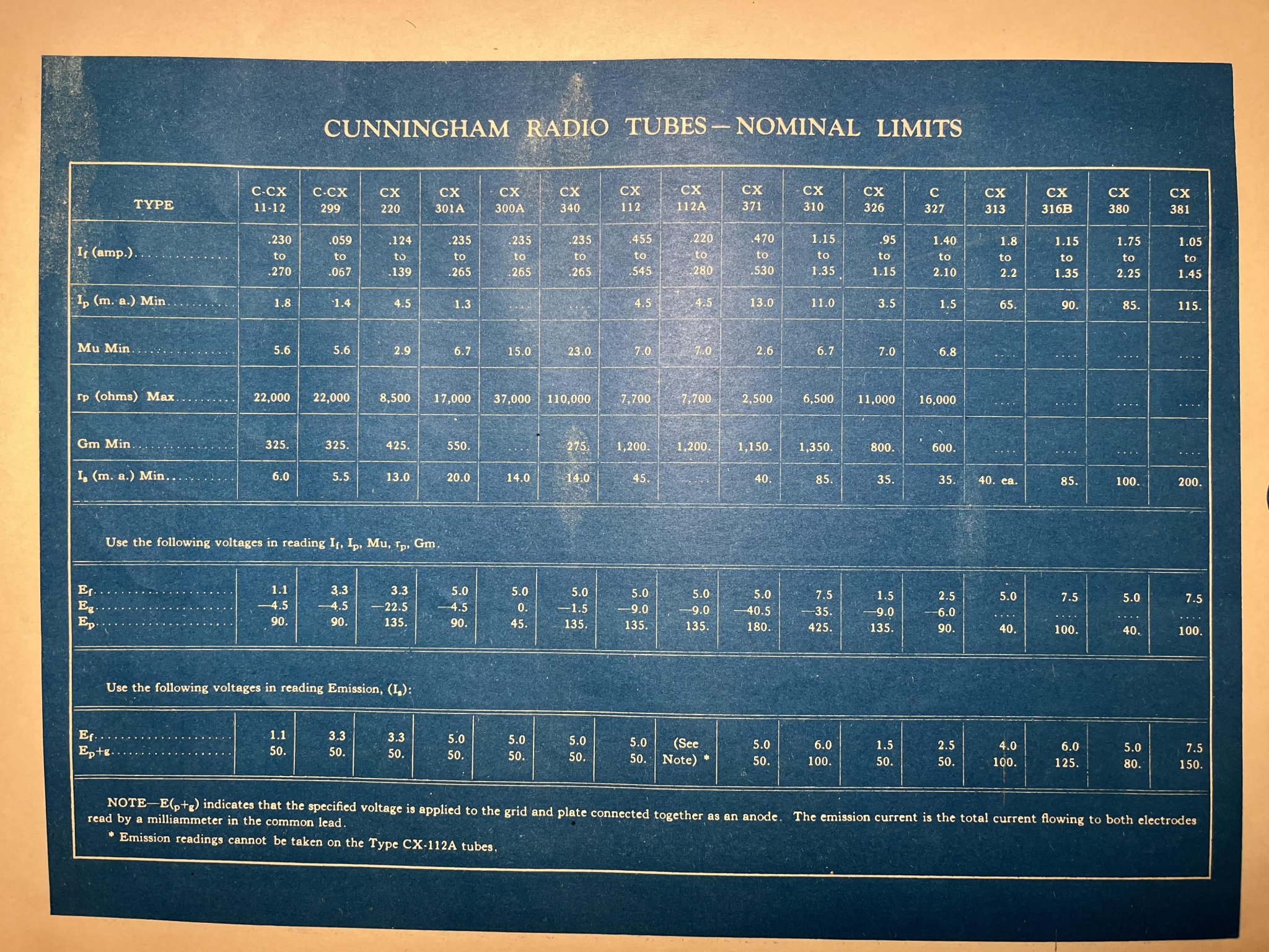

Does anyone have data for the 71 or variants? My understanding is that the 71 came before the 71A and had thoriated tungsten filament.

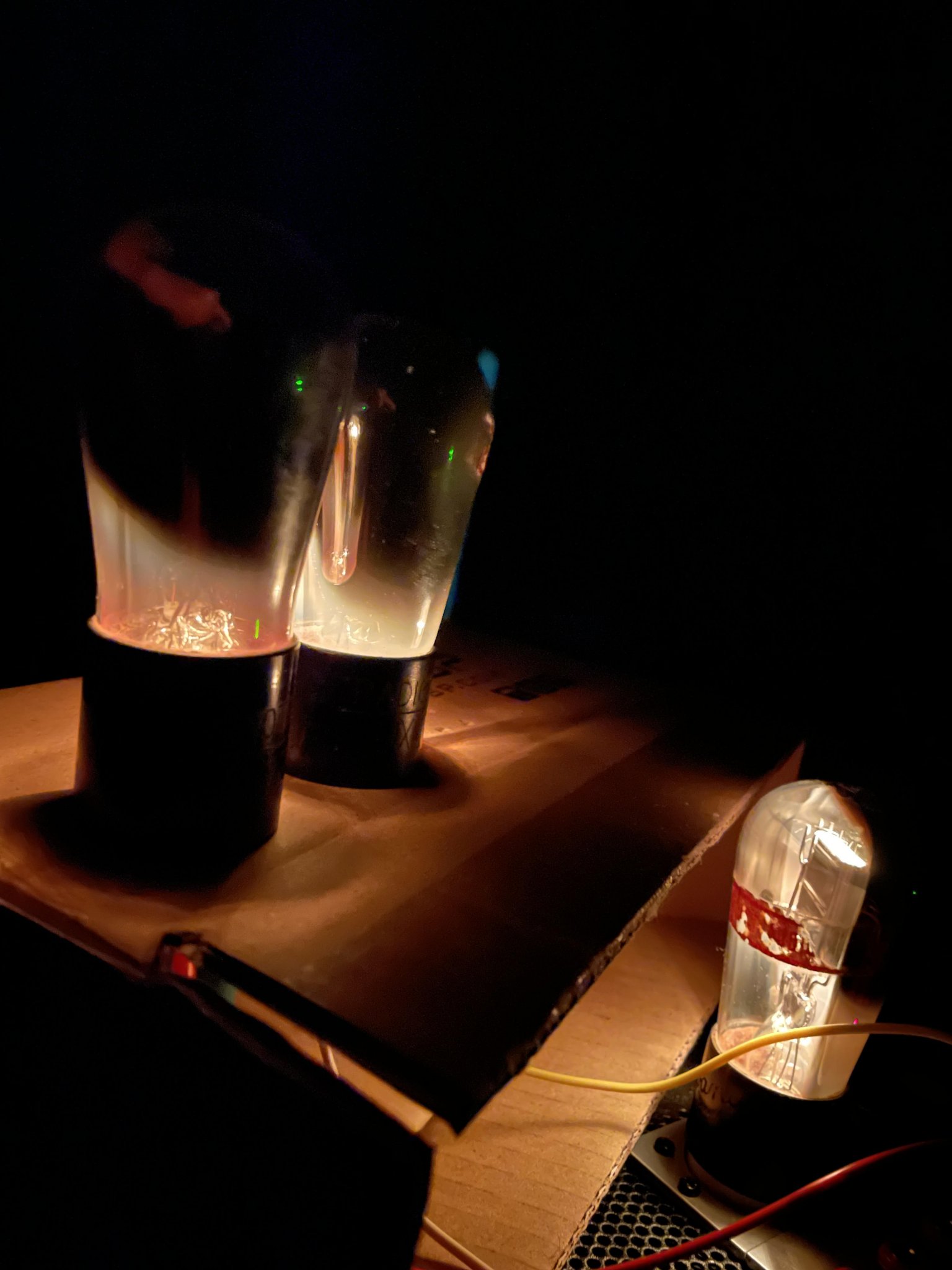

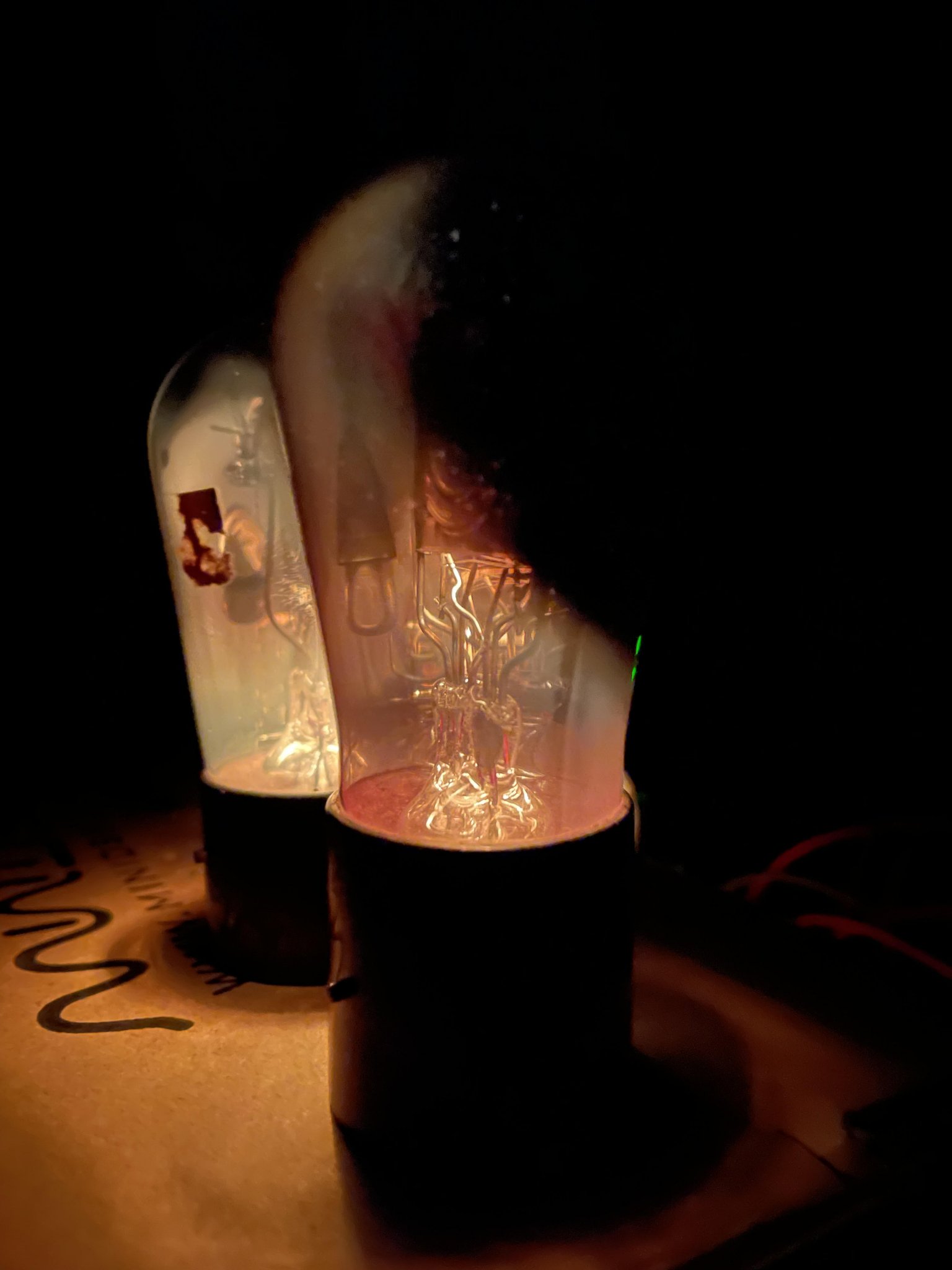

re: UX-171, CX-371 - if they have been offline for a while, run the filament at 5V for 24hrs, all other electrodes disconnected.
No harm, all good - and indeed for the better.

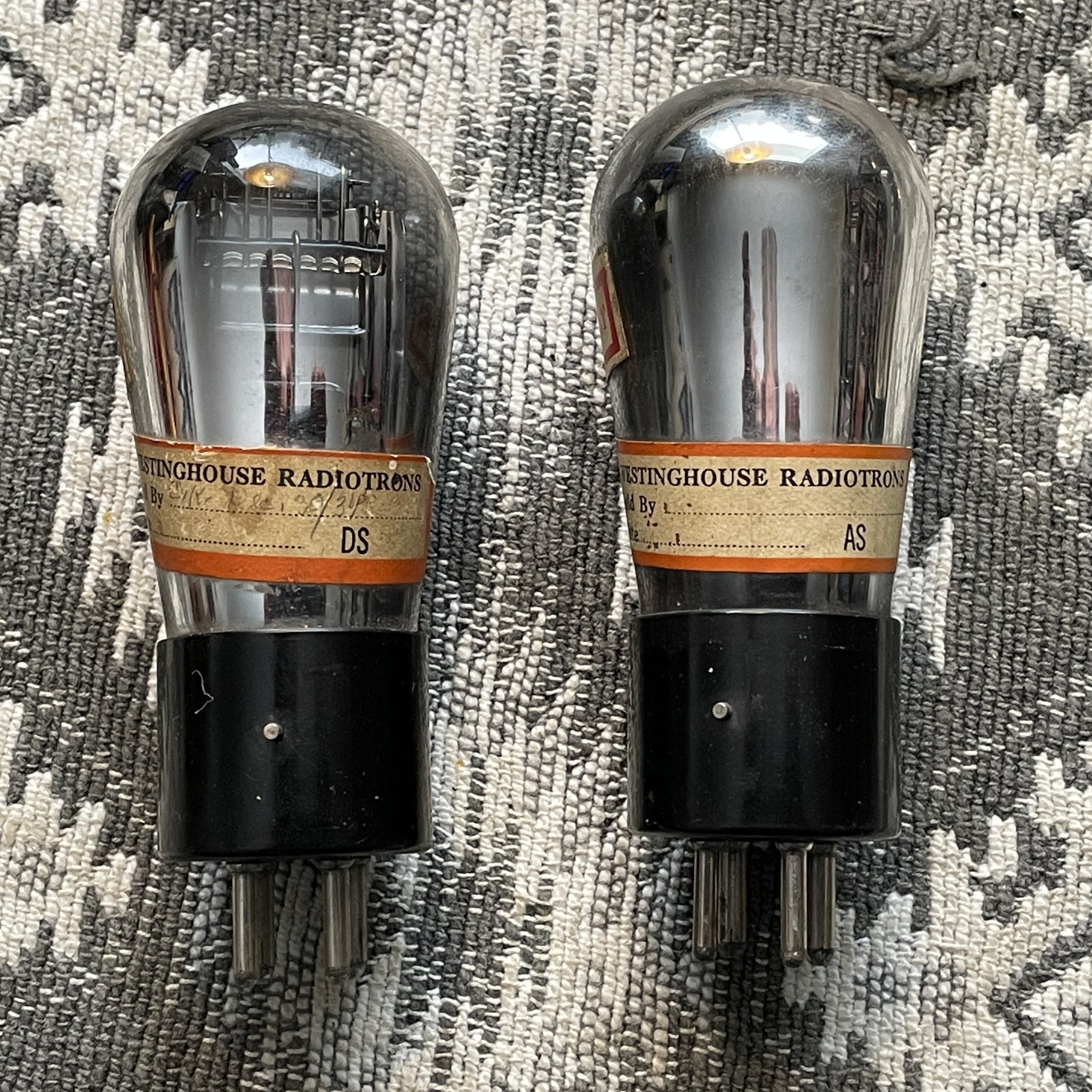

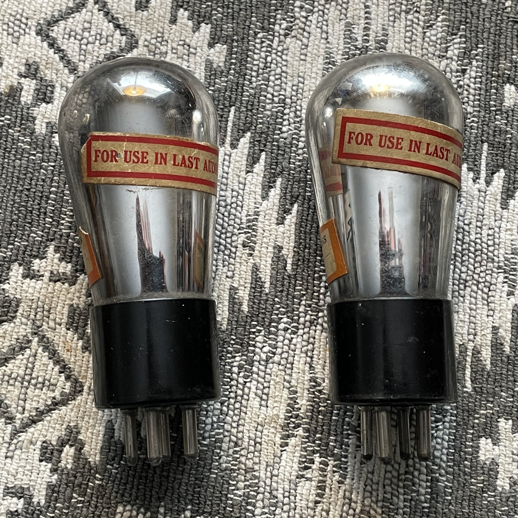

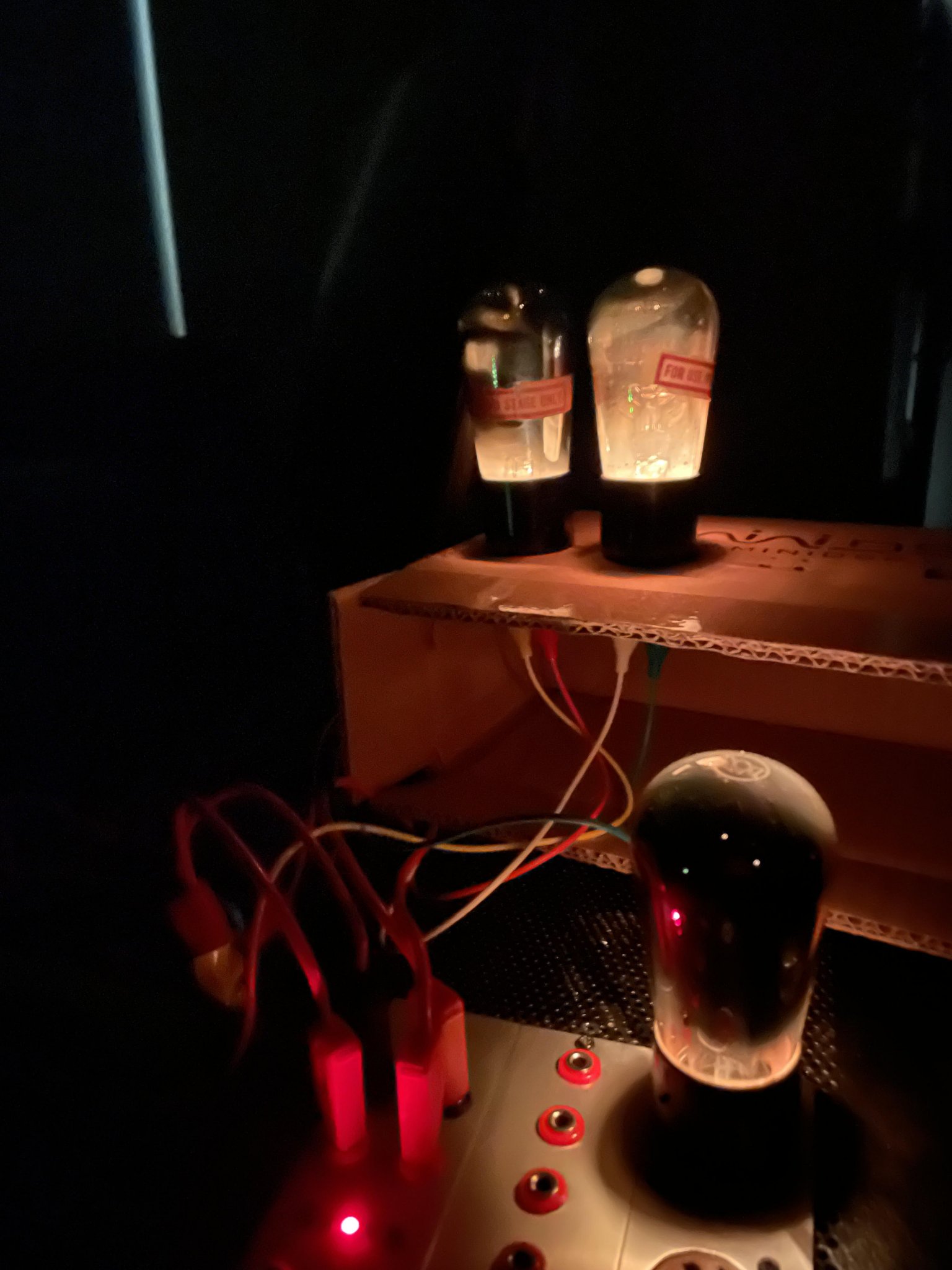

Well I was mistaken, the tubes I have are Westinghouse UX-171-A, and I can only find markings on one but they look identical inside and out. I put them on a 5V supply and both measure 240mA. Not sure of the sonic differences between the A and non A.
Here are a couple of pics. Heading out to the shop to see what else I have stashed away.
Cheers
