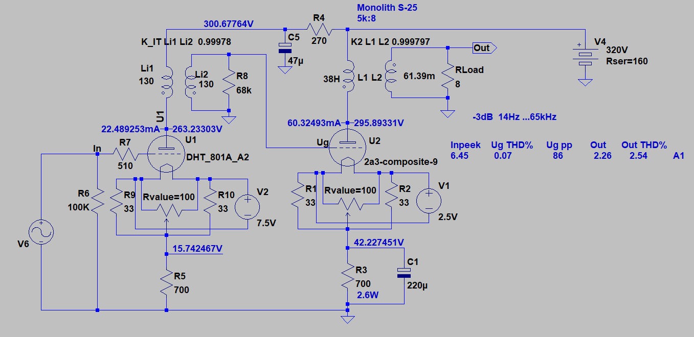

Output tube will clip first, there is sufficient headroom at each stage so I don’t understand what you mean here.The rule of the thumb designing tube power amp: the power tube nearly saturating than any previous stage.
If the x71 tube has -40V bias, the 25V peek input push 300B grid to A1 border (at -75V bias 150Vpp grid swing), and driver tube has enough headroom.
If the VAS stage has 8x gain (even CCS loaded 01a, #26 or 12a never achieve this) it hasn't enough gain to reach 25Vp at 2VRMS (2.828Vp) input.
Use an input transformer if you wish, no problem, whatever you prefer is ok.
I am not looking to drive the output into clipping, instead wanting zero attenuation to the input signal when the amplifier is playing at full output, with some small margin to accommodate different program material levels.

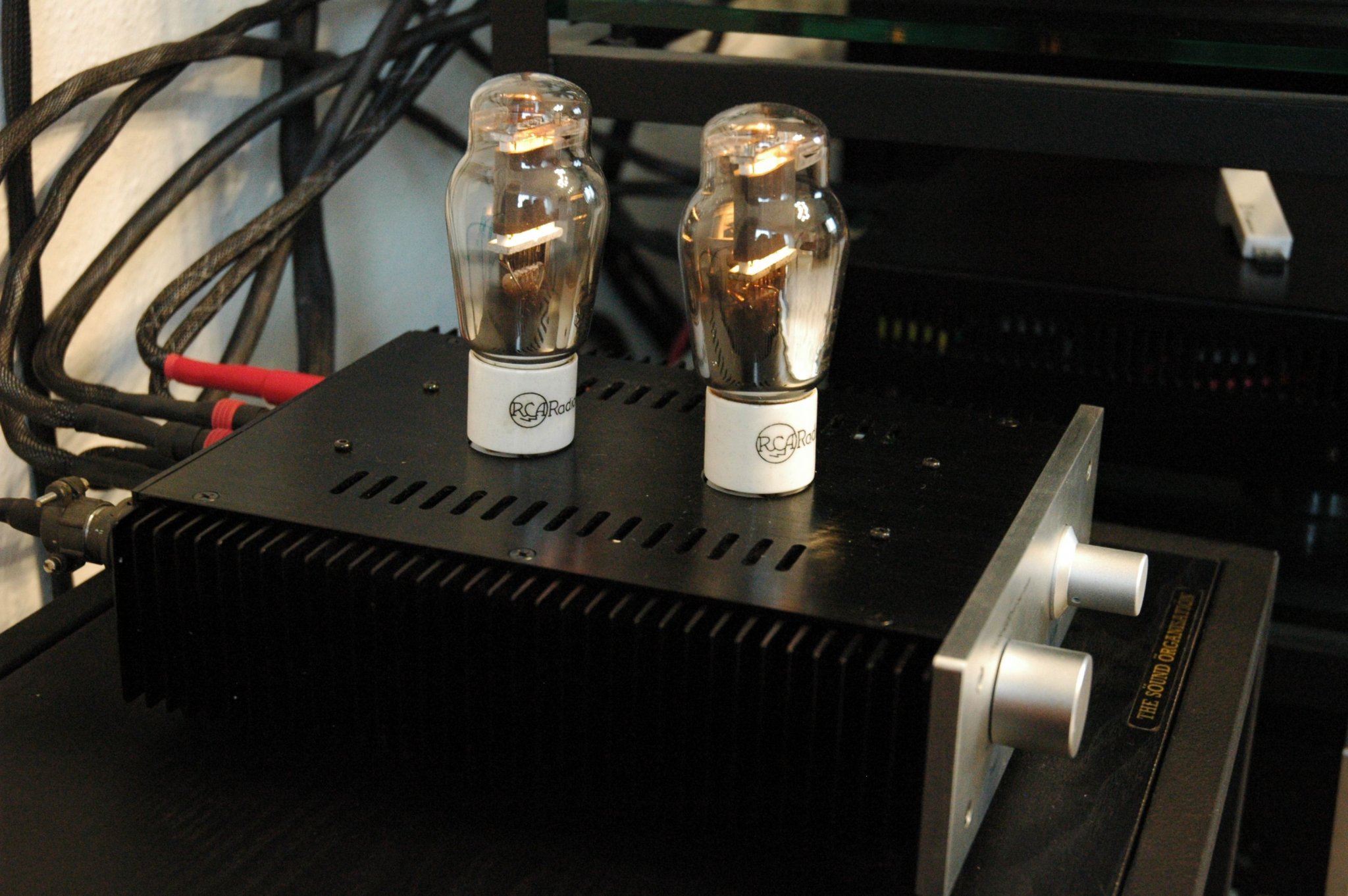

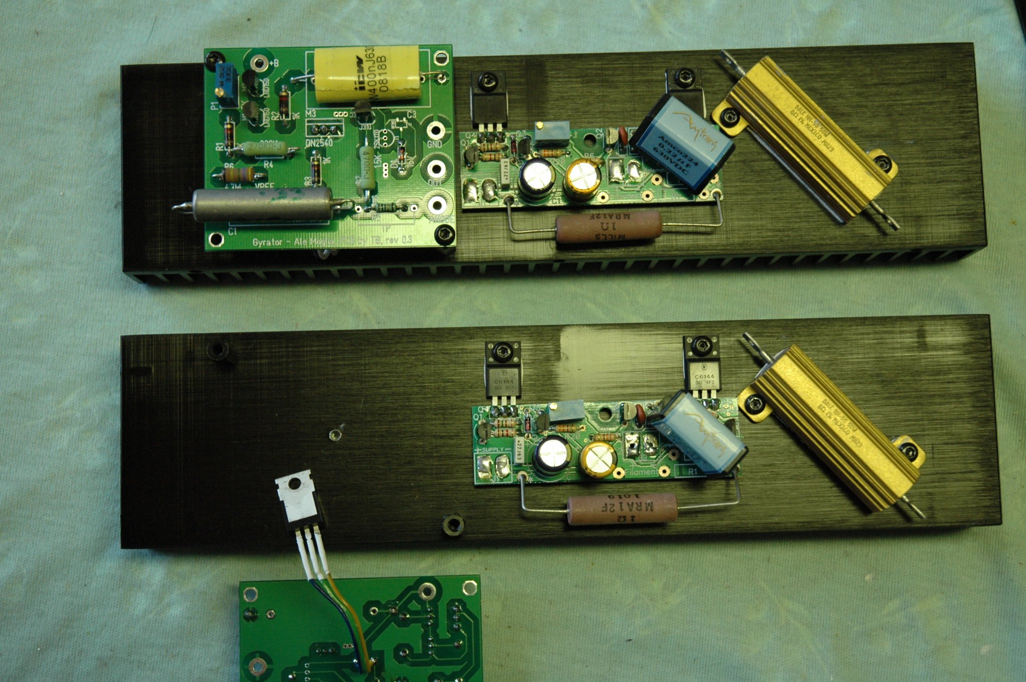

Hi euro21,BTW dissipation problem manageable with appropriate -heatsinked- case.
I usually use -chinese- boxes with side heatsinks.
Samples: my #801 preamp
Dissipating parts: filament bias resistor (8R, 1.25A, 10W) , Rod Coleman regulator (4.3W), Ale's gyrator (1.7W).
After 10 hours the side heatsinks about 40C warm.
View attachment 1120550 View attachment 1120551

Hi euro21,A little bit "overkill" (801a capable more power than 2A3). 🙂
801a (or 10Y), IT, 2A3 SE 5k:8 OPT.
I'm curious...it looks like a 1:1 IT...what is it? Would a 5K:5K work here?
P.S. Do you have an 801A/VT62/10/VT25 preamp schemo that you could show? I remember seeing a photo of your 801A pre in a chassis with big finned heatsinks on the sides, but my searches don't come up with anything.

BTW I have Dave Slagle 145H/25mA 1:1 IT which is enough good for 10Y/801a (18k impedance at 20Hz).
Later (when I have more time than now) I will test it as VAS stage load.
With 1:4 SUT it will have enough gain for about 150-160Vpp output (at 2V RMS input).

Impedance is not the best way to spec out an interstage. Once one has decided the lower frequency limit for the required voltage swing there are 2 more parameters: inductance and anode current. In order to get very low distortion the peak current of the tube should be max 1/2 of the quiescent anode current (good rule of thumb with DHTs). This way the required inductance is automatically determined and it will be just fine for full frequency response except for desperate cases....
Minimum L = Vrms/(4.44*Irms*f) or if one has inductance and DC current can evaluate how much undistorted voltage can get from the TUBE at a certain frequency Vrms=4.44*Irms*f*L.
In the example above with 145H/25 mA, assuming the 801a is running at 25mA, for a peak current swing of 12.5 mA at 20Hz the tube will swing 161V peak (with low distortion) and will run out of current at 322V peak! This is the tube. The real limit will be (very likely) set by the induction in the core.
One can also see that the frequency response will be 1 dB down at about 11Hz despite the 801a has relatively high plate resistance at 5K. It's a great driver tube. No question about that.
