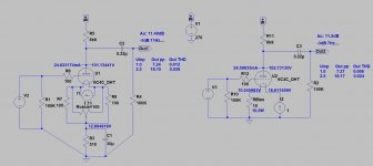

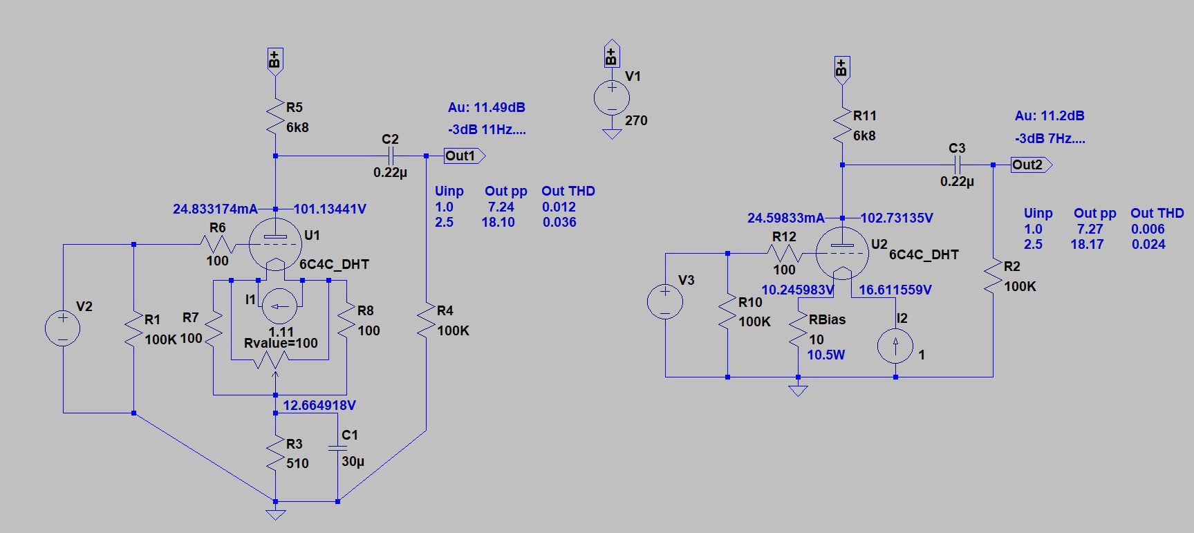

DHT preamp, 2A3 preamp
And there was no clear schematic of the filament-Cathode resistor circuit shown...
Voilá.

Thanks for that Bela - nice analysis as always. Bela shows the circuit analysis but my schematic was also perfectly clear. Filament bias is different - you have to do a lot more calculations but it's worth it for the sound. Quite a lot of people get confused by it, but it's really quite simple once you "get" it.
Yes BUT - Only in this type of the connection of NON-Floating Filament supply.
You right about that, I didn't try that way, and I never will. Because of too high disipation and hard limit in the Anode voltage that is a must with this way. I tried only Floating regulated DC with CCS module. Own design...
This non-floating way limits the design even for lower filament currents, and for higher filament current of DH power tubes, is almost impossible to achieve safely because of high dissipation... 🙁
Still the rest of Your parts of the schematics are not good...

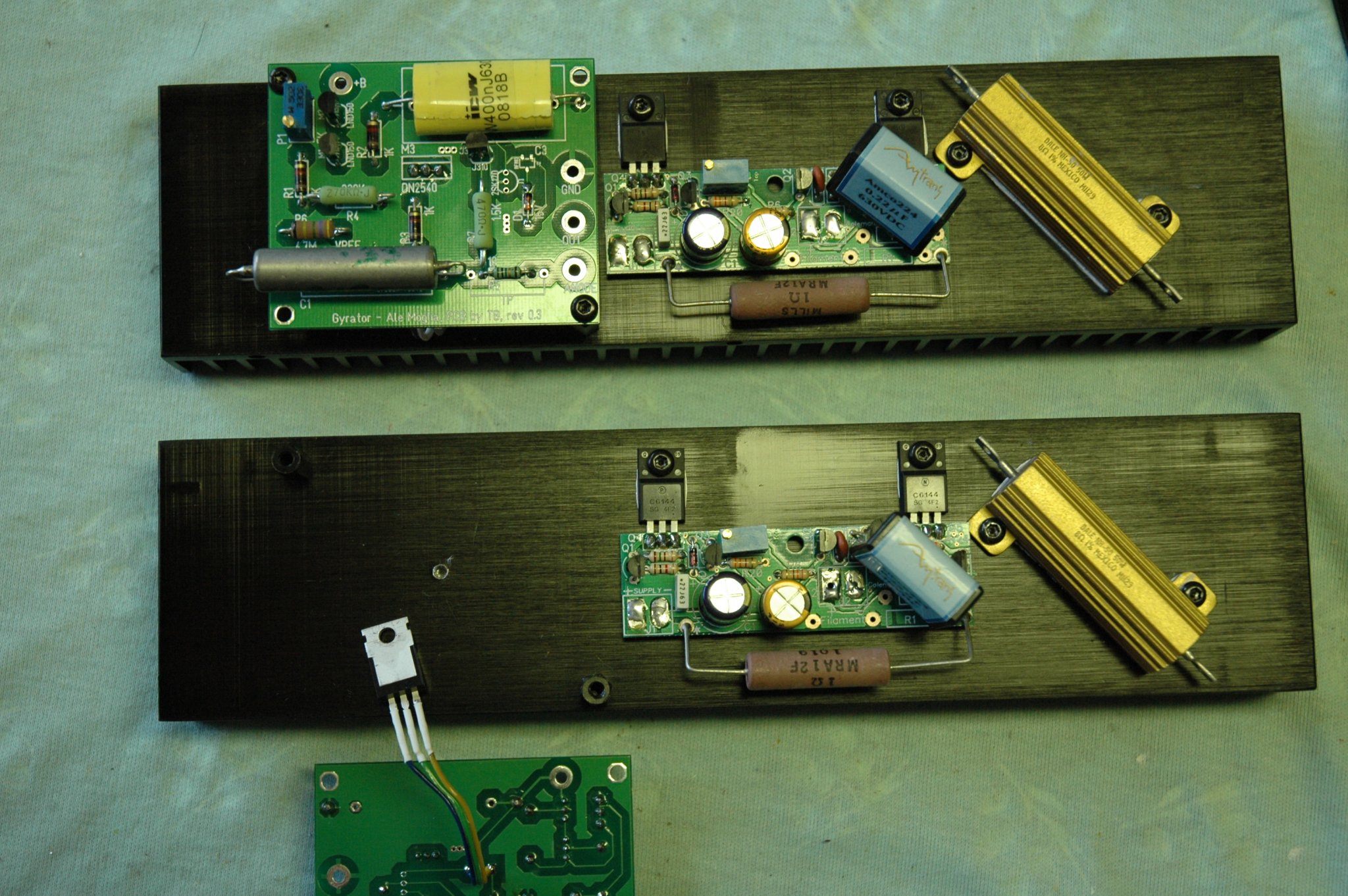

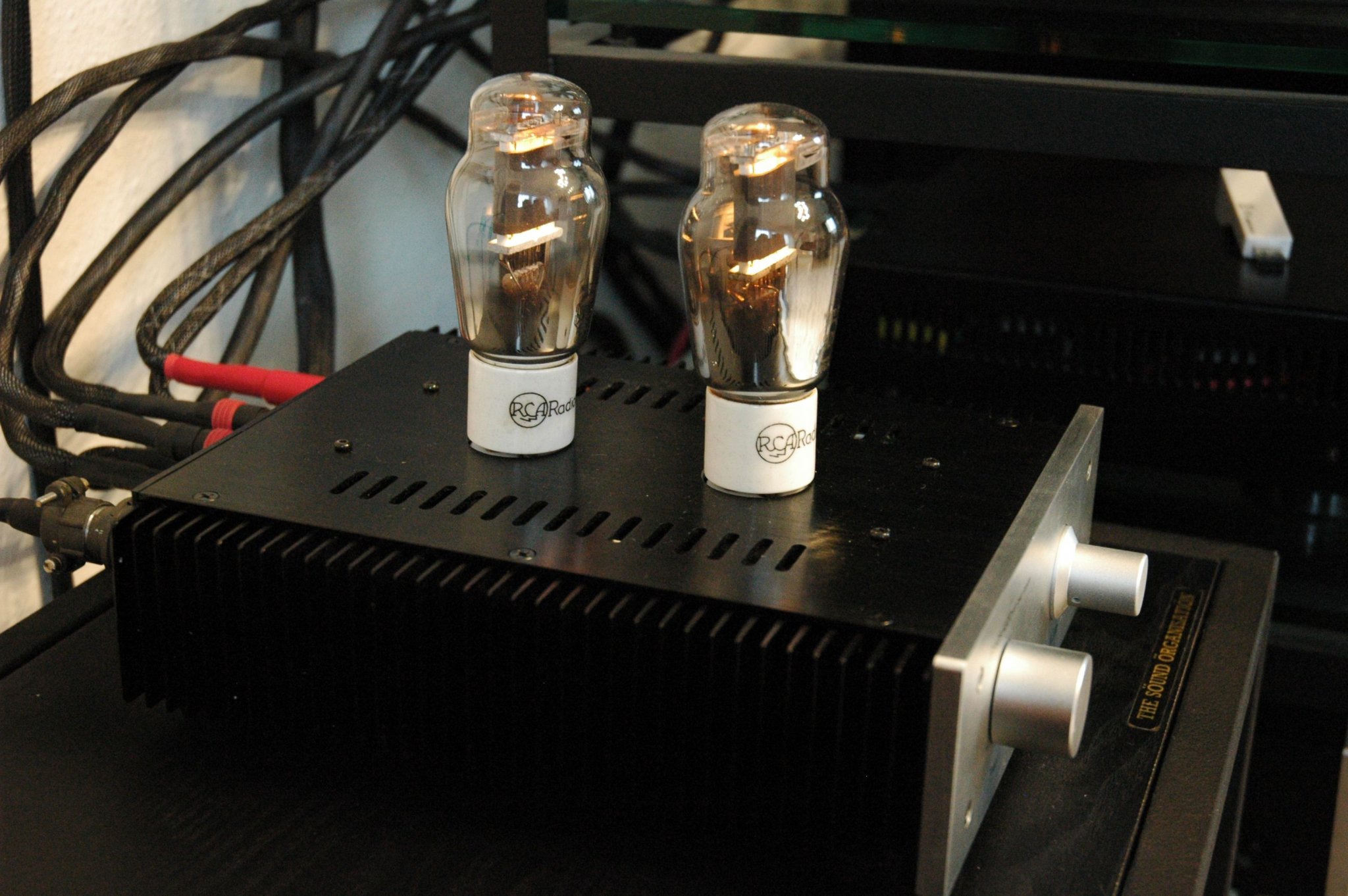

BTW dissipation problem manageable with appropriate -heatsinked- case. I usually use -chinese- boxes with side heatsinks.
Samples: my #801 preamp
Dissipating parts: filament bias resistor (8R, 1.25A, 10W) , Rod Coleman regulator (4.3W), Ale's gyrator (1.7W).
After 10 hours the side heatsinks about 40C warm.
Thanks Bela - that looks very nice. Yes, that's the sensible thing to do - put the heatsinks on the side or on the back. I must try that. It looks better than putting them on top of the chassis. You and Thomas Mayer use aluminium body cathode resistors. I must say I preferred the sound of Russian military resistors. I also have a big stock of Dale wirewound resistors I use. They are very easy to mount on the top of the chassis and sound nice. Not quite as good as the Russian ones, though. Lovely build - very nice!

My take on this latest incarnation ? Change Rk to 25 ohm, change Rl to 6k8 and the increase in B+ will pull the Ia close to 20mA, which IMO is a much better place to be.
But this tube has Rp 2k5 and I'd use a 2A3 with Rp at 1/3, but either are sub optimal choices. On paper that is. But if someone prefers it 'as drawn', then so what, all is fine. But if that someone also listens to a system whose LF is limited to 50Hz, and has a stated HF listening deficiency, and also listens to primarily vocal and acoustic music - I would suggest thus 'master tape type sound' needs to be taken with 500g of salt.

Ref circuit at post #82: shows Vg -22V. My comment was to change Rload to 6k8 and increase bias by just 3V.
I assumed you had built it as drawn and therefore had the 30V filament supply.
Ah - I see. I think I built that one, but it isn't in filament bias so the filament supply was just for the 6.3V filaments with a cathode bypass cap. It was a driver stage for a 2a3, hence the 470K on the output and the small teflon cap. That one sounded very good, which was why I wanted to update it in filament bias which needs a different operating point. I've never used a 35V filament supply!
