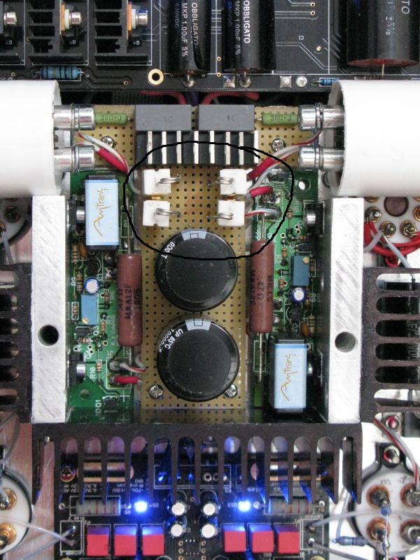

On Morten's Tram2 Rod Coleman power Supply picture, he has two resistors per side for R1 and R2. Does anyone has the ohm values for each resistor and are they in series or parallel. Morten said he is using 0.15 ohm resistor for R1 and R2.
Any thoughts.
Peter
hello Peter,
I assume you mean the R1 and R2 in the raw-dc supply that feeds the regulator (and not R1/2 of the regulator PCB itself).
0.15 sounds OK as a start, but the only thing we care about is to get the dc voltage supplied to the Regulator at about 7.5V-7.7V (measured at the regulator PCB).
You can increase from 0.15, if the voltage is too high (which will burn more heat is the regulator pass transistor) or adjust lower for more voltage.
The resistors can be equal or different values.
Rod,
Thanks for your response. Yes, I am talking about the raw-dc supply. I am after the configuration for these two resistors. On Morten's picture, there are two resistors for R1 and two resistors for R2. What would you recommend using for example: 'say one resistor for R1 at 0.15 ohm at 10 watt'. Thanks
Peter

If you are using the 7.5V winding on the TRAM2, then the values that Morten used should be your starting point, so yes, R1=R2= 0.15 10W wirewound.
When you have built and installed the Regulator and raw dc, please measure the raw dc's voltage at the Regulator PCB, when it is adjusted so that the 2A3 filaments have 2.5V across them. The volage must be 7.5-7.7V on a TRAM. if it is outside this range, reduce R1 to increase voltage, or decrease R1 to get a lower raw dc voltage.
One can't predict the exact value of resistor, because it depends upon the small resistances (parasitics) of the rectifiers, ESR of caps, trafo, wiring.
BUT - it's only with a 2A3 that so much fuss is called for: with 45, or other lower current filaments, the raw dc can be anywhere from 7.0-8.2V
Rod,
Thanks for your info.
On the Regulator PCB, Morten used a 0.47 ohm 2 watt Mills resistor for R1 for his 2A3 tube. I am using 45 tubes. Will this 0.47 ohm resistor be ok for the 45 tube???, or if not what should I use.
Just to clarify on my previous question, I only need to use one 0.15 ohm 10 watt resistor for R1 and the same for R2. I just wondered why Morten has two 0.15 ohm resistors for R1 and the same for R2.
Hello
I can se on the skematic from Rod, that you shall use one 0.68ohm on the regulator
a good idea is to buy some different resistor value for the input to coleman regulator--
i use 0.18 ohm (2 pieces like Morten)--it depent on what is the volt from net ..here by me in Denmark i have 232 v ---maybe you have 240 or 220v
Best Bjarne
Peter, Yes, Bjarne's advice is good. Buy as few cheap 10W ceramic wirewound resistors 0.1 to 0.68, to fine tune the raw dc voltage.
If you want to use a 45 only, and 240V mains, you may need R1=R2=0.47 as a starting point.
Then if you need more voltage, drop one of them to 0.33. For lower voltage, raise one to 0.68 (or just add another 0.1 in series).
If you have it all connected now, what is the raw dc measuring?
