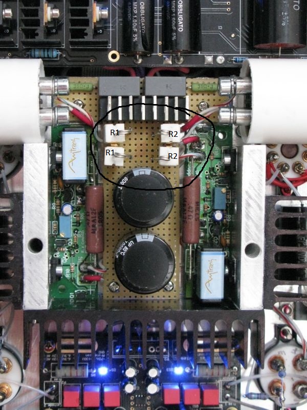

R1 is between C1 and C2 (positive side);
R2 is between C1 and C2 (negative side);

Please have a look at this picture. So to start off, for 0.15 ohm at R1 and 0.15 ohm at R2, I will need 0.30 ohm in parallel for R1 and 0.30 ohm in parallel in R2.
Hi Peter, You can try 0.3 x2 parallel, but I suspect this value has been optimised for 2A3. You may well get higher voltage, when a 45 is installed, (its 1.5A load is lighter than the 2.5A for 2A3). 240V mains may accentuate it further.
Please feel free to try anywhere from 0.15 to 0.47 for each position, but be sure to check the voltage at the Regulator input - must be 7.0-8.2V for 45, 7.5-7.7 nominal for 2A3 - to get optimal performance and minimal heat dissipation.
Peter it is all in Rod's v detailed instructions ;-)
The 2A3 amp used a single 12W Mills per board, but I dont recall the value, and the 45 amp used a single 5W Mills per board, I think this was 0R33 instead of the 2 supplied 0R68 which are in parallel
sjs,
I just looked in Rod Coleman's 'AN_DHT_2A3_V4.pdf' and it details:
The 45 & 46 type is exactly as the 2A3, except R1=0.68R/4W; R2=Not Fitted.
I am a bit confused, as Morten only used 0.68 ohm 12 Watt Mills resistor at R1 for his 2A3 tube. No resistor in the R2 position.
Rod Coleman's circuit for the 2A3 tubes, used for R1 and R2 the value of 0.82 ohms for each resistor.
Can this be clarified by yourself or Rod. Is 0.68 ohm resistor at R1 only for 45 tube and no R2 resistor. For 2A3 tube, use 0.82 ohm resistor in R1 and R2 position??????
Peter
R1 and R2 are in parallel in the board so either 1 at the correct value and high wattage or use 2 at double the value at kower wattage. I cant confirm the values as I dont have the amps any more.
So from what you have said about Rods instructions, 45 uses a single 5W 0R68, 2A3 use 2 x 5W 0R82 in parallel or 1 x 0R4 12W ??
