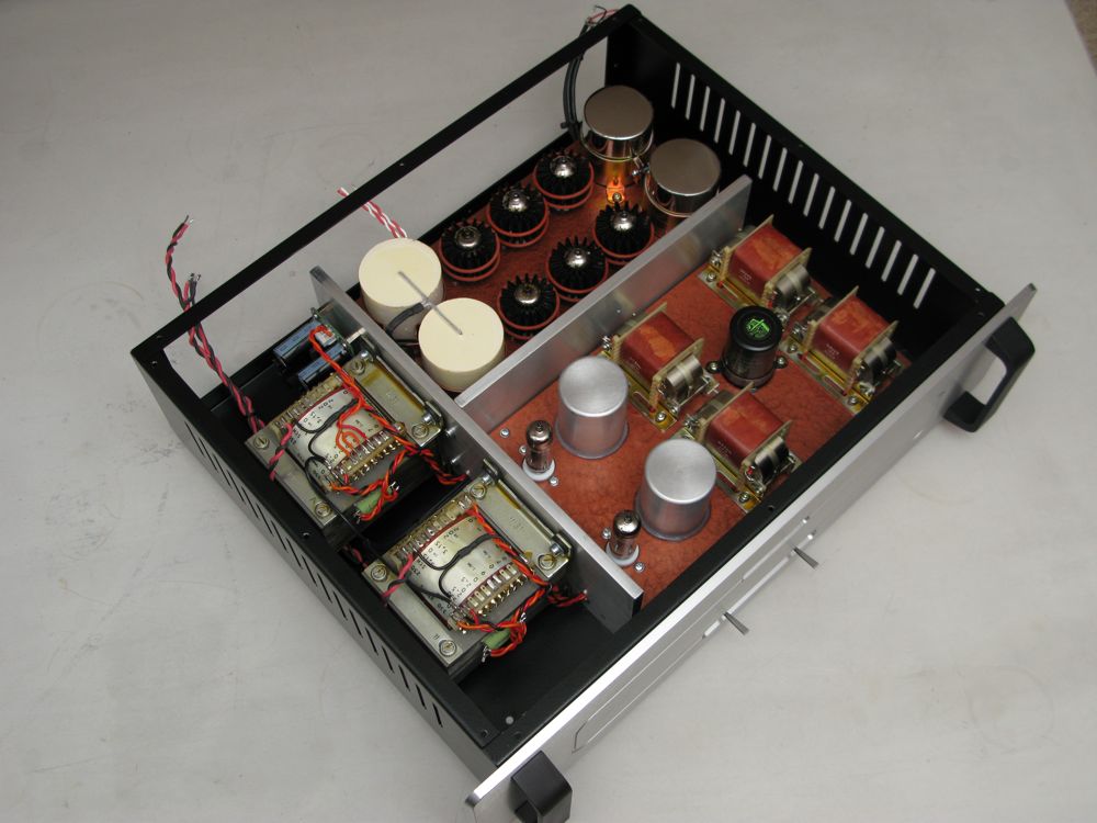

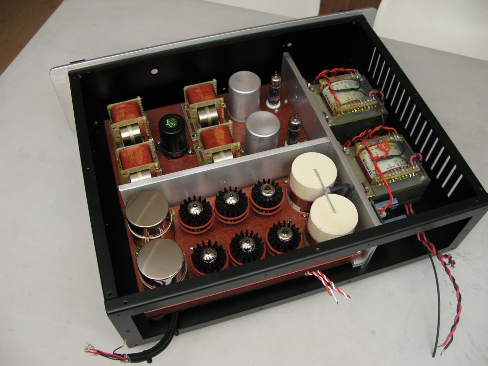

Also I was asked to post a picture of my Coleman regulator installation, so here it is:
Apart from my cat sticking his nose in at the left, you might notice there are small fans mounted to the heatsinks at either end of the copper bar. I have not heard any fan noise, but at least when i had the Tram2 open, it was not hot enough to start them running after about an hour.
You might also notice the paralleled Obbligato output caps (thanks Morten!), and Duelund Alexander input caps. The resistors in the signal path have been replaced with Shinkoh tantalums.

Drifting anode voltage is a pain with the CCS as they are designed / delivered (bad design around the trimmers), that's why I installed the fixed resistors. I recommend to do something about this (might also cure the noise you have in one channel). Remember to let the Tram II warm up for around half an hour before adjusting the voltage. And then check and re-adjust around 15 minutes after your first adjustment. Keep repeating this until you see no change in voltage.
Cool (in more than one way) integration of the small fans at the heatsinks..! 😎 And I see that you're Tram II is getting to peak-fitness-condition (name of a song from a Danish band, also works here). Nice implementation... Have you made the layout and circuit board for the raw supply yourself? Or did you find a suitable circuit board online somewhere?
My only small concern is the -relatively- long wires from the rectifiers to the first cap (I assume the Kemet / Rifa's are the first caps like in my implementation) on the raw supply for the Rod Coleman regulators. You have high peak currents running in those wires so they can radiate some noise. You could screen those and connect the screens to chassis ground.
The supply board was made (and installed) by Lucas Cant, aka Black Art Audio here in Melbourne.

Issue, or no issue... Those wires do radiate noise, since they carry high pulse current, and noise does not always show up as ''noise'', I mean noise you end up hearing through the speakers. It can show up as smearing of the sound....
Those wires are the most critical ones in the preamp to keep short. When they are a bit longer like here the simple solution is to twist them really tight, then the ''ground'' act as a simple shield. Or they could be both twisted and shielded, with a ground connected to chassis. Good thing in your installation is, that the wires are at a distance from the circuit.
I'm not saying that it will make a sonic difference, because I don't know how sensitive the Tram II circuit is to radiated noise. What I'm saying is, that I would twist/shield.
